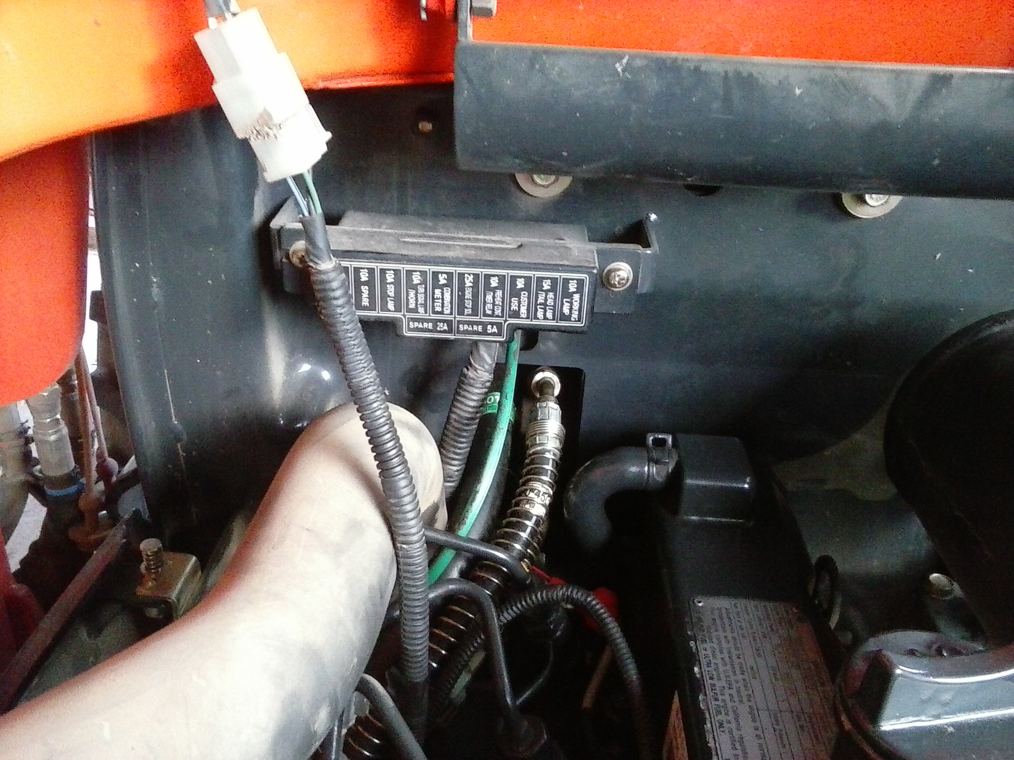

I have a leak that is coming from one of the hydraulic steering lines (Kioti CK20HST). Leak is right next to or inside (i.e. on instrument panel side) the firewall where lines go into the steering box. There are 4 lines that go into the box from the engine compartment; they are in a tight configuration and there are other electrical harnesses, pipes, etc. that made it impossible for me to access the line connectors in 1.5 hours of cleaning/troubleshooting (but I'm open to suggestion).
I do not know if it is simply a connection that needs tightening, or if one of the hoses is bad and needs replacing. Leak just showed up I've only found it due to the hydro fluid mixing with dust to make a mess inside the engine compartment in that area. So, how do I best access those connections?

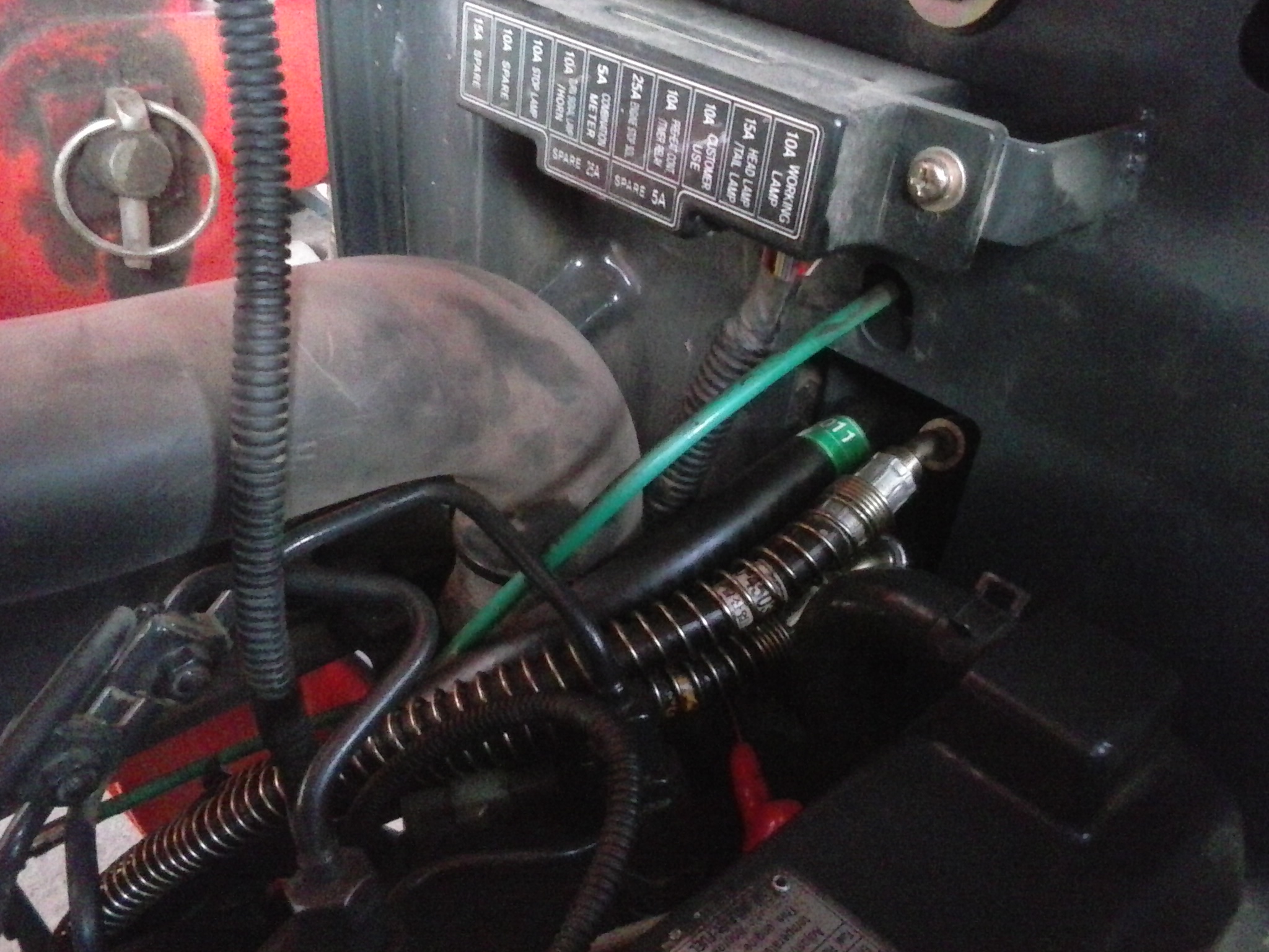

OK, here's a couple photos from the engine compartment.
Four hoses go into that rectangular hole in the firewall, just under the fuse block. The leaking hose is likely one of the bottom two (it is NOT the clearest one you see, on upper right - that hose is clean and dry). Most of the surrounding hoses or other items will not move easily (no slack or very stiff), and even if they did, the connections are well inside that firewall hole (several inches; the ones on the left are even farther in than the ones on the right).

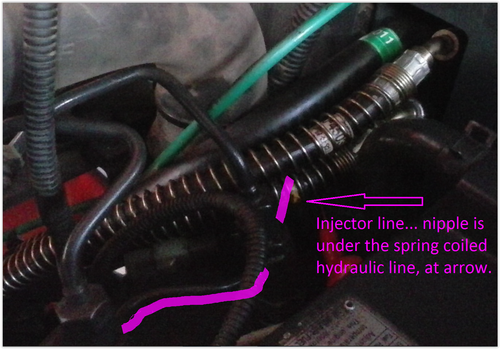

OK, I thought I'd put the resolution here for anyone else who has a CK20. It turns out that it was a diesel fuel leak, not a hydraulic line leak. It got worse, and I could smell the diesel. So here are the key points:
- There is a "return fuel line" right under those 4 hydraulic steering hoses... very tight space.
- That line is connected (under those hoses) to a nipple at the end of the series of injectors (I'll post a marked up photo to illustrate).
- On the CK20, that line always has fuel flowing in it, back to the fuel tank (I just learned that this is not an uncommon strategy, and warms fuel for easier operation).
- That line has a small cheap wire clamp on it. It is a low pressure line, but if it gets a leak or gets disconnected, you'll have fuel flowing out while the tractor runs.

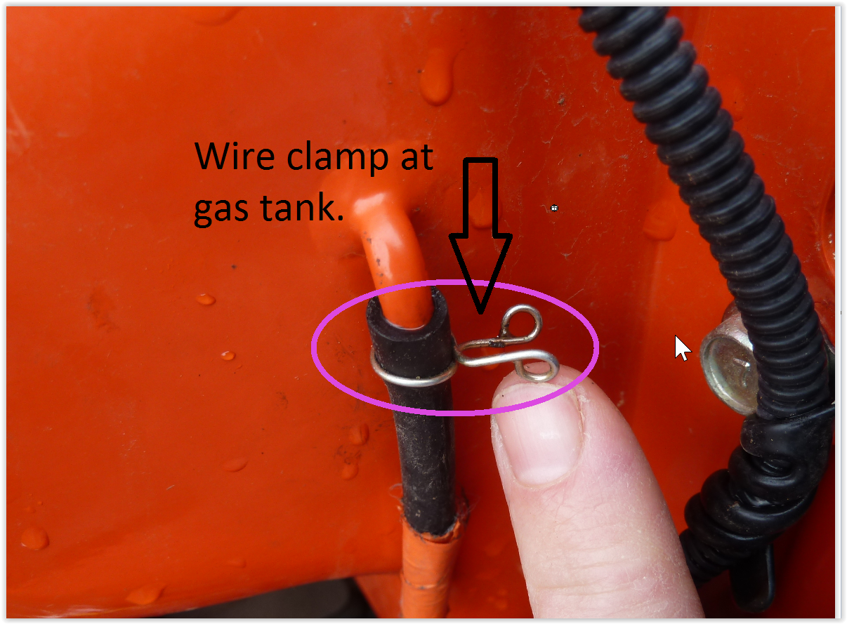

You can see an example of the clamp at the other end of that line, connected at the fuel tank in a photo I'll post; each end is connected the same way. Well, two of the four hydraulic lines have spring coiled around them, and this rests on top of the fuel return line. I'm not sure which thing caused it, but over time, the leak developed right where the return line connects to the nipple under those hydraulic hoses. You'll see in the photo I'll post shortly that both the coils and wire clamp bit into the hose; I have not determined which one caused the leak, but it was leaking regularly... drip, drip, drip...

  • First, what the other end of the fuel return line looks like at gas tank; it's the same small hose and clamp at the engine.
  • Second, a picture of the leaking end of line, showing the bites by the clamp and the spring coils (the other piece of rubber line is a "plug" I made to cover the nipple to keep fuel from flowing out while I cut and rerouted the return line; rerouted to get some slack ... there was none.)
  • Third, detail from one of my previous photos, showing the location of the nipple/leak under the spring-coiled hydraulic hoses.
