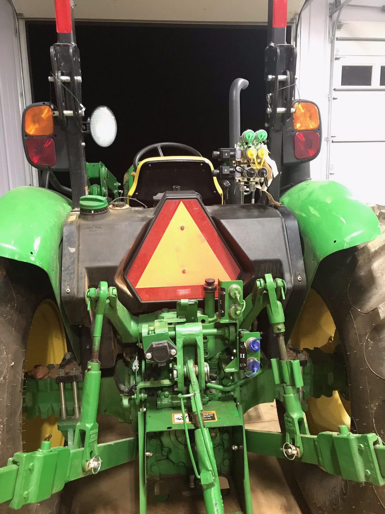

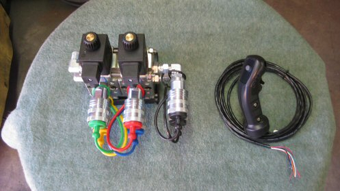

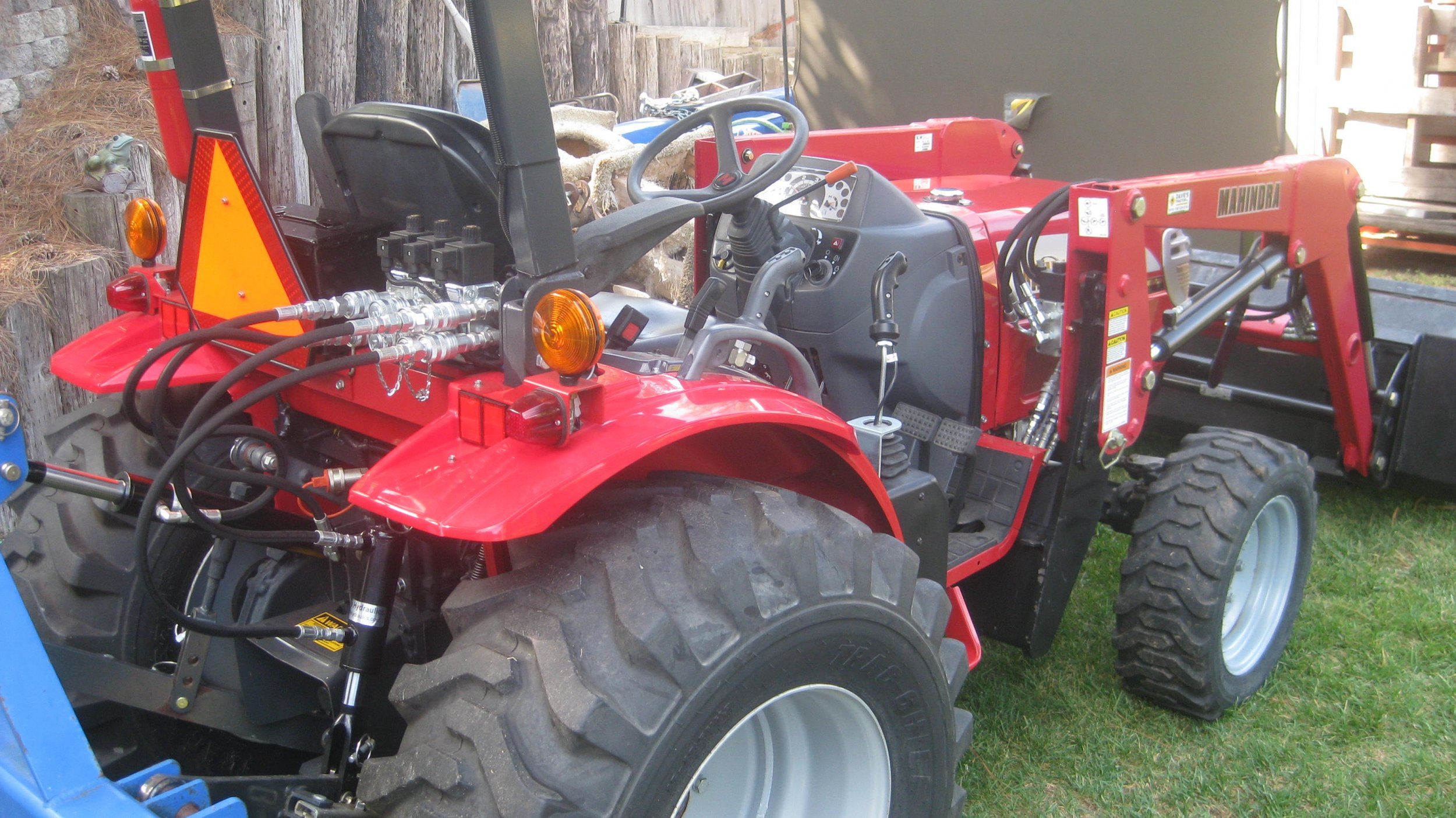

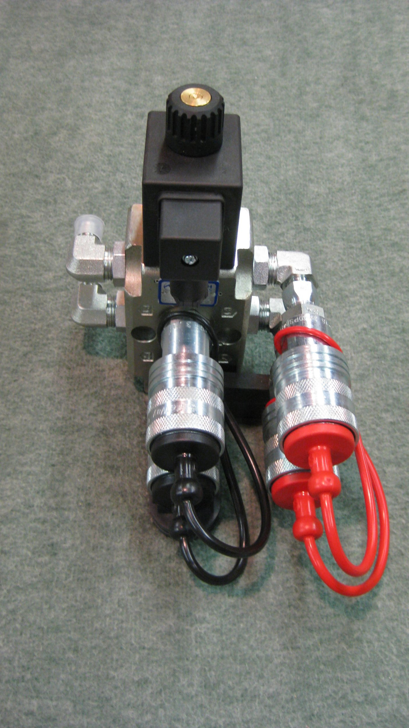

How about using cast iron Bosch diverters? Something like what is pictured with a control grip on your existing control lever. All of your controls are on your existing control lever, no moving your hand back and forth to actuate separately mounted switches.
The JD has a double diverter setup and the red tractor has a triple diverter setup. The gray control grip is on the single rear remote lever for the 3 diverters.
A single, double & triple pictured separately.

Besides the diverters you can also add a set of non-factory remotes. You'll have to do some fab work to make simple brackets and get some hoses made. There are a number of threads on here detailing how people have done theirs.

That is nice, I will have to look into those as well.
