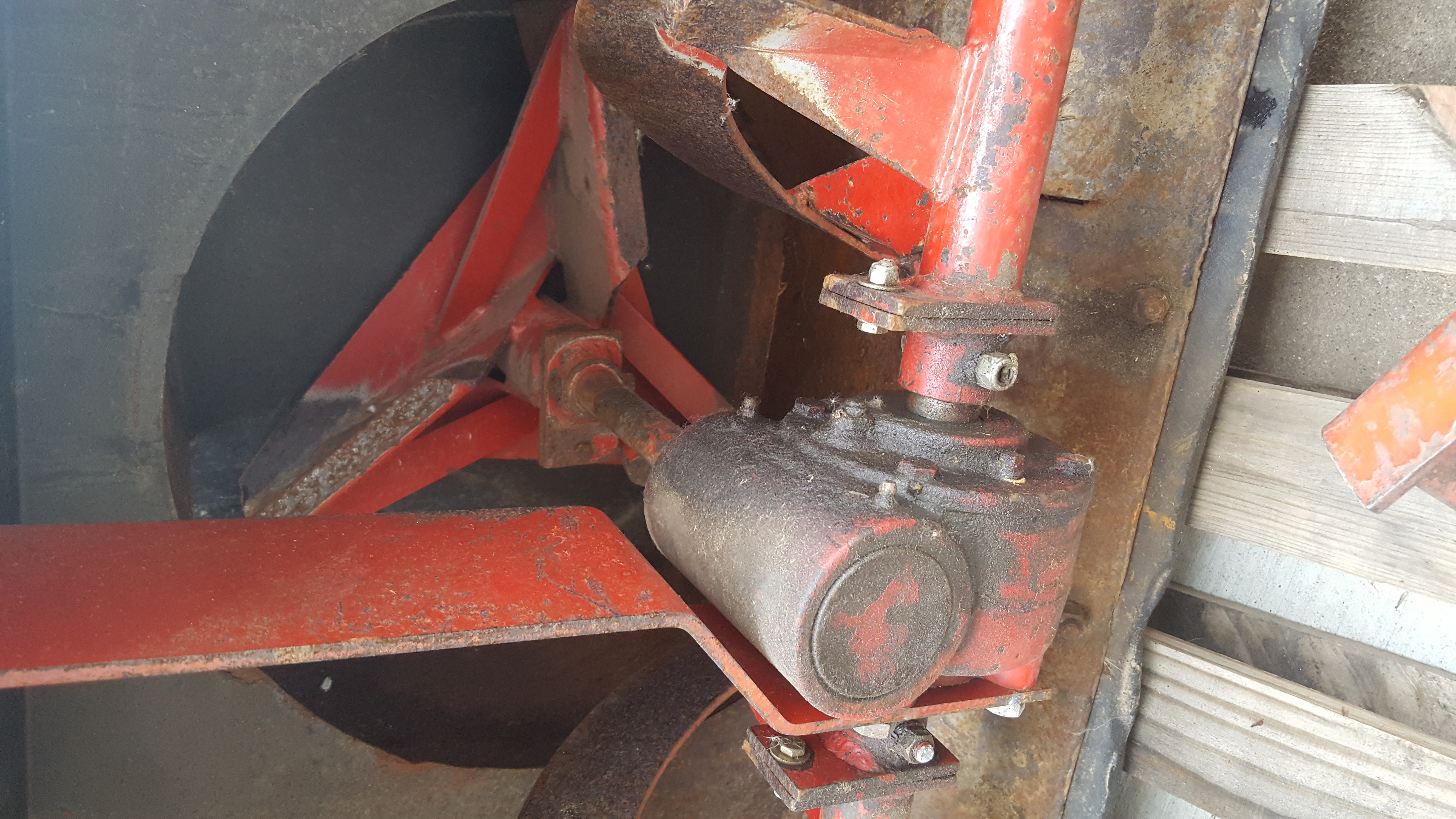

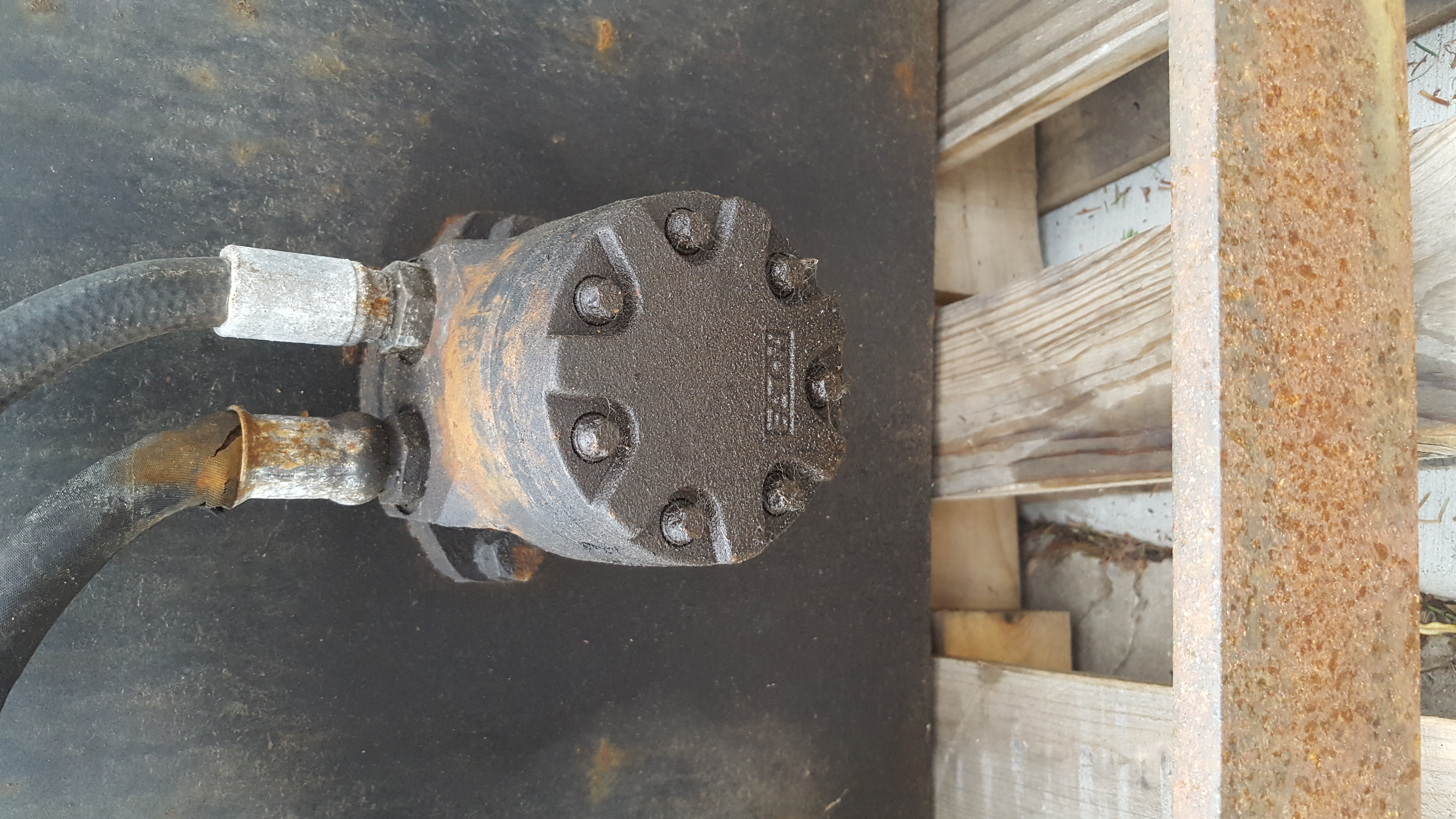

I picked up a Hanson General Products 62.5" skidsteer snowblower at the auction and I cant find much info about it. I have a Massey Ferguson 1734e (27hp at pto)& I'm looking to get a pto pump & resevoir to run it. I was able to find info on the hydraulic motor that runs the fan/gear box/auger, it is a 3.6 cu in Char-Lynn: 2000 psi, 15gpm, 962rpm. So, does this mean I can run a 7.62cu in 16.6gpm (540rpm) hydraulic pto pump, with a 15 gal resevoir and have enough power to throw snow 30-40'? 20190703_093516.jpg

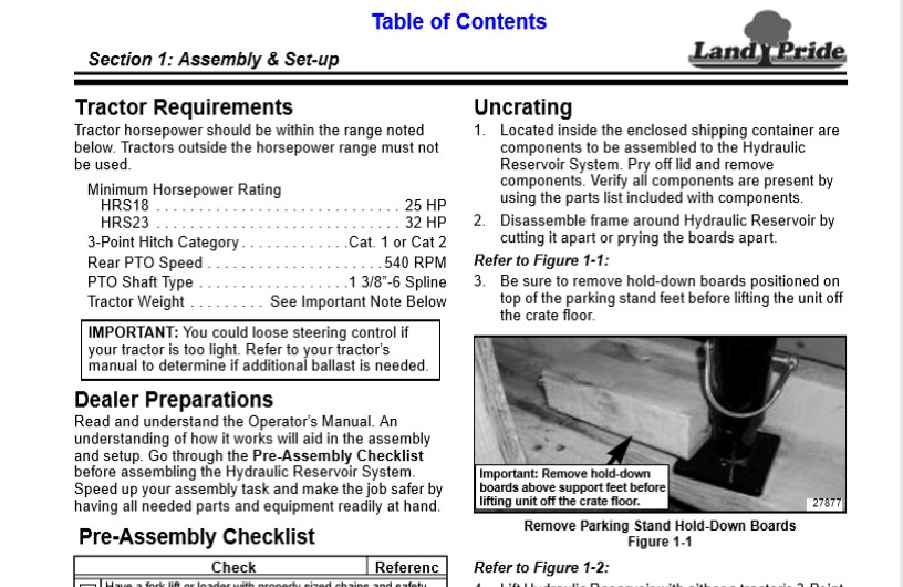

Landpride also made the HRS18, which only requires 28hp to make 17gpm @ 540rpm (not sure of psi, but I only need 2000), If I could find a used one cheap enough, I would just buy one of these power packs, but I can build one (with a smaller res.-20gal & no cooler) cheaper. I just want to make sure, before spending the time and money, that will be enough to run the equipment I have (specs in the 1st post)

The same calculation results. 15/17*28HP=25 HP or much more than you have.
Better to sell the blower designed for a skid steer to someone with a skid steer.

Char-Lynn usually have a chart in there data sheets showing actual flow vs RPM & also torque vs pressure.
If you can find that chart it will provide more accurate information on the motor performance. Flow vs RPM you have listed is at 100% volumetric efficiency.
Depending on the design you can build yourself a less expensive system that will work. The unknown is how well it will works. Type of snow is a big factor on how well a blower works.
For reference a very good hydraulic drive is only 80 - 85% efficient under load.
Suspect you will need to size the pump for 17 - 18 GPM or possibly more to maintain hydraulic motor speed under load
