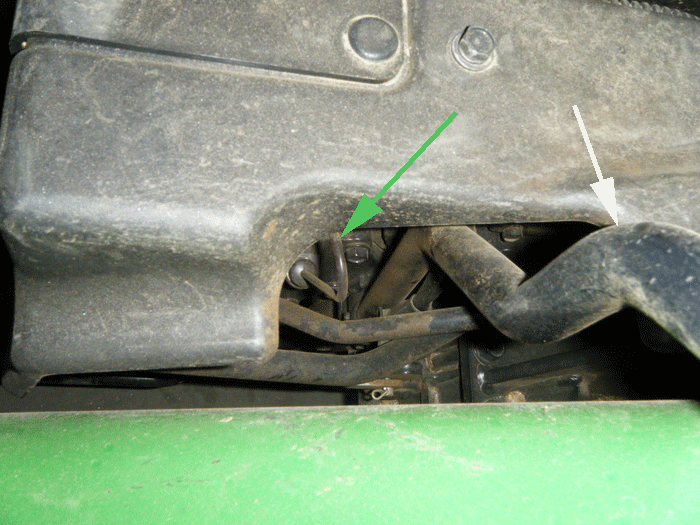

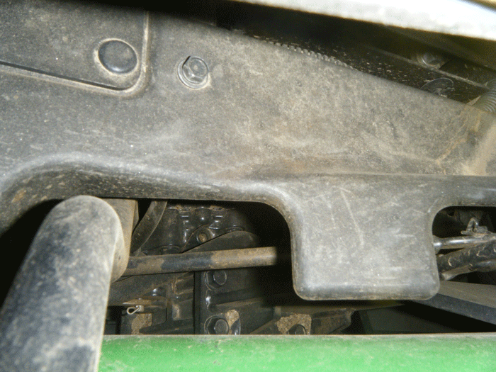

Ok took a couple of photos. The first is looking down alongside the low/neutral/high transmission lever in the low position. Can't see anything no wonder people including me could not find that little devil.
Second photo place shift lever in the high position, and look again (green arrrow poing at the dip stick. White arrow is the transmission lever in high).
You will need skinny hands to reach the stick handle to pull it up. I have a small plastic hook. Then make sure you reseat it good to keep out the dirt.
They didn't want to make it easy for us!
My fill cap it in front of and just below the seat. Yellow cover labled oil. It's just a cap. I used a long funnel to get my new fluid.
My owners manual page 47 (service transmission) step 4 filler cap = B

I FOUND IT ! :thumbsup:
Thanks to smalltown's photos ! Who woulda every thought . . . .
Used a large box end wrench to reach down in that inaccessable space and hooked it on the dip stick handle and pulled the dip stick out. :licking:
So now I have one more question:
The markings on the dip stick show an "ADD" line, above which is an "XXX" area. Is the "XXX" area indicating too much oil has been added, or are we supposed to fill it into the "XXX" area?

My opinion is that you need to be in the XXX area.
anybody else????
   / Hydraulic sight class #9
That's correct. the xxx area is the normal range.
