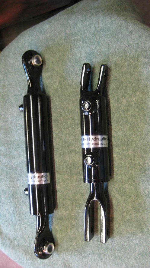

Has any one added a Hydraulic side lift to a CK2510 or similar Kioti? Before I speak to the dealer I'd like to well informed enough to decide if I should cobble together a kit myself or purchase a system from him.
I already have quick connects on the rear for my Back hoe and thought all I'd need is a valve and a cylinder to replace the adjustable side lift link.
Any advice is much appreciated. I do have a retired farmer and a retired machinist as neighbor/friends and they might be able to assist in installation and modifications.

Think you're talking about a hydraulic tilt link, correct? I've seen a few put together on other forums. You may want to try posting in the "Build it Yourself", "Hydraulics", or "Customization" forums.
   / Hydraulic side lift for a CK2510 #3
If you are talking hydraulic Tilt for the 3 point hitch I have not found one that you can piece together. But Fit Rite Hydraulic's
does make the (Custom) for the CK2610 and all Kioti's Fit rite Hydraulics.JPG

We manufacture Top-N-Tilt Kits for all KIOTI Tractor Models, and some "others" also. Our Hydraulic Top Links always include a Lock Valve, Side Links for the NX Series and up can be supplied with Lock Valves as an option. All of our Top and Side Link cylinders include the hoses, fittings, and couplings for plugging into KIOTI Rear Hydraulic ports.

Buggs67, further to MIE's post, I have their top 'n tilt toplink and sidelink kit on my CK3510SE, as does one of my neighbors on his CK3510SE. I can vouch for the quality, and the quick turnaround on orders. I think it's around 10 to 14 days.
I've also had an MIE hydaulic side link for nearly five years on my NX4510HST Cab, with a lock valve. Never a problem with it.
One additional data point for you: Another neighbor recently added the MIE top 'n tilt kit to his DK53010SE HC. He, too, is very pleased with the setup.
Another poster mentioned Fit-Rite for custom top 'n tilt components. Brian at Fit-Rite really knows his hydraulics, and all reports are that his kits, and his service, are first-rate.
