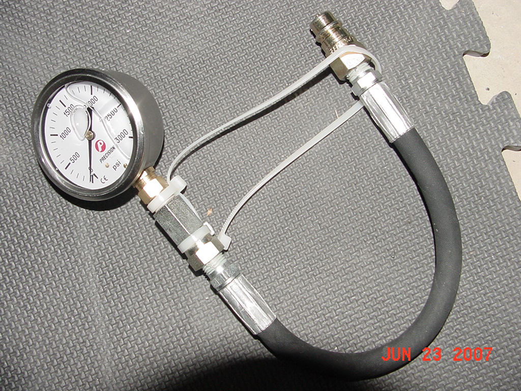

Hyd gages run about $10 to 20 at Northern, or Surplus hydraulics. If you have QD's, You can make up a gage and QD to plug into your QD's.
You could also install the gage in a tee at the IN port of the loader valve if you have a loader, and monitor the hyd system and use it for trouble shooting.
First you need the pumps max pressure, and then set the relief to about 50 to 100 psi below the pumps max pressure. Check the pressure and if you have to add some shims, use the smallest and see what the results are. It might take the smallest shim, or the whole pack.Good luck.
