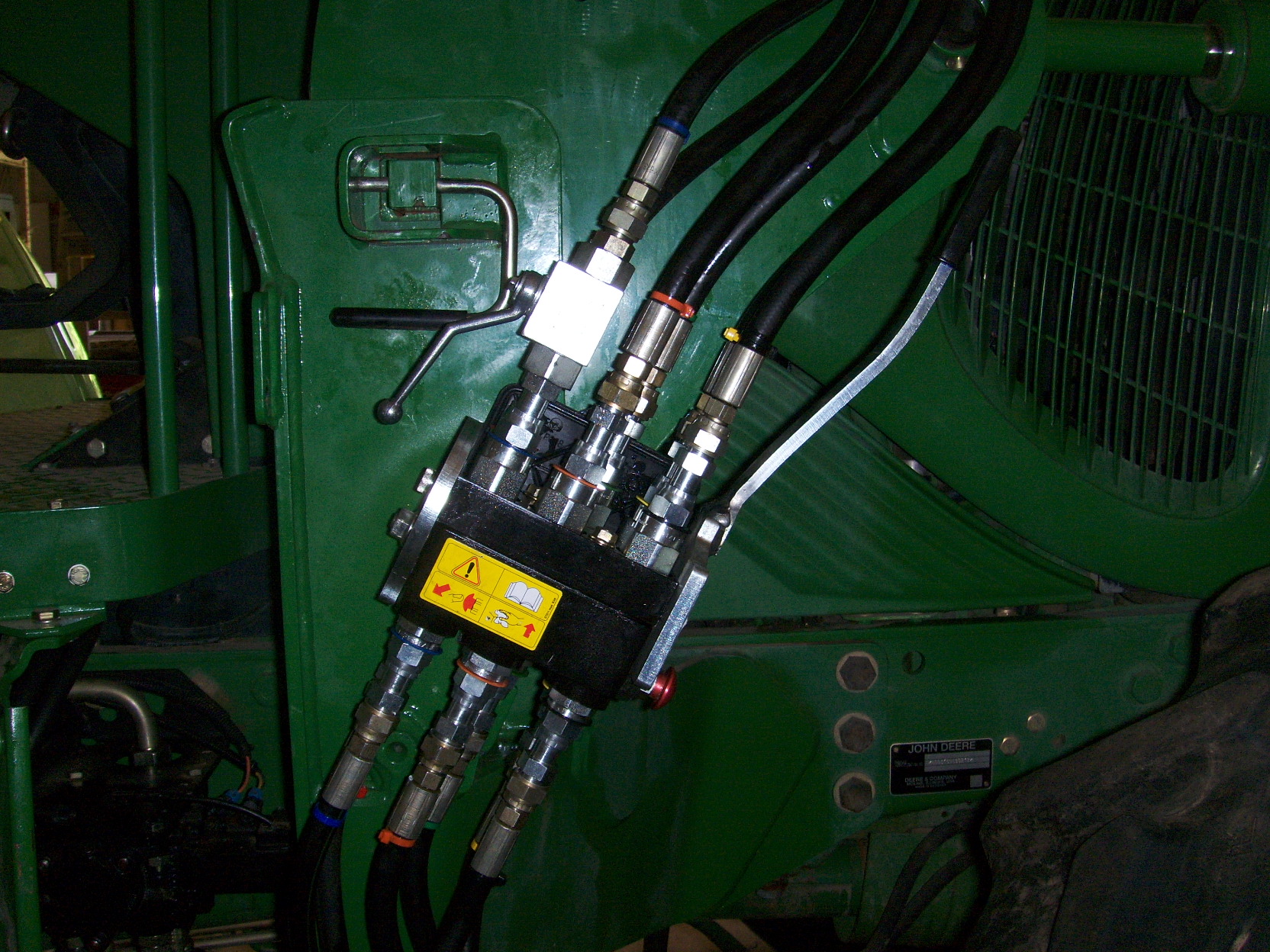

I have a Faster brand single point/multi-coupler. In my case it's for 6 lines and connects/disconnects all at one time. It is used for my loader that has two extra (third function lines) in addition to the four for the loader. It works great! Because a lever is used to engage the couplers, pressure build up is not a problem.

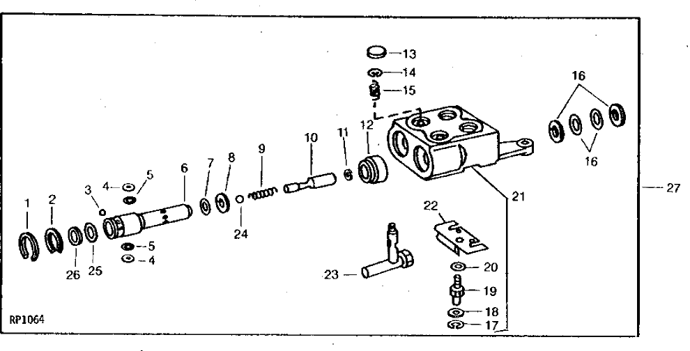

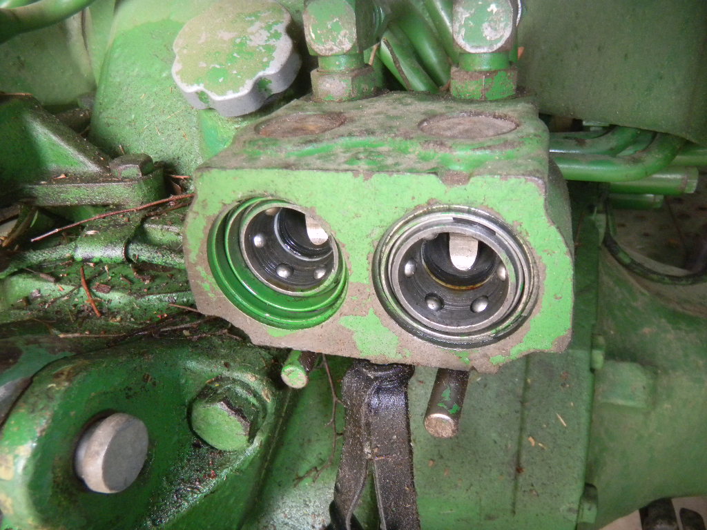

The other problem I have encountered on the tractor side couplers is leakage. I have had to rebuild the couplers on John Deere 2030 several times, but it is a 46 year old tractor and the couplers are an old, no longer used, design. The male tips are also an old, no longer used, design (John Deere only). These are not todays standard, so having both an older tractor and a newer one, they use two different coupler styles. Adapters or coupler changes are needed for using something set up for the old JD to use it on the newer tractor. I think now, couplers have been standardized.
