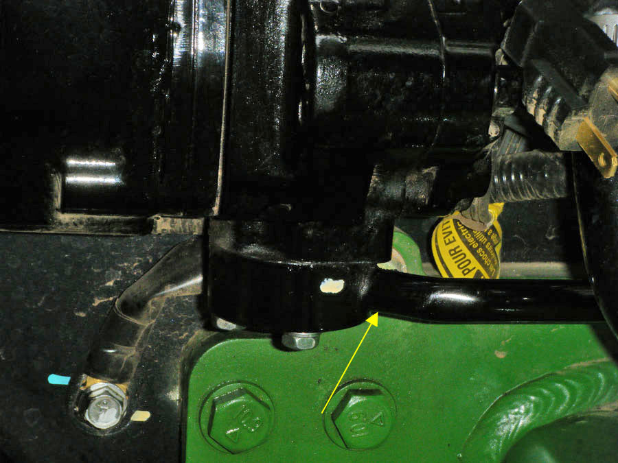

Hey Smalltown, I been looking for you to ask a question about your High pressure line leak a while back and to ask how you resolved it with the dealer. I have a 2720 that has blown the same line in the same bend under the seat. First time was as a new machine with just a few hours on it , and now again in the same spot. The CUT now has 340 hours, and I am having a **** of a time with my dealer. The last time I was told that JD had re called that line in the 2520 and the 2720. Now I am getting the run around again. Can you please fill me in on what you had done? Thanks in advance. You may want to look up my post on owning /operating and reply there or send me a reply at ecd_45@hotmail dot com .
   / Hydraulic quick connects
Wooden I can't exactly recall how many days I had the tractor, but it was very few maybe a week, when I noticed what I initially thought was smoke, and quickly realized the tractor was spraying hydraulic fluid. Not sure if this is the same hydro line as your issue, but mine line broke adjacent to the pump. I have attached a photo before the repair, with an arrow pointing to the leak point. I paid for a haul to the dealer. It was repaired, and ready for me to pick up in a few days. I was not charged anything so I thought it must have been covered under warranty. Other than the fuel cap not being centered in the hood opening I have no other issues. Getting ready to do my 200 hour service.

Smalltown. I looked at Your photo a few days ago , and yes it is the same line. Mine broke on the banjo fitting under the seat. Now this is the second time that this has happened. Mind you, The dealer told me that JD had recalled that "pipe" as it is known, but now they seem to want to sing a different song. I sent them a video of the leak with the hydraulics activated so they can see that it is again in the same spot. They made me pay shipping to get it here , but said JD covered it as a re call. I live in the Virgin Islands so it was not a cheep fix, but I do the work my self , so no cost there. Now I wait till Monday for the parts manager to get back from Vacation before I find out where this is going. I am thinking I'll have to Tig weld it rather than pay $448.00+ and this will not be the end of this issue. I will youTube this Video for all to see who my dealer is , and how they handle it. This is clearly a manufacturing problem. Will keep you posted
