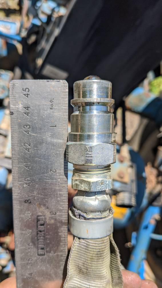

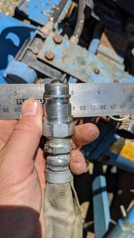

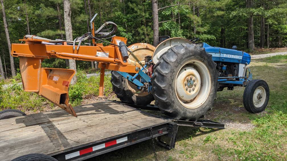

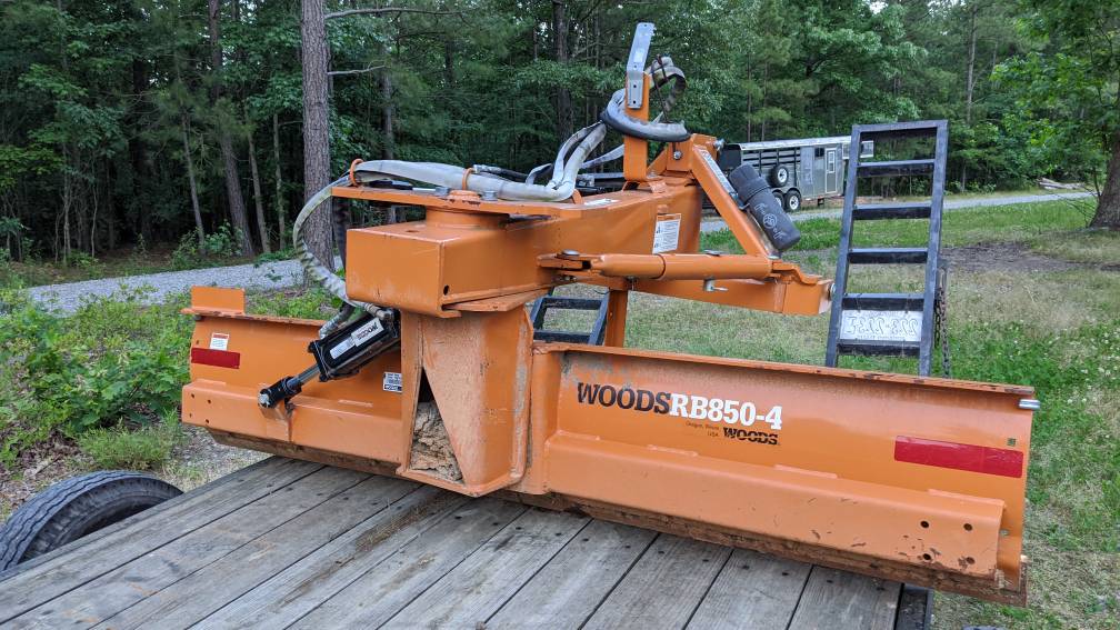

Just picked up this RB850-4 ($1000) and trying to get her hooked up to my hydraulics (3910). Having a hard time getting this male to seat/lock in the female on the tractor. This will be the first time using the AUX hydros since purchasing the tractor years ago. I also picked up some new Pioneer connectors and they look to be the same dimensions. Any help would be greatly appreciated!

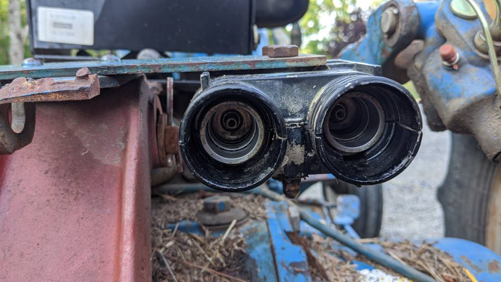

Here you go. Hope this helps. IMG_20200605_201915.jpegIMG_20200606_151905.jpegIMG_20200606_120545.jpegIMG_20200606_120526.jpegIMG_20200610_071530.jpeg

After checking out the female, definitely not flush face.

Your existing male is ISO 5675 Are you releasing all pressure ? With engine off, move the tractor controls, Take fitting loose from implement. Heating of trapped fluid will build pressure. Or tap the fitting center with a soft faced hammer.
