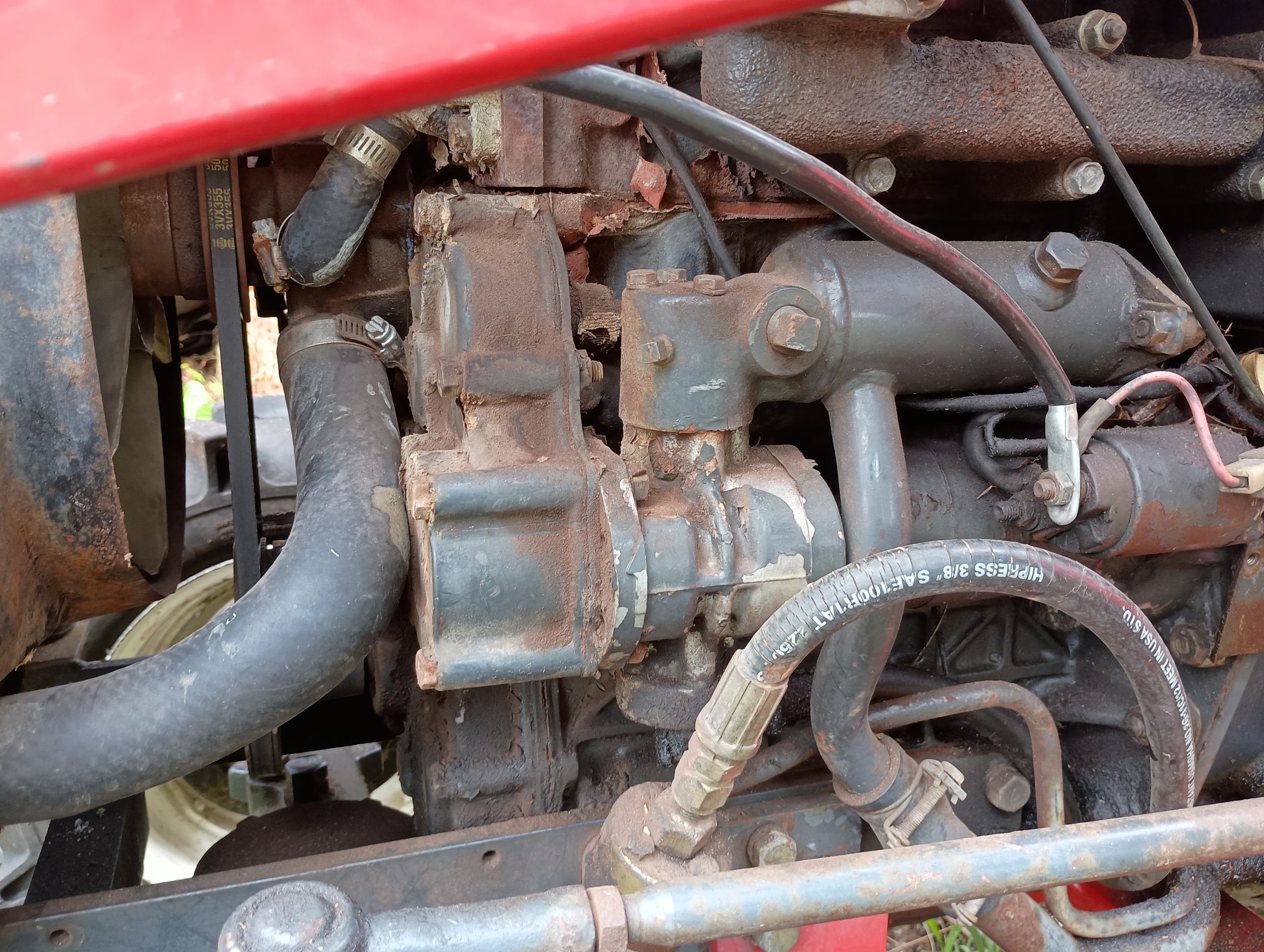

Where is the hydraulic pump mounted on that tractor? Reason for asking is that you may be able to find a replacement if it is not some special mount or shaft that was designed specifically for that tractor.

The pump is forward of the operators left foot.
I believe the large grey tank below the exhaust manifold is the screen / filter for the hydraulic oil. I've never cleaned this and don't know how you'd get to it. I speculate that the business bits on the left side of the image are the drive mechanism and that the pump is the middle bit between that and the metal return line. I can't imagine finding a generic replacement but I think this machine had common parts with Ford, NewHolland, and Yanmar.
I've had the impression that this machine was from around 1980, but I'm not sure where I got that idea or how I'd be able to tell.

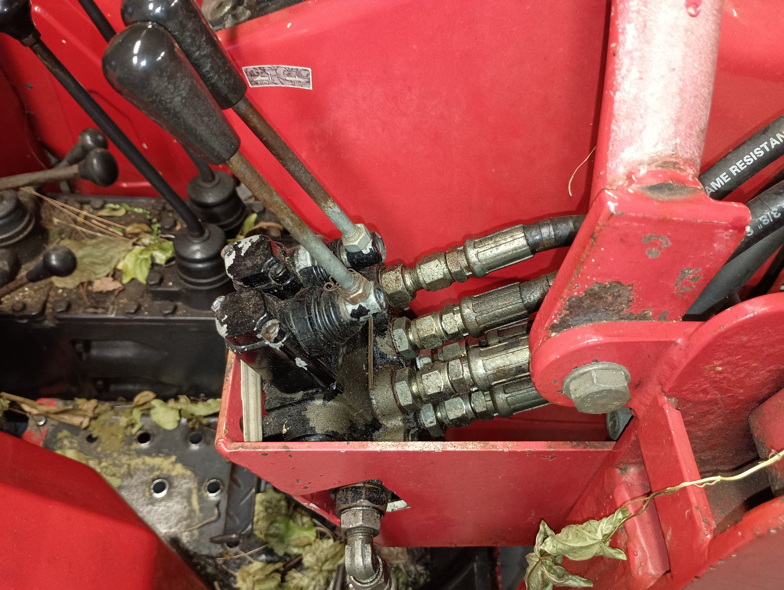

The second photo is of the hydraulic control valves. This thing is getting a bit cantankerous - sometimes sticky. Slow for things to start happening. I'm pretty handy but never done hydraulic work. I've thought about tearing it down and trying to replace seals and O-rings, but I can imagine little springs, clips, ball bearings, etc. inside, and that it might be like trying to reassemble a clock.

Looking at picture of the valve there should be canister like covers on opposite end of the valve where levers are mounted. Under those covers is where the centering spring mechanism is. These can fill with crud over time causing valve to get hard to move.
I haven't noticed a change in how much I can lift. Once things are moving, the speed seems the same as always. What I meant by sluggish is that when I actuate the valve raise the bucket, it often takes a second or two before anything happens. I think this also happens lowering the bucket when the bucket is already against the ground. Lowering the bucket when it's in off the ground happens immediately whether the tractor is running or not. This isn't as noticeable when curling the bucket.
As for the control valves... sometimes the left one (bucket up/down) is hard to move. I like you hypothesis that there is crud in the mechanism. I need to replace all the hoses anyway. When I do, I'll clean this up, and have a look inside.

I've dealt with several customers with the Viet nam loaders. Control valves are a common problem. They are not usually rebuildable. The spools are a repression fit. The hydraulic pump reservoir is the transmission. If it has pump plumbed to a tank, it is the power steering pump.
