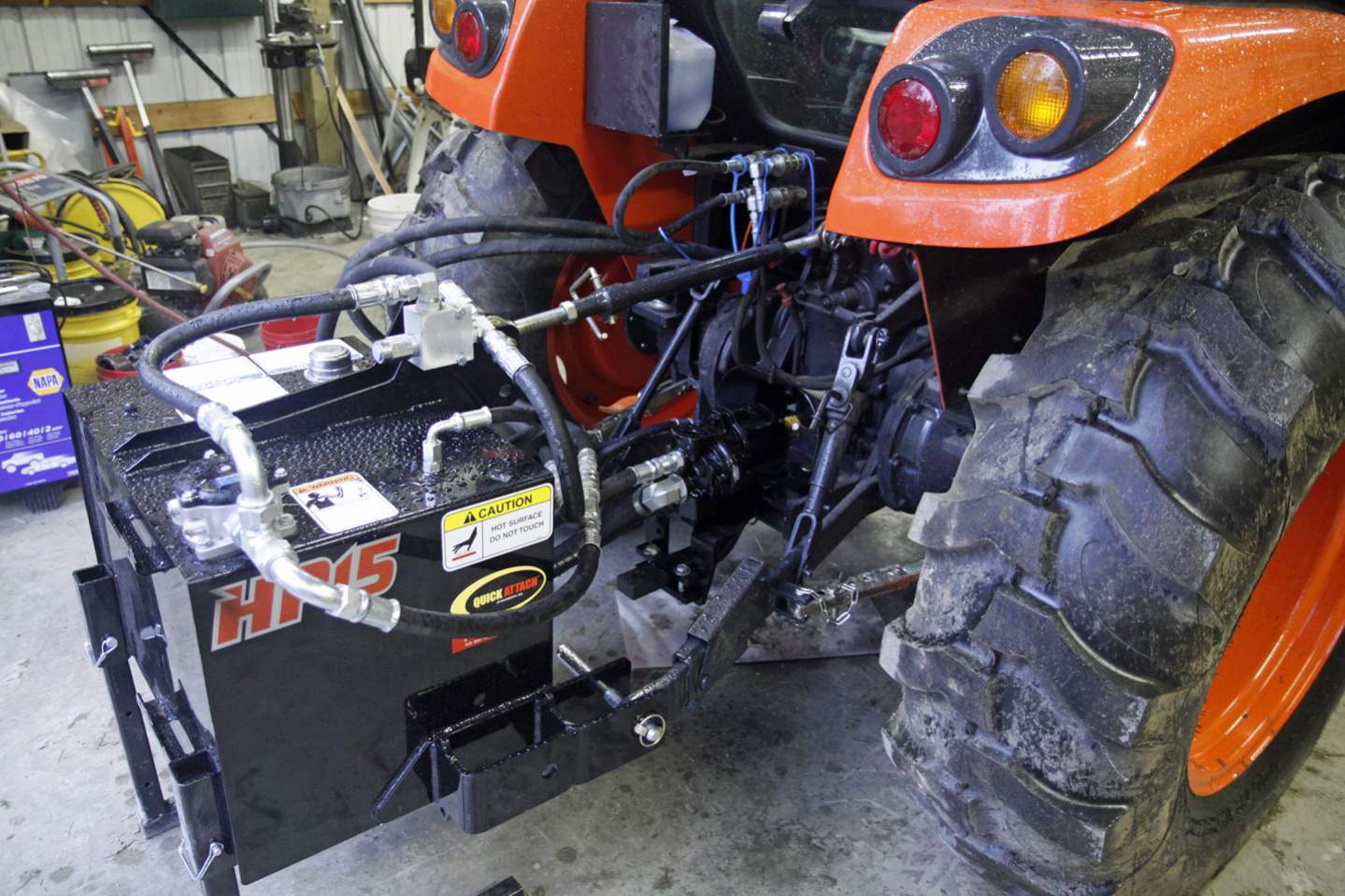

yup. the only way around that is with a 3 point mounted hydraulic tank and pto pump. expensive for a broom. I have one for my front snow blower, and can adapt it to run front equipment like brooms and post hole diggers. Mine puts out 15 GPM at 3,000 psi. It mimics a skid steer performance. powerpack 1.jpg
