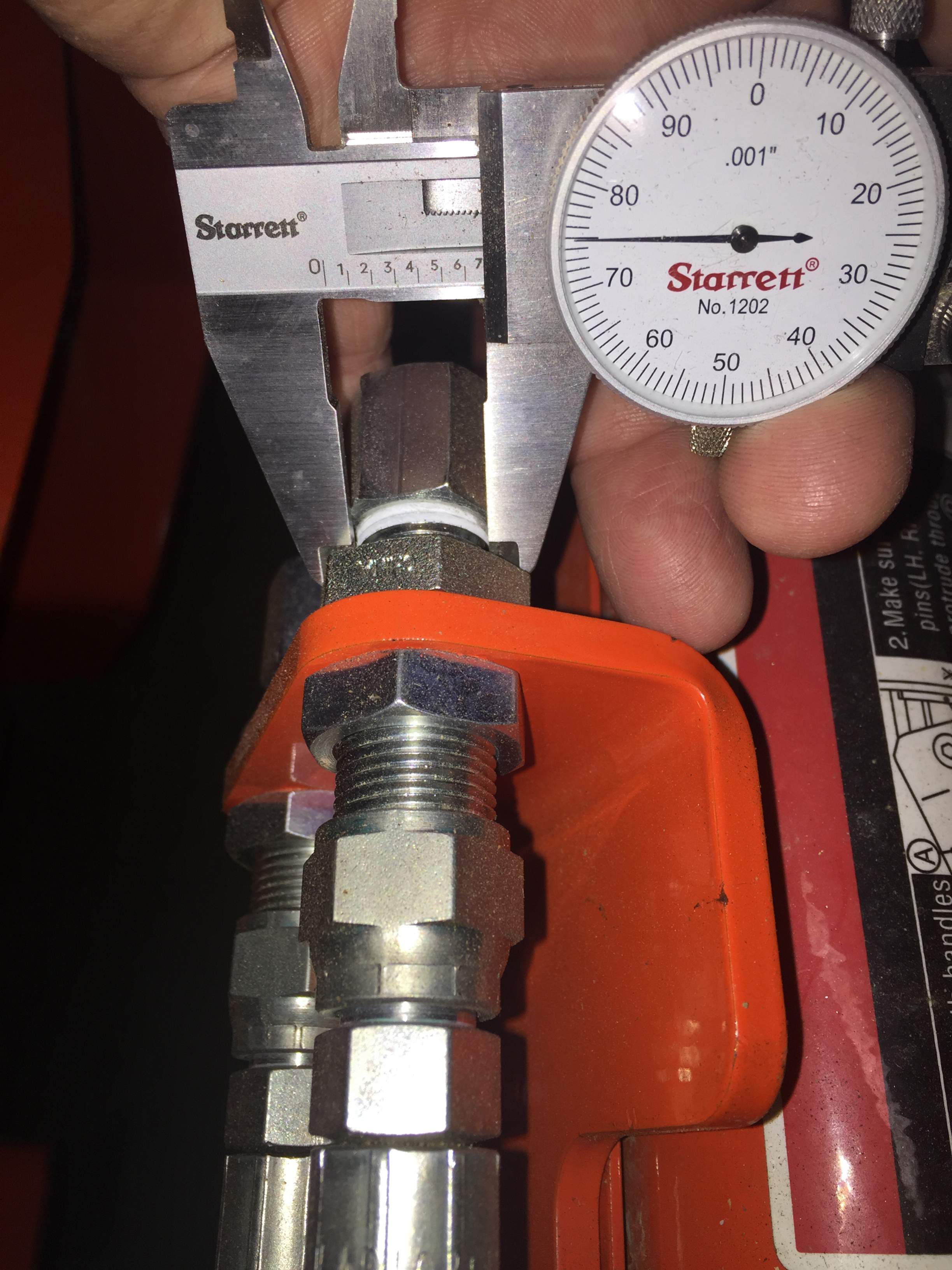

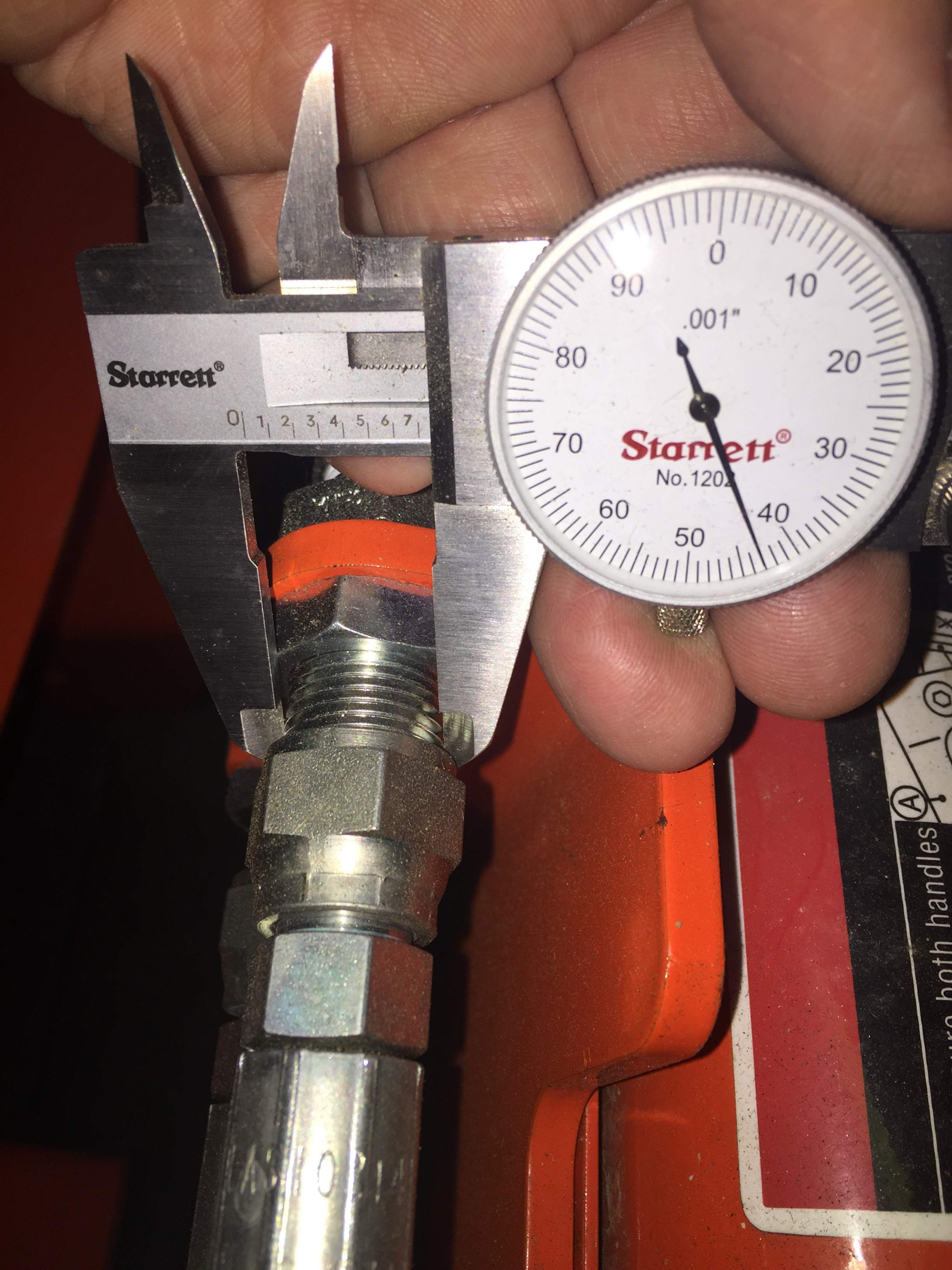

Hey Everyone.
I recently had a 3rd function remote added to my B2650. I want to replace the capped ends of the lines at the bracket the dealer put on with a couple QA couplers in place of the caps.
The dealer (or kit) put/had female to female nipple/adapter at the bracket on each line that is two different sizes. The end towards the valve is a bigger size then the capped end size. The valve side of the nipple is ~0.75. The implement end of the nipple is ~ 0.675.
QUESTIONS:
(1) What's the deal with that?
(2) What size QA coupler do I get on the implement end. I think I'll go with male QA ends.
Here are pics of both measurements
   / Hydraulic QA Coupler Sizing Questions #2
Thats just an adapter fitting.
Looks like a NPT to JIC bulkhead fitting. 3/8" NPT to 1/2 (-08) JIC fitting
Male Pipe (NPTF) x SAE 37° Flare (JIC) Bulkhead
You need fittings with 3/8 NPT to connect onto where the cap is.
And it appears they used teflon tape. Get rid of that and use a sealant or paste
:thumbsup::thumbsup: (All 10 :)) Use one male & one female on the bracket, and one of each on the hoses, so they'll go together correctly every time you connect.
M and F Q-D couplers will seal when disconnected. (as best they can)
