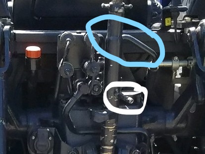

   / Hydraulic Pump #8
is the rear scv the valve assembly with the valve you have been adjusting? If yes then I would suspect tank line is getting hot due to a leak path in the valve assembly. Some valves have a power beyond plug with O-rings on them. These O-rings have been known to fail which allows the pressure line to connect to tank like an orifice limiting system pressure.

Correct. The rear scv valve is the one with the valve I have been adjusting.
   / Hydraulic Pump
The blue circle is the line that gets hot and the white circle is where the relief valve is. This is the only picture I have on me atm.
