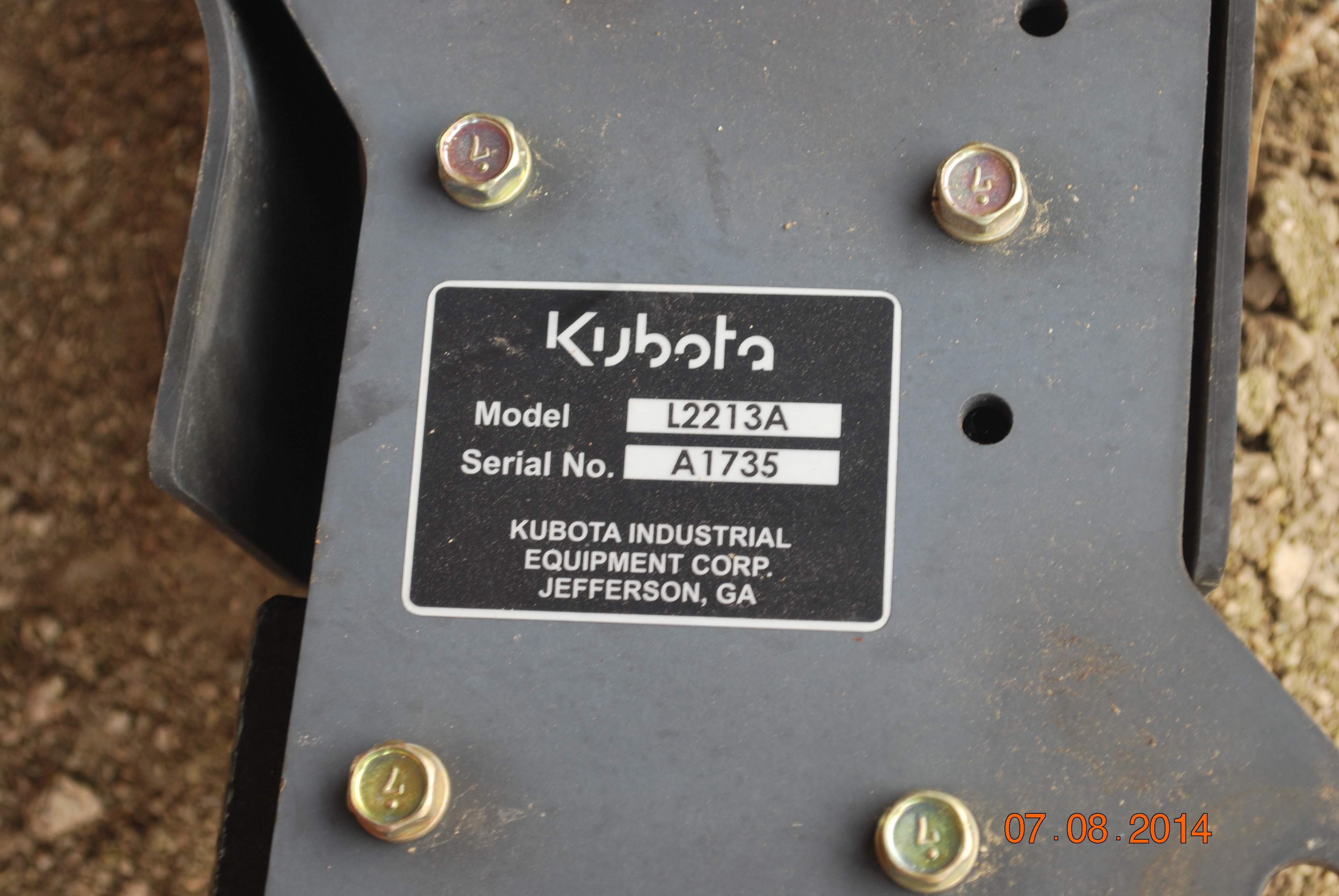

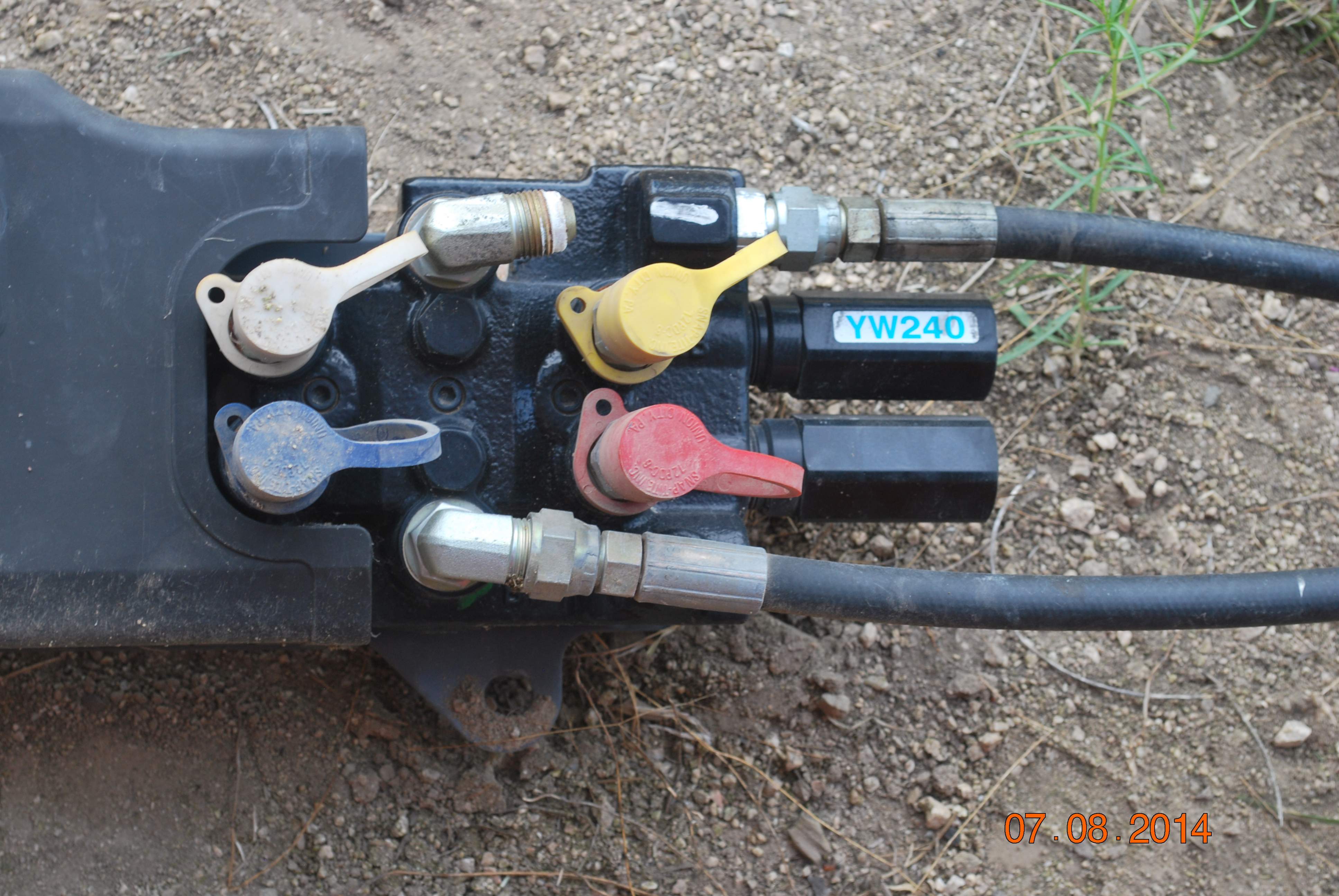

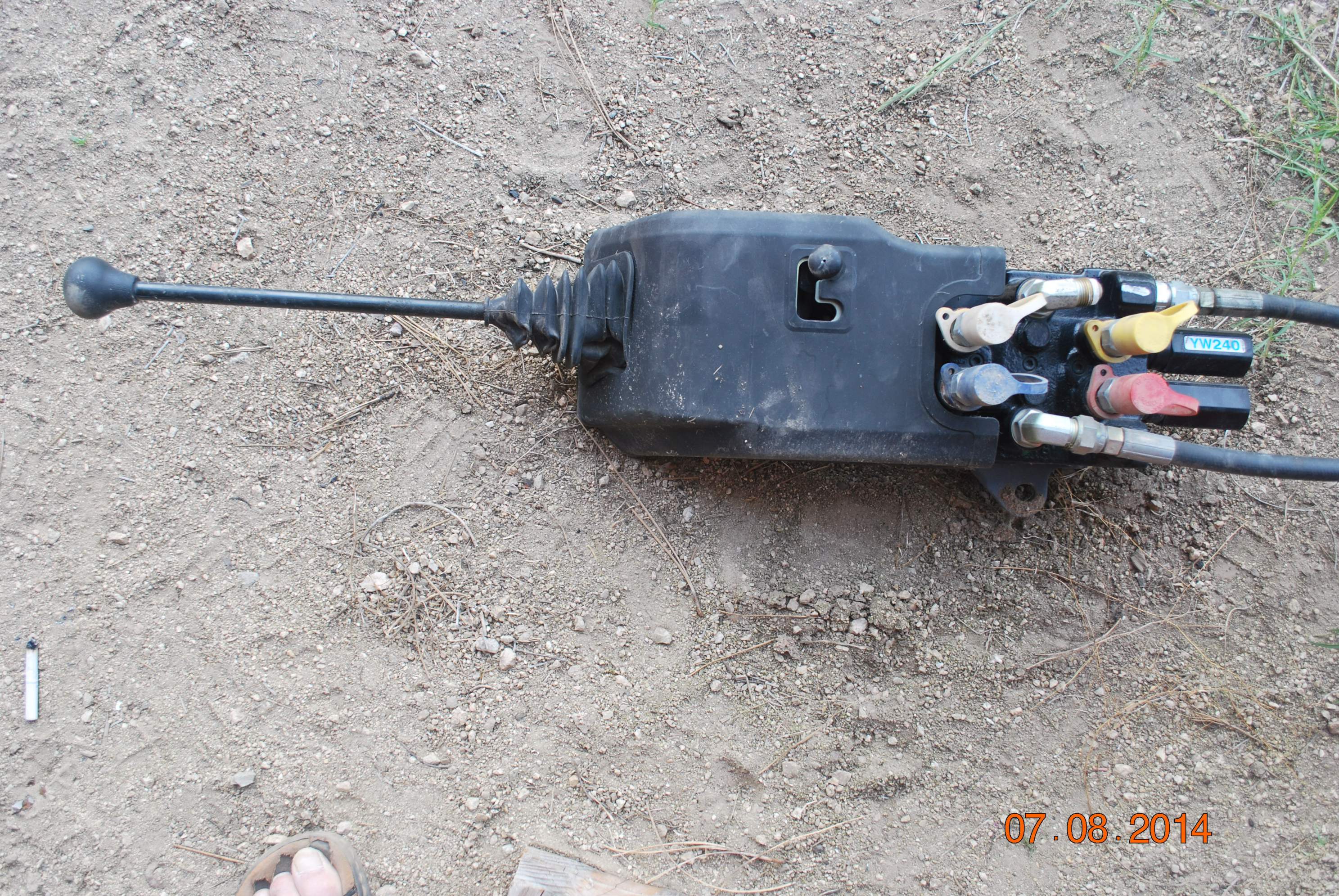

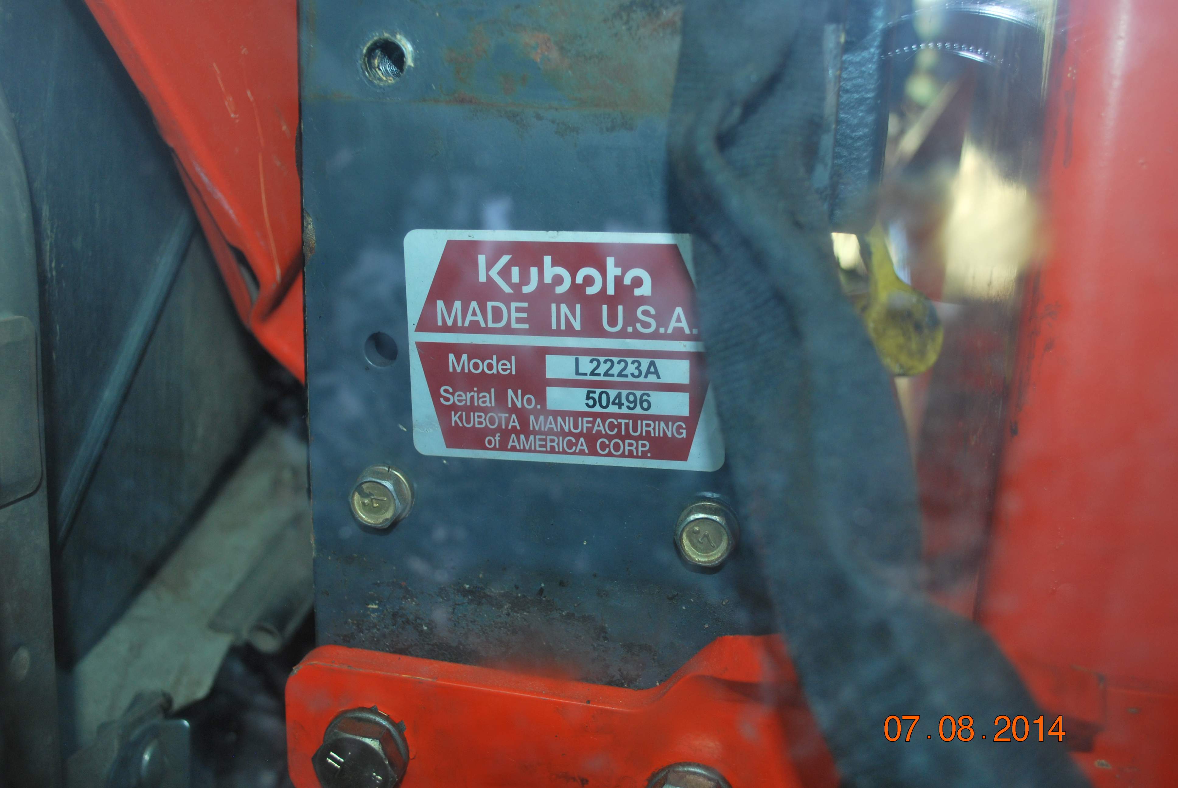

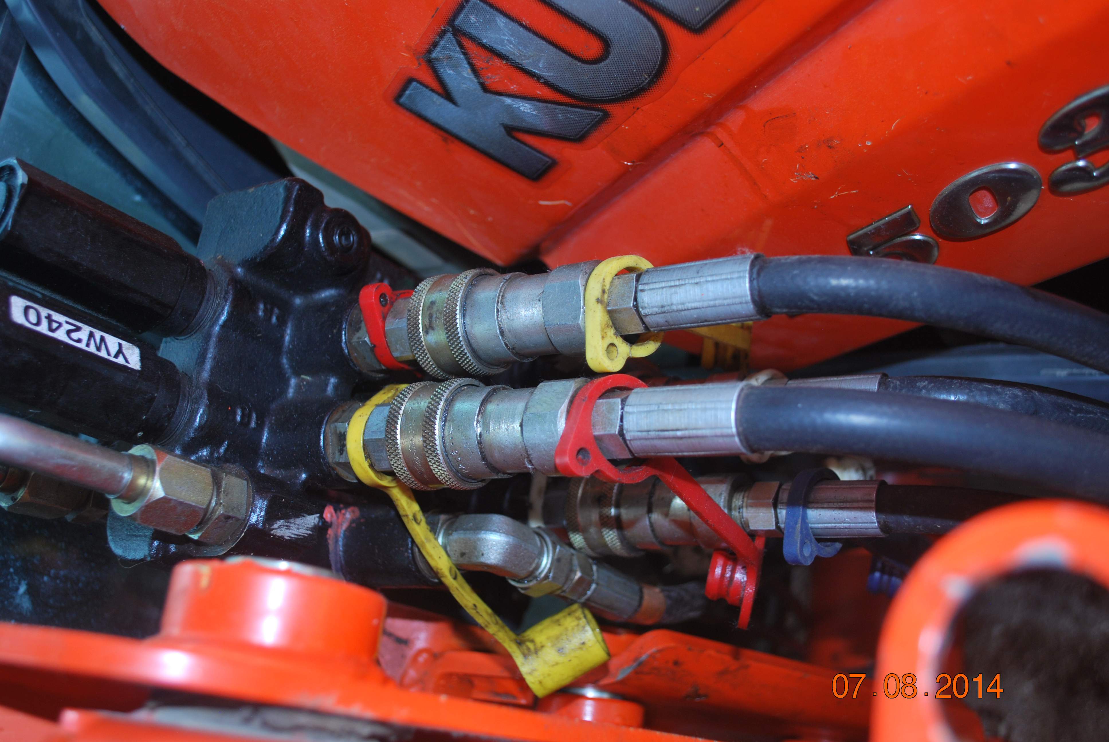

Hear are some pictures of what I have. When I went out to take these I noticed that I have two different models. The "red" block came with the tractor and snow blower when I bought it new in 2004. The other block came with the loader and is the type installed on tractors without a cab. My tractor has the factory cab. The way the QD's are attached in these photos everything works correct except when I push the stick forward the bucket goes up. The only way the bucket can be lowered is by pushing the stick into the float position. If I connect the QD's color to color(red to red, etc.) Moving the stick side to side the bucket goes up and down and moving the stick front to back the bucket dumps and rolls.

Everything does not work correct.
Redo the hoses.
Connect the IN and OUT, and PB hose hoses. Leave the cyl hose off.
Leave tractor at idle. NO cyl hoses on the valve yet.
You might have a little mess but you will have it figured out.
Which ever port the fluid comes out of, connect that one.
Now push the stick fwd. The retract cyl hose on lift arm goes here.
Now pull back the lever a little to make fluid flow. The extend cyl hose goes here.
Push stick left. Bucket hose retract goes here.
Push stick right. Bucket extend hose goes here. It is the last hose anyway.
   / Hydraulic problem on a LA853 Front End Loader
Hi, JJ,
Call me a dummy, but how do I tell a retract cyl hose from a extend cyl hose?
Update! Finally dawned on me that the extend hose is at the opposite end of the ram and the extract is at the ram end.
