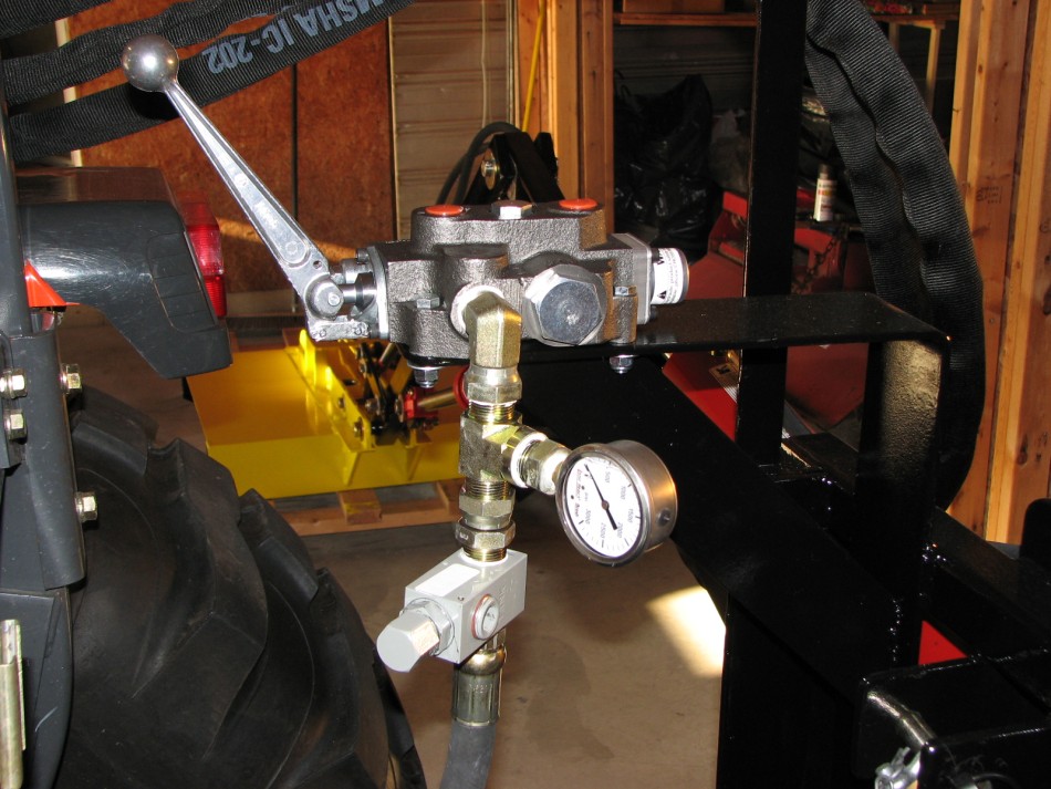

Hi,
I have a 20 gpm Prince relief valve, between a 21 gpm pto pump
and motor controller, there is also a 3000 psi gauge after relief
valve.
My question is I'm not sure about how to adjust relief valve. With
pto engaged and turning about 540 rpm, all the pressure I can get
at the gauge is between 500 & 800 psi. This is no load pressure
and I am turning adjuster on relief valve.
The Prince relief valve has an adjustable range of 1000-2500 psi.
Advise needed, Joe

That may be OK for the "no load pressure". You need to operate the valve and deadhead the pump to set the pressure relief valve.

If your system has a cylinder, hold the control valve either direction under pressure. When you do that you are dead heading and your gauge will show the relief setting pressure.

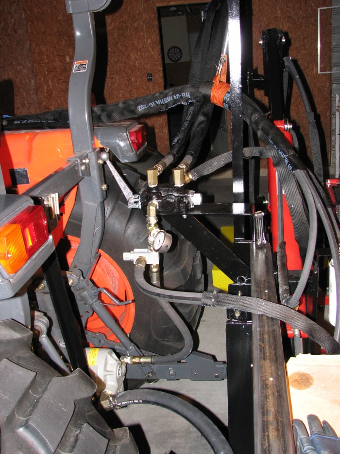

Thanks Chuck I didn't think about Lovejoy could be weak link.
I think your suggestion about backing the relief off and slowly
tighten till I get what I need.
One more thing about relief valve, loose means low pressure and
tight means more pressure. Am I close?
Thanks again, Joe
