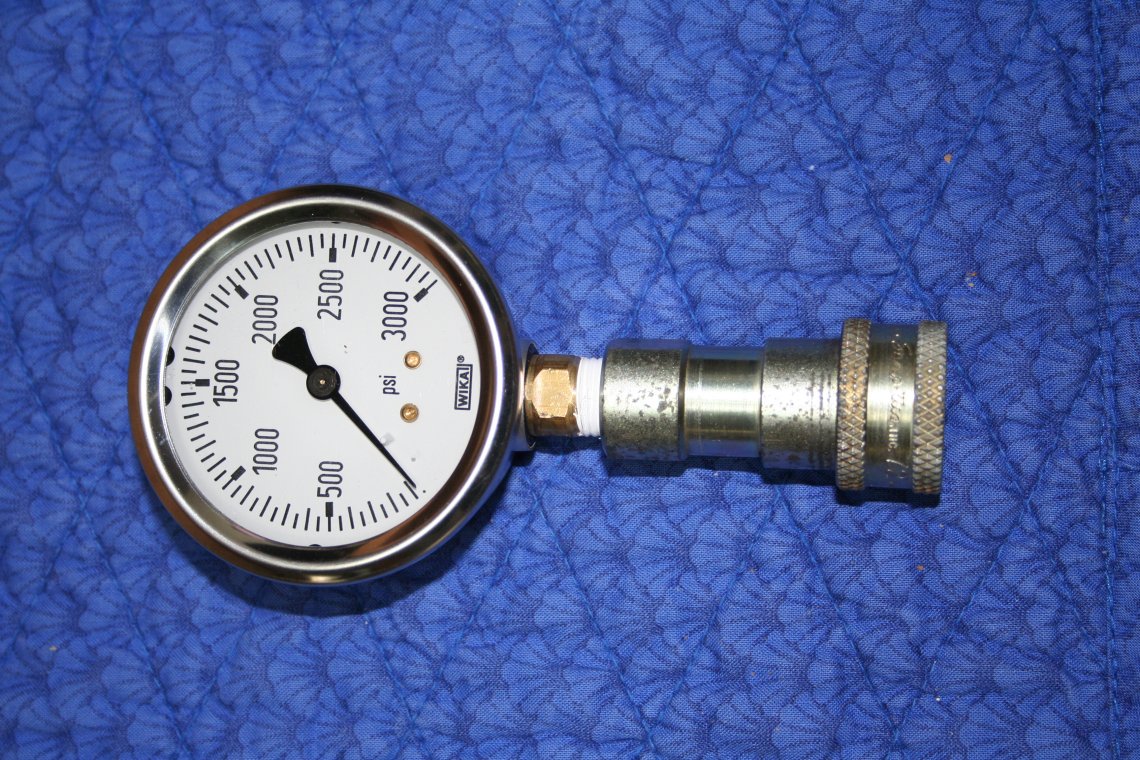

If you don't have a gage test set, you can make one up like these.
