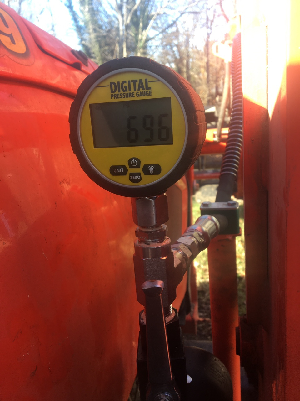

I keep a gauge on mine. Used to not only measure relief pressure but also monitor KSR, Kubota Soft Ride feature. Being an eccentric engineer like seeing real time measurements. The electronic gauge has features like different scales, max pressure, tare, back lighting, etc. Down side is battery life in cold weather. Turning off in cold weather conserves battery.
Be aware hydraulic components down stream from control valve are effective by load and are not relief valve protected on most tractors. Some bigger, expense, more powerful construction equipment do have crossover relief valves. My gauge is on the loader lift circuit. If I lift to relief pressure ~2700psi, close the loader lift valve and then try to curl and or push with the transmission against the load, I can see lift circuit pressure almost double. Dynamic load pressure on top of relief pressure.
Pulling back with grapple tines spikes the dynamic load pressure on 3rd function circuit.
Similar spikes carrying a loads over rough terrain. KSR really dampens those spikes and can feel the difference.
Hydraulic circuits to grader blade angle and top link cylinders can see considerable pressure spikes do to the lever arm force against the closed cylinder circuit.
My relief valve pressure for the loader is a little low. Older tractor 1500 hours. Still scary strong. See people shim theirs to max or higher. Just keep in mine it’s the dynamic loading that they don’t see or monitor after the relief pressure that can cause component damage.
