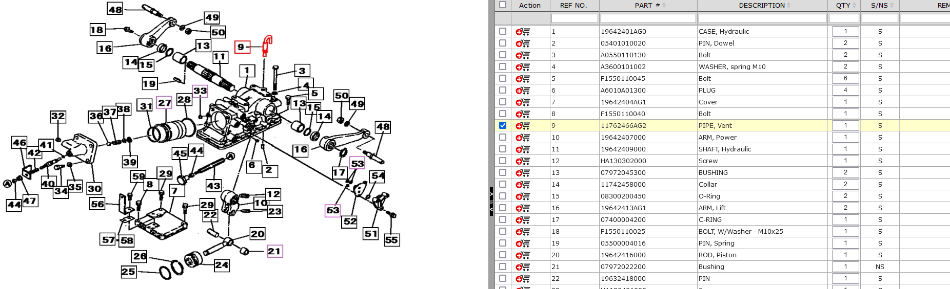

Hello forum
2009 Mahindra 2816 3. Cylinder Mitsubishi diesel
Hydraulic fluid pressure builds up after using the bucket. When this happens I release the pressure by pulling out the dipstick tube under the seat. I can hear and see the fluid pressure release like a volcano.
Is there air getting in a hose? Is there a vent that is plugged?
What else could it be? Hydraulic works slow is how I know the pressure is building up too much meaning he bucket tips and raises slowly.

That most likely a clogged vent. I don't know where it sits on that tractor, maybe someone who knows better can tell you.
I'll still look on the Mahindra parts catalog.
   / Hydraulic pressure blows out dipstick tube #4
Found it. It's located on top of the rockshaft housing.
   / Hydraulic pressure blows out dipstick tube #6

from reading his first post it sounds like it is sucking air and foaming up, if so he should see some foam coming out of the vent if it is clear.
   / Hydraulic pressure blows out dipstick tube #9
The mud dapper wasps are terrible for plugging vents.

Possible wasp nest in vent tube. Mud came out with a pick inserted in tube. I tried to poke a wire in further but it would not make the bend. Blew out with air.So far so good
