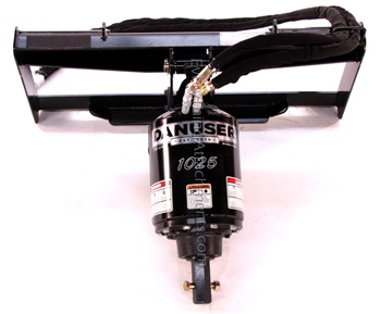

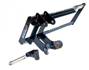

Danuser makes an excellent hydraulic FEL SSQA mount post hole digger offset to the side so you can see it beside the tractor hood. You have to ask for the offset mount I would get larger auger bits since the holes don't always go straight down and you also need room around the post to get the dirt/concrete back in and tamped effectively.
http://www.danuser.com/attachments/auger-systems/hydraulic/ep-heavy-duty-series/model-ep10
I don't know if they sell down under, but EverythingAttachments.com is a great place to buy in the US
