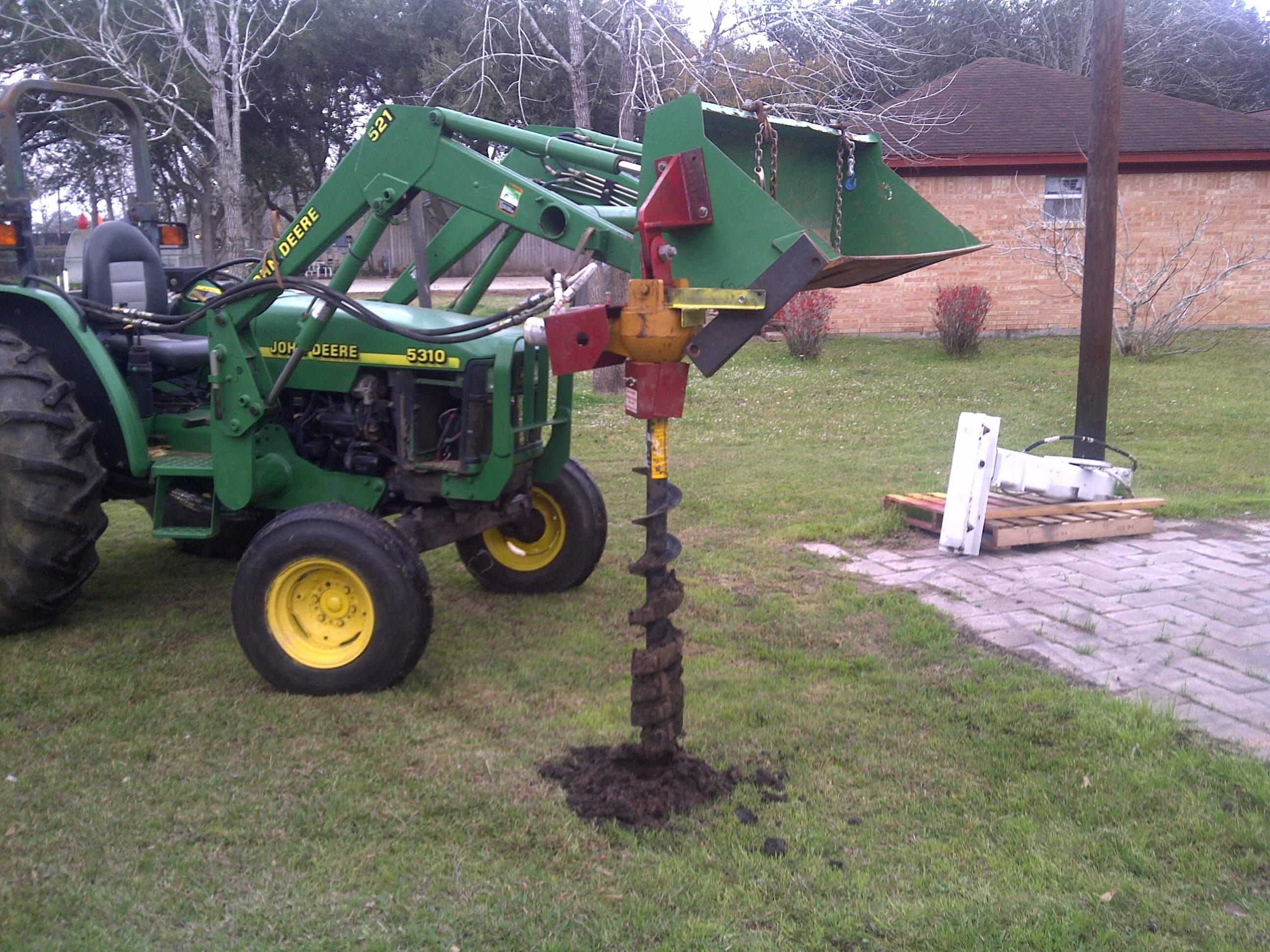

I want to convert my L7300 phd into a hydraulic one which will hook to my jd5310 fel.
I have a hydraulic motor brand Char-lynn 101 1025-009 with 12-14 gpm flow delivering 650-876inch/lbs torque
Does anybody have an idea if this motor gives enough torque and speed to run the post hole digger? JD deliveres 11gpm but i am working on a PTO pump with 21gpm for an other project so the flow should be ok.
the Motor speed is twice the 540 of the tractor so this doubles my torque?
Thanks for the input.
Pete.

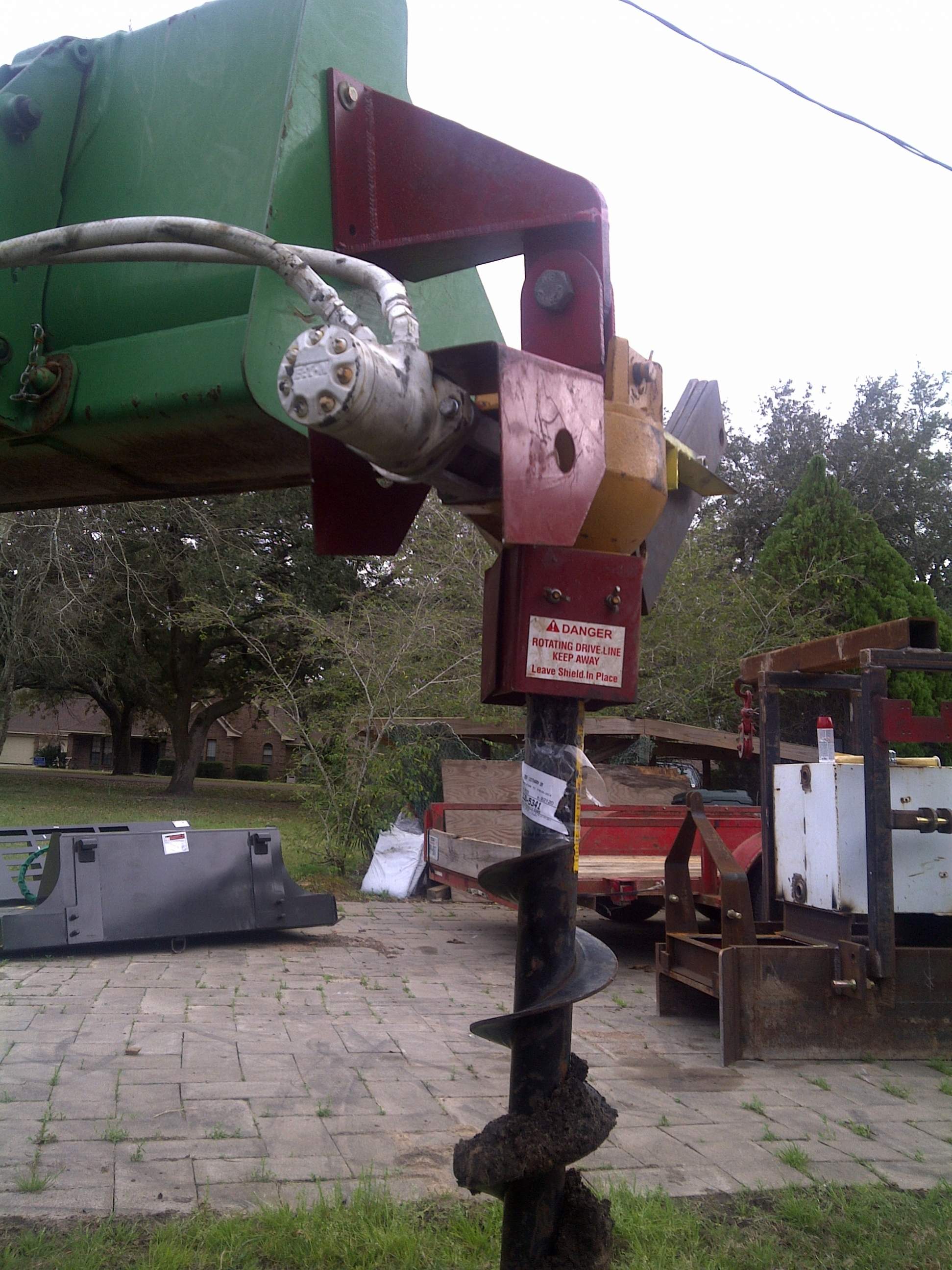

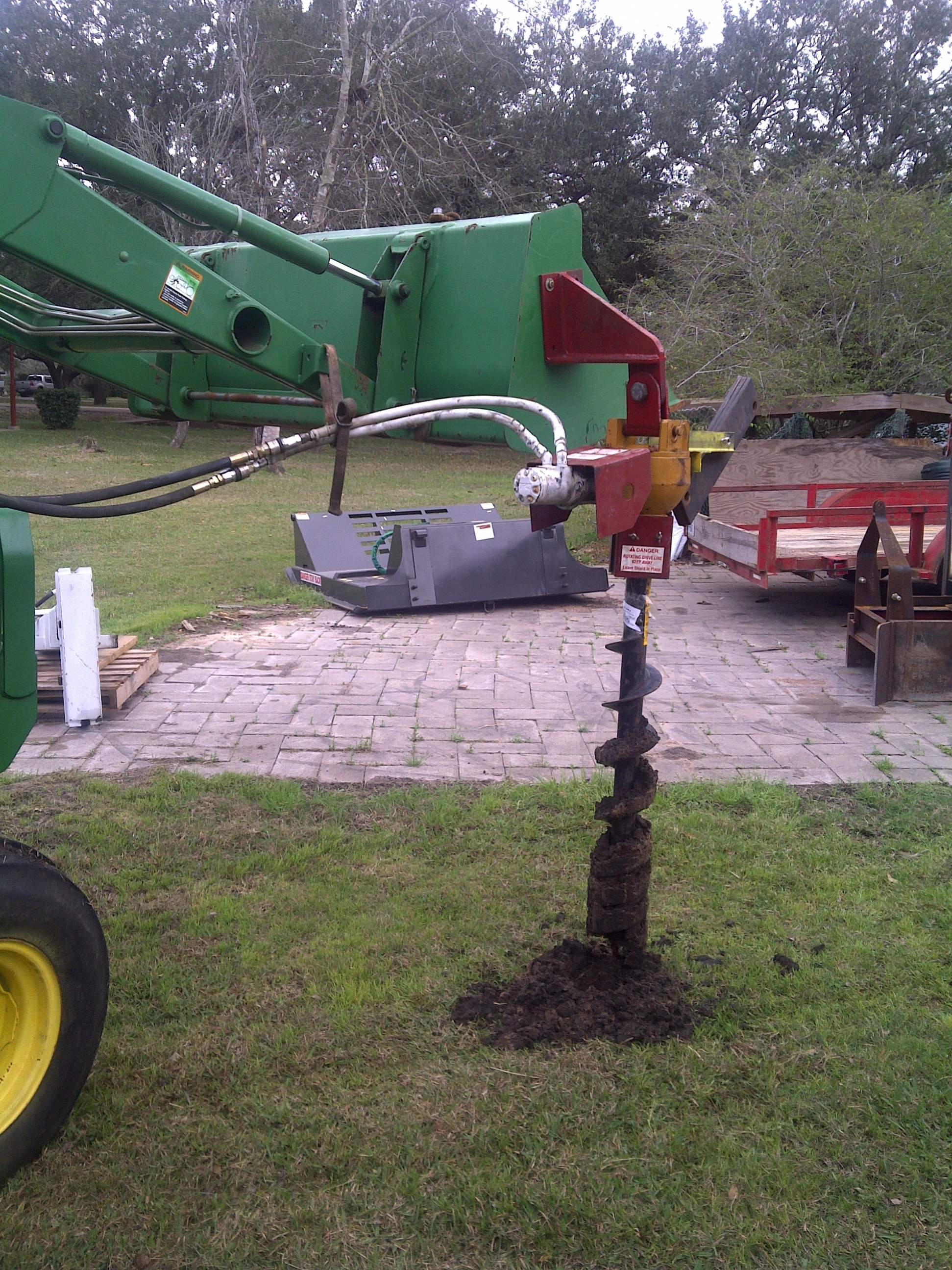

I found a bracket that fitted on the digger and on the hydraulic motor.
I used Northern tool 1" and 1 1/4" coupling in one i drilled a 3/8" hole in for the pto connector shaft.
Digger works like a charm on my 5310 which gives about 11gpm.
see pictures, the yellow bracket has some plates which act as counterweight for the hydraulic motor.

Just the info and even better pics and details I was looking for! Any chance you remember where you got the bracket that fits both motor and digger?
