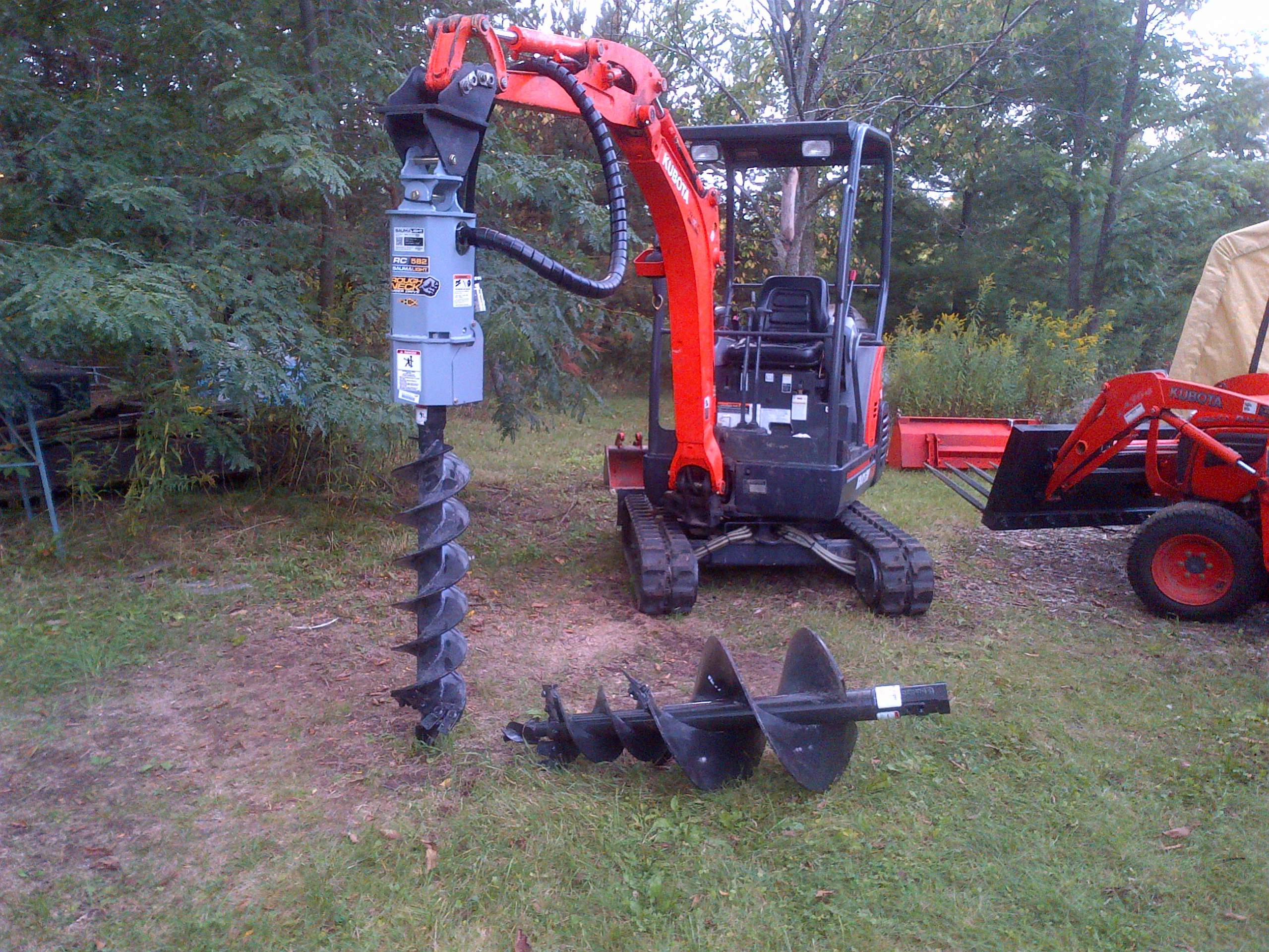

There is no doubt that a hydraulic auger is best. You can reverse the drive to get out of a hole and apply down pressure that you can't always do with a 3PTH. As part of my business I auger with a Kubota KX41 (photo below). It is a small excavator and find the height I can lift the auger and bit just clears the ground. That is something you may have to look out for if you get an auger to use on a backhoe. Unless you plan to dig lots of holes it may be more economical hire someone to do the job for you.
