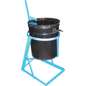

I use a funnel like you but first transfer some of the oil into smaller containers to make pouring easier. Two gallons in five gallon bucket is sort-of OK but I also use an old five quart oil container that is more maneuverable. Rarely do I spill drop.
The oil is transferred into the smaller containers with this "pail tipper" I bought. Works like champ and not sure how I survived without one. Bought it on Amazon.
Here's the thread on it.
