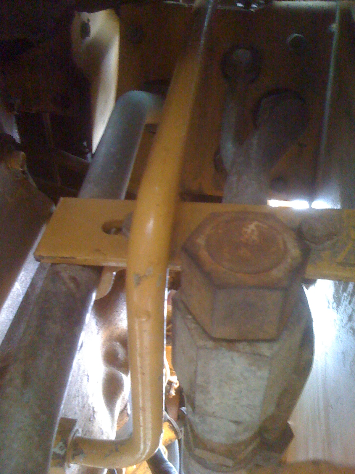

I have a question about Power beyond and a 545C tractor (Ford). I have a picture of the bottom of the HUSCO valve that runs the loader controls (Attached). There is a T at the bottom of the Valve, is this the power beyond connection or is it a T on the return line?

The T on the valve is normally the TANK port or return port.
PB port will have PB, or PBY or something similar.

Ok, looking at the new holland parts site I see it now. So if there is no power beyond how do I provide hydraulics to a backhoe I'm planning on installing?

I don't know the schematic layout of your hyd system, but there are some things you can do.
Most valves that only have a return port for the fluid, has a very low back pressure rating for the tank/return port some about 250 to about 500 psi. This kind of valve should be used in a high pressure series flow path.
If your BH has a relief valve on it, and a PB port you can route the pressure line directly to the BH first and then to the FEL.
Install an external relief valve before any valve for pump protection, especially when using QD's.
Disconnect the line going to the 3pt and install a female QD. This will be used when removing the BH. Add a male QD to the pump output line. This will feed the BH.
If you will not need the 3pt, you can then run the return from the BH to tank. If you need 3pt while BH installed, then run the PB from the BH to the 3pt input port.
For 3pt operation with no BH, connect the male QD to the female QD 3pt input .
2. You could just replace the FEL valve with a valve with PB, and run a single hose to the back and a PB hose hose from the BH to the 3pt. The tank port from the BH would then go to tank.
