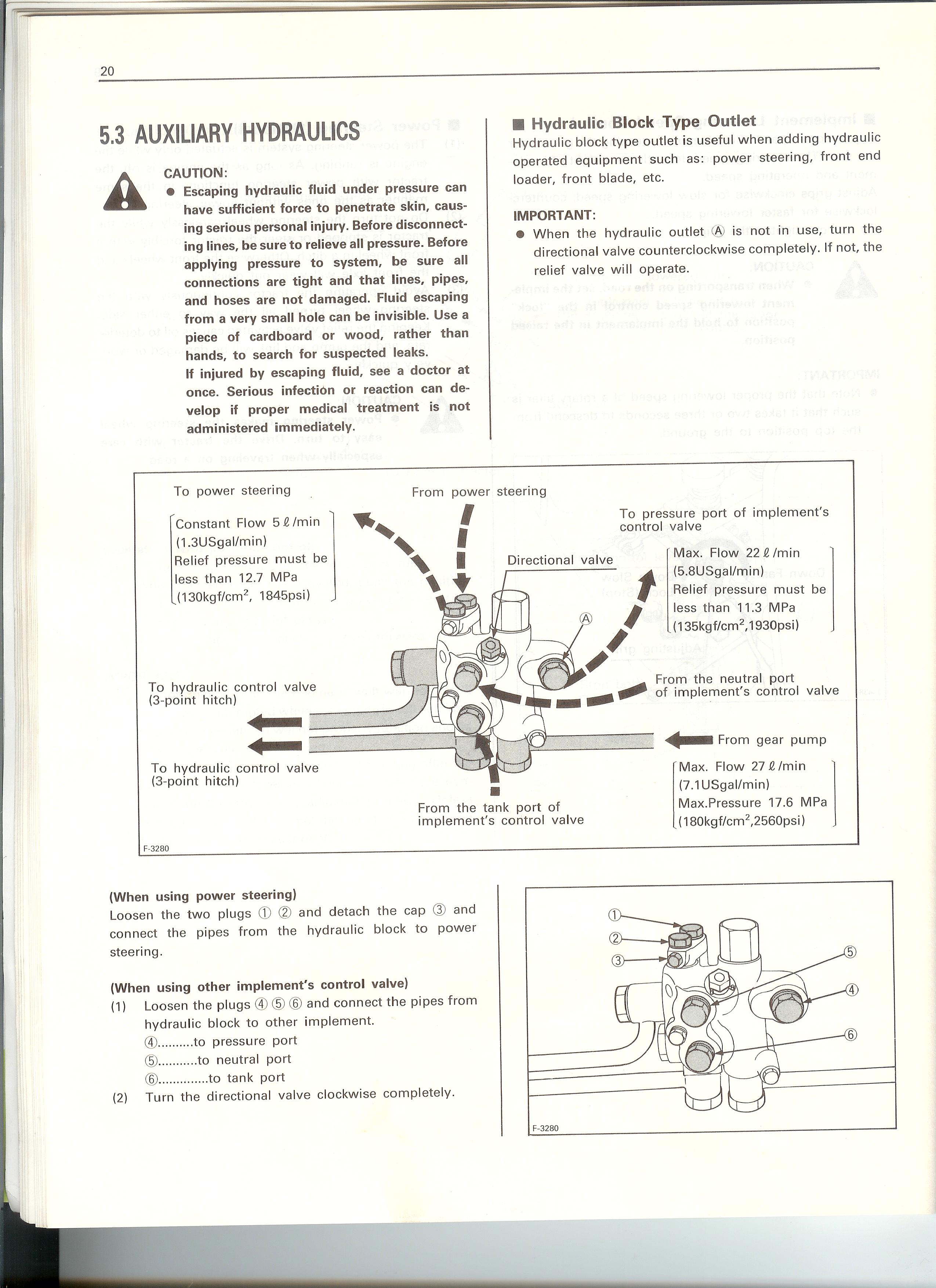

j__j
Here is a page from the owners manual showing the hydraulic block with the banjo fittings you mentioned. The line that I'm wondering about is the one labeled "neutral". Is it a power beyond that can be tapped into for an additional valve(s) with power beyond?

   / Hydraulic Neutral Line #4
I think you are correct with the power beyond. Looks like they made it easy for you(not on my L3400). I think all you need to do based on the drawing is pull the plugs and connect the hoses to your control valve.
That's what I was hoping to hear. That third line (called neutral) between the block on the tractor and the FEL valve has a quick coupler installed. Seems like I might be able to buy a matching male and female to tap in and connect the pressure and return hoses connecting to the new rear remotes valve block. I'm going to assume at this point that the additional valve block would not require a power beyond. Does that sound logical?

   / Hydraulic Neutral Line #6
I wouldn't assume you don't need the pwr beyond. The way my L3400 is set up with the block the FEL connects to uses pwr beyond. Looking at the drawing anything you hook up to this block maybe before other hydraulics. If it's the last item in the system then it shouldn't need the pwr beyond. I'm thinking that the plugs in this block actually connect the pwr beyond and the pressure ports. If you don't hook up to the pwr beyond you may lose your 3pt hitch function. Look at this thread (http://www.tractorbynet.com/forums/hydraulics/207342-hi-all-new-member-bob.html) I have pics showing a pwr beyond system if your not familiar with how to plumb them.
Yeah, I forgot about the 3pt and I'll bet you're right. Probably could uncouple the "neutral line" and see if that stops the 3pt.
I tried uncoupling the neutral line mentioned above. The 3pt then quits functioning and I could hear the relief valve "talking" with the engine idling. I guess that does confirm that an additional valve body for rear remotes will require power beyond. Also, with the neutral line re-coupled, the 3pt won't function when the loader is operating. I suppose that may be true with most systems?
