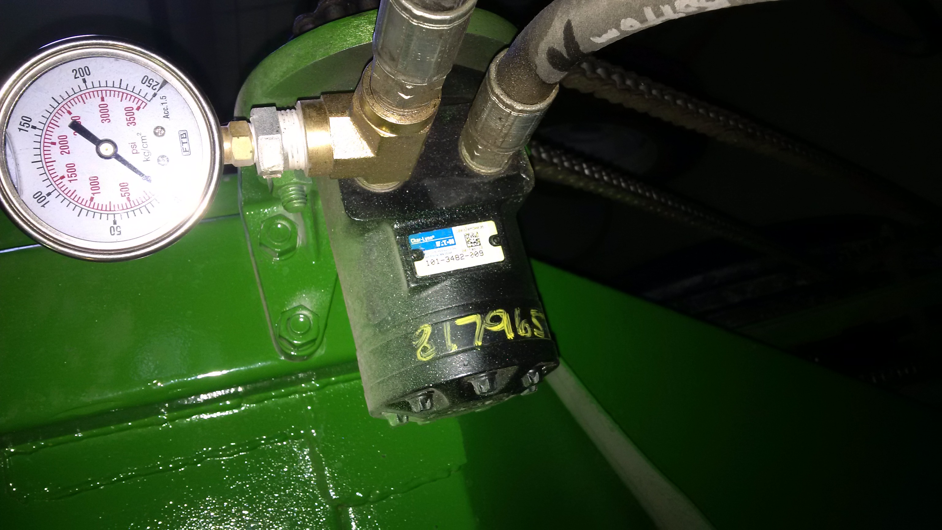

I have a project in mind to convert a ground driven pull type fertilizer spreader to a hydraulic motor drive system to spread sand, etc. I tested it with a 1/3 hp electric motor and with the right pulley it almost had enough power. I am not very familiar with hydraulic motors to run off our tractor. I can get this locally,
2.8 cu. in. 2-Bolt Hydraulic Gerotor Motor | Princess Auto
Is this what I should be looking for. The system will probably be run for about 30-45 mins/load. It runs both directions so I was hoping if I ran into a jam or a frozen chunk I can back it up?

This motor can use up 12 GPM, and you will need to put a relief across the motor and set it to about 1750 psi.
You also need a motor spool valve either lever or solenoid valve.
This motor can develop 10 HP.

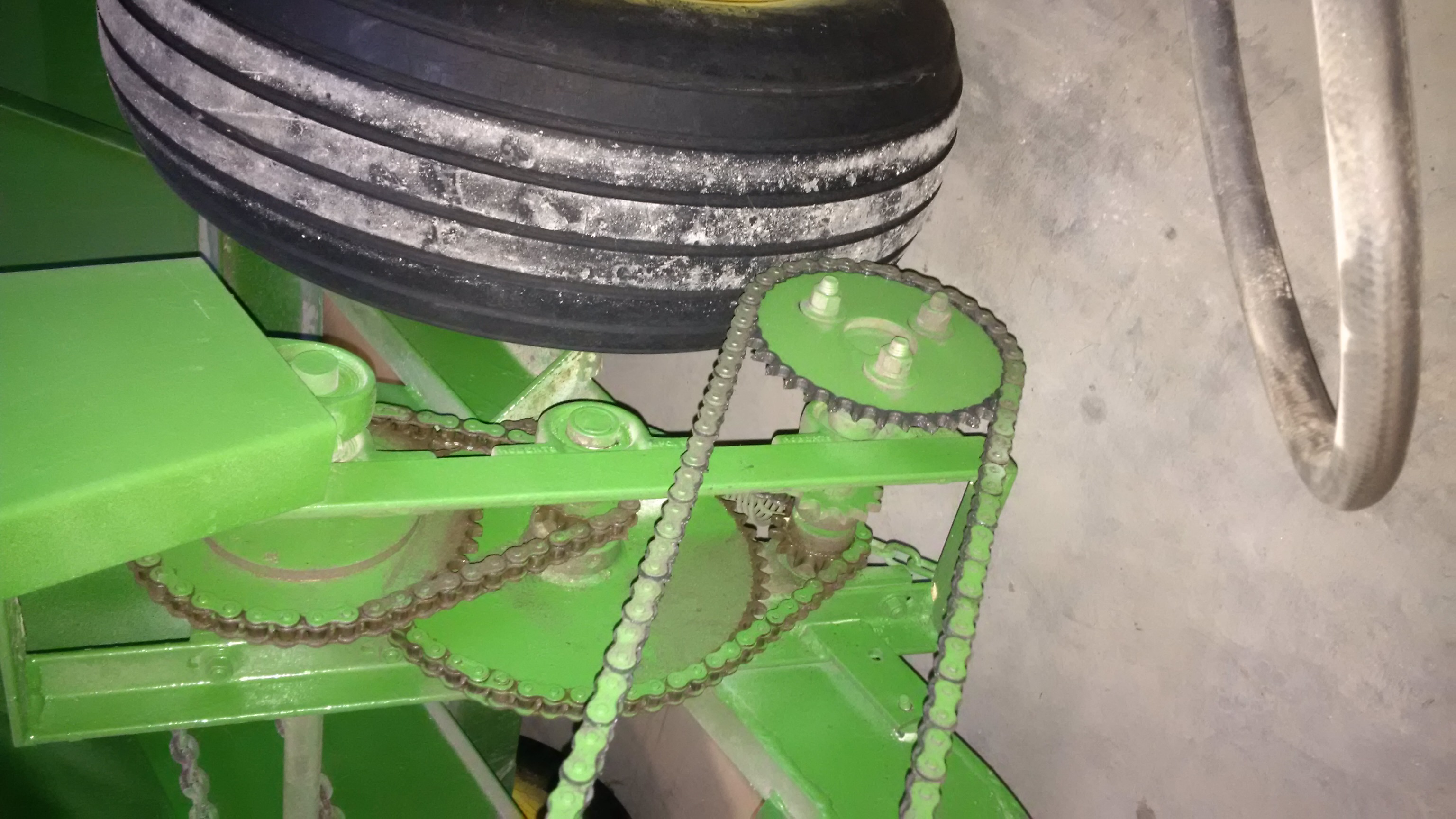

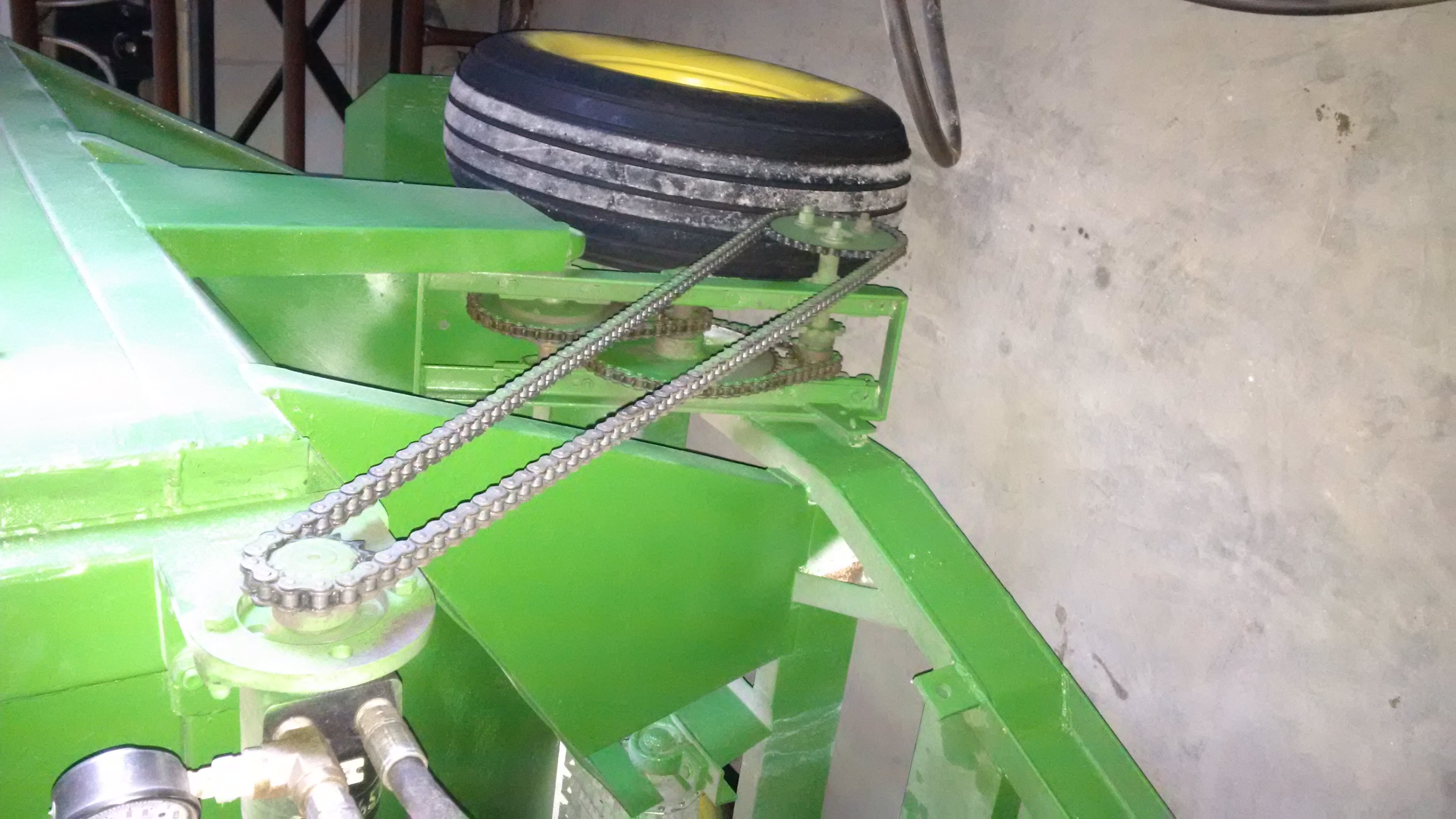

I was just looking through some old threads and I found I had not finished this one. I added a hydraulic drive motor to replace the ground drive system on an old fertilizer spreader. I ended up rigging it up temporarily by replacing the idler wheel that rolls on the main wheel with a sprocket and bringing a chain back up to the top where I had mounted the motor. I intended to shorten the chain eventually and still might because it was a mock up but the original springs that kept the idler tight against the ground drive have managed to keep just the right amount of tension on the chain that it doesn't come off even in some heavy bouncing. I will probably get around to making it more permanent one day. I put a pressure guage on the pump and it rarely gets above 600 psi while its working and I can control the rate with the hydraulics if nec. I didn't put a relief on it yet, just take my time starting and stopping the motor. I was painting another project so I threw some paint on this rusty old thing, hurts my eyes a little less now. Thanks to JJ for the help

No idea why the photos are sideways. It makes me giggle watching it work, either the stub axle has a wobble in it or the holes I drilled in the sprocket to attach it weren't centered because it has a slide slow off center wobble to it. This is one of the reasons I have left it loose with the spring tension, it allows for my "eyeball engineering". Maybe someday it will get new tires and a couple decals to match the paint. ;)
