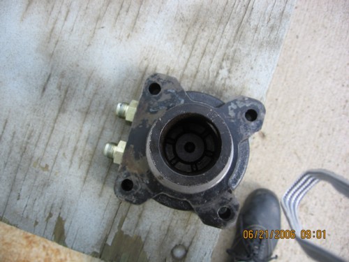

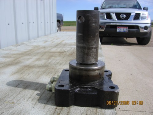

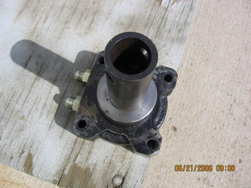

The coupler is a 6 inch long cylinder/pipe tapered with a key slot on one end to fit the tapered motor shaft and fastened with a castellation nut. Requires a special castellation socket to remove and install. The other half of the cylinder/pipe fits over the tiller shaft and is fastened with a bolt through both. PT will sell you the castellation socket for $60. I believe they would sell you the coupler but I don't know their price.

A couple of pictures of the coupler. The motor is disassembled and the coupler not removed from the shaft.

Thanks, that's very helpful, in case I need to fabricate something. I'll have four 12.5ci motors to find a use for -- they're a bit big for paperweights.
