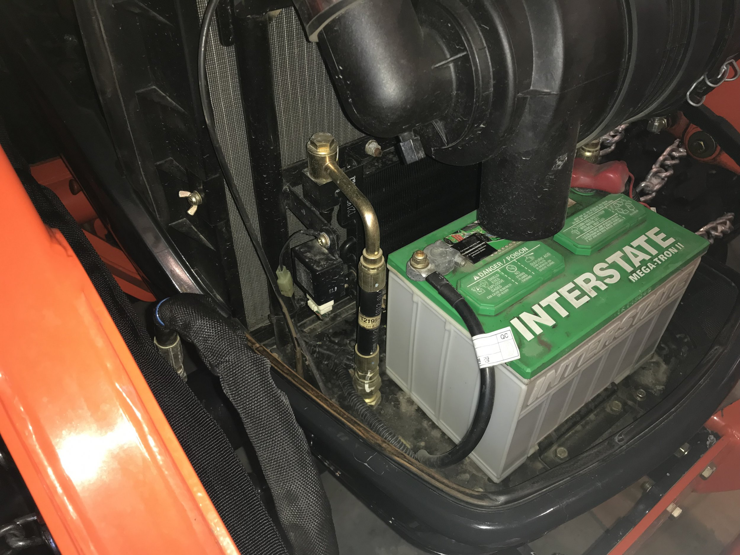

Dave, I know older Kioti CKs had a problem with trans cooler lines failing from vibration and fixed the issue with some redesign.
Here is a pic of my 2012 CK35 trans cooler lines (same left or right). This is how the tractor came from the factory. If your lines are the same could you please let us know where the leak is so I can keep an eye on that location.
If your cooler lines are different could you post a pic so we can see where changes were made.
Thanks Andrew.

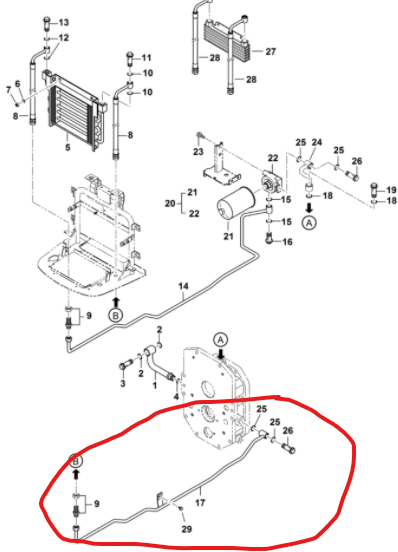

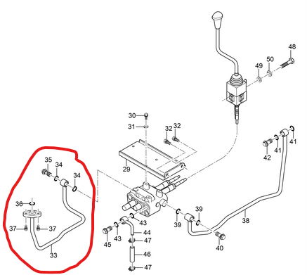

I'm reasonably sure that the front end of the cooling system doesn't have the problems I've encountered. I'll try to insert a couple of images that should be useful. These are from the Bobcat online parts catalog, and the CT235 is nearly the same as the Kioti CK35 (with hydrostatic transmission). Anyway, The first failure I experienced was in the Joystick Valve Group (FEL Joystick),
The tube in the image below labeled No. 33. The failure was at the double-o-ring connection, where the tube is welded to the connection boss.
The most recent failure was in the HST External Hydraulic Line Group, in the part labeled as No. 17 in the image below. Again, the failure was where the tube is welded to the double-o-ring boss.
Bobcat (and probably Kioti) recognized the problem and have changed the design of some replacement parts. For the joystick tube, I believe that connection now includes a collar of some sort that adds reinforcement to the weld area. For the long hydraulic cooling tube, they have added a mounting bracket to limit vibration of that line. They may well have also added the reinforcing collar to the weld between the tube and the double-o-ring boss.
As far as what to watch, I would consider ANY of those hydraulic hard-line connections that have the tube welded to the double-o-ring boss to be suspect, especially if the hydraulic line is long and subject to vibration. When they fail, the crack is so very small that it is virtually impossible to see unless the line is under system pressure. That pressure can be very high indeed, so caution is advised when searching for the source of an active leak... you don't want to have hydraulic fluid injected into a body part that gets too close to the leak.
I hope this helps. If you do find a leak, re-welding is probably a bad idea. It's nearly impossible to get the hydraulic fluid cleaned out of the crack, so you'd end up with a bad weld. As far as silver-soldering the joint is concerned, the joint gap is so very thin that I doubt you could get any silver solder to flow into it.
