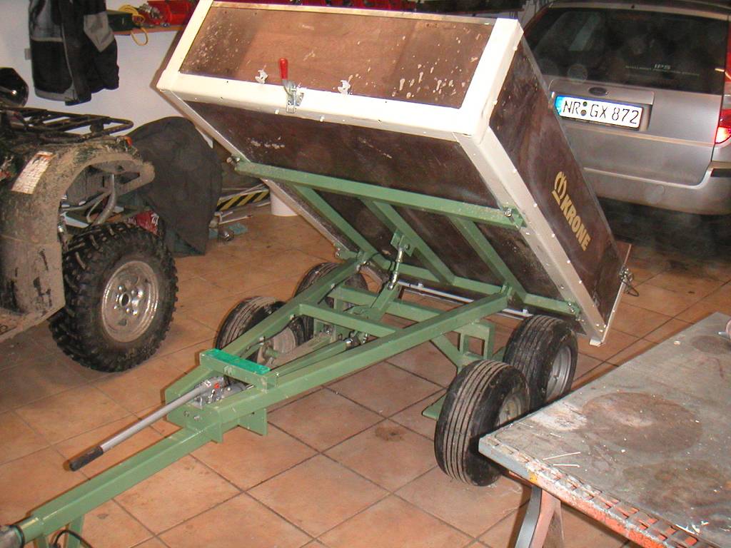

   / Hydraulic lift for powered trailer? #5
My friend has a powered trailer for Grillo 131. I think he has a hand pumped hydraulic jack. Sorta like a porta power where the pump is off to the side and a hose runs to a cylinder on the hoist.
   / Hydraulic lift for powered trailer? #6
I have mounted a hydraulic jack under the trailer. The power is transmitted via a lever.
Robert
Thanks for all of your replies! I need to change my settings on this forum, to automatically notify me of replies!
I do think I'll go with one of these hand powered systems. I'm sure I'll be moving gravel and other things that need dumping several time a year, but indeed not every day.
As far as a hydraulic pump, I still thinking about one, or a generator, but for powering external tools, like a branch chipper. However, I'm thinking it would be interesting to attach it to the other end of the Lombardini Diesel motor. There is a starting pulley (for rope starting) there that is just attached to one end of the crankshaft, and I don't see why an adapter couldn't go there to attach a generator or hydraulic pump directly (though it would have to be for less than the full 11kw of the motor because in the service manual I see that this end of the crankshaft is thinner, so can't transmit so much power).
