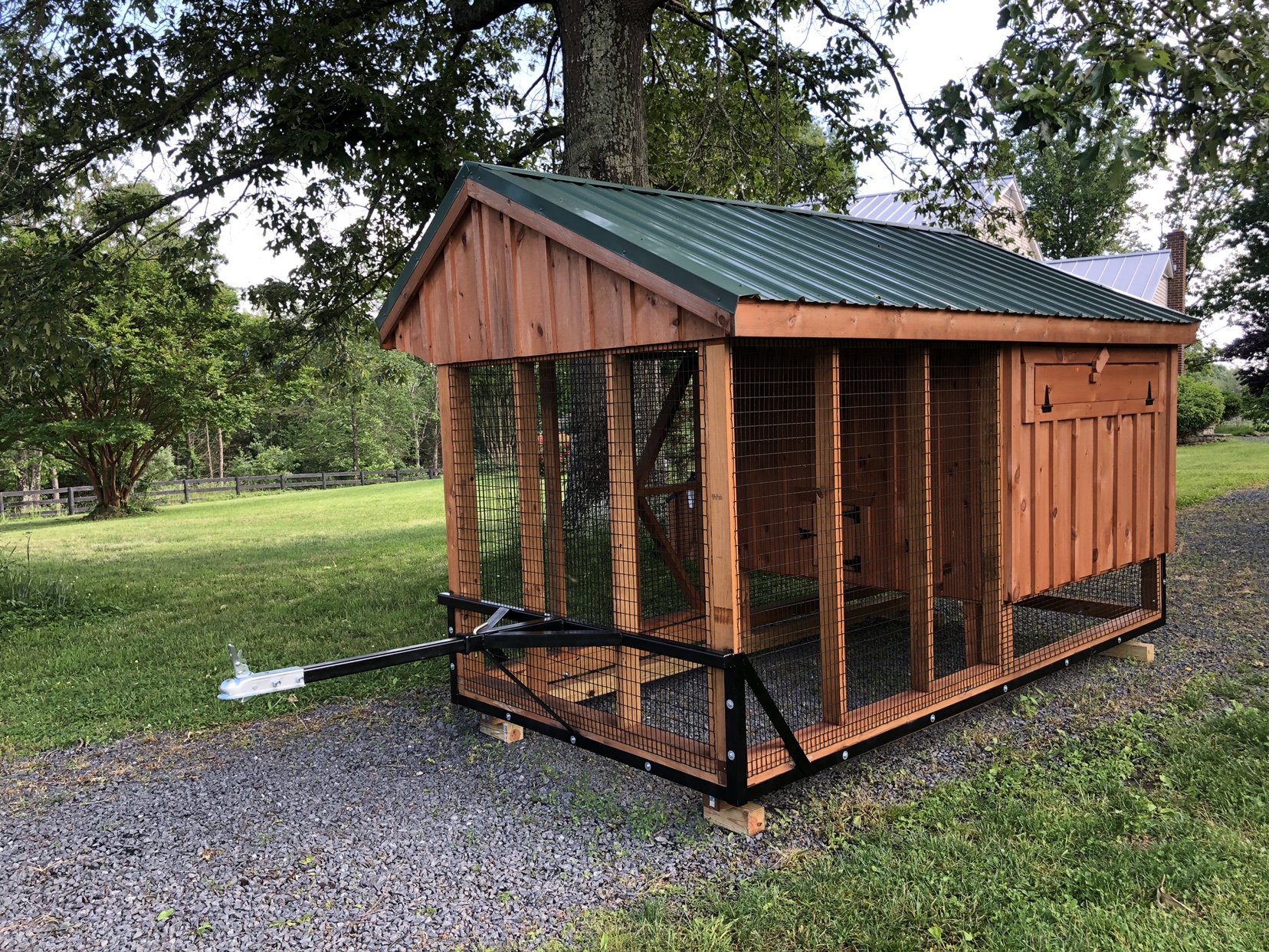

Howdy, I’m almost done building a chicken tractor for the wife and I need to decide on how to lift the chicken tractor onto its rear wheels. I’m debating between a hydraulic lift system or one using trailer jacks.
My question is: Is it possible to have a single manual hydraulic pump operate two cylinders simultaneously? Thinking of something like a hydraulic floor jack that you pump with a lever and it extends two cylinders. I believe I only need single stage cylinders, one on each side.
Coop is an Amish made structure, 6 x 12’ and weighs probably 1500lbs. Trailer hitch on front to be lifted by tractor 3pt and moved around like a trailer.
Will provide more pics of lift mechanism as I near completion.
Thanks!

Thanks for the replies. I’m already committed to the wheels and their positioning since I already bought the steel, wheels, spindles, bearings, etc. and I’ve already fabricated some components. I’ll take more pics and provide them so that you guys can see how it’s coming together and help me make the final decision on how it’s going to be lifted.
I considered trailer jacks but then I’d have to do a lot of hand cranking for both up and down and then also on both sides if I used two. Still an option, just thinking through it.
This thing has to be moved once a week with a Ford 8N with no rear remotes or loader. I have a ball hitch setup on the 3pt.

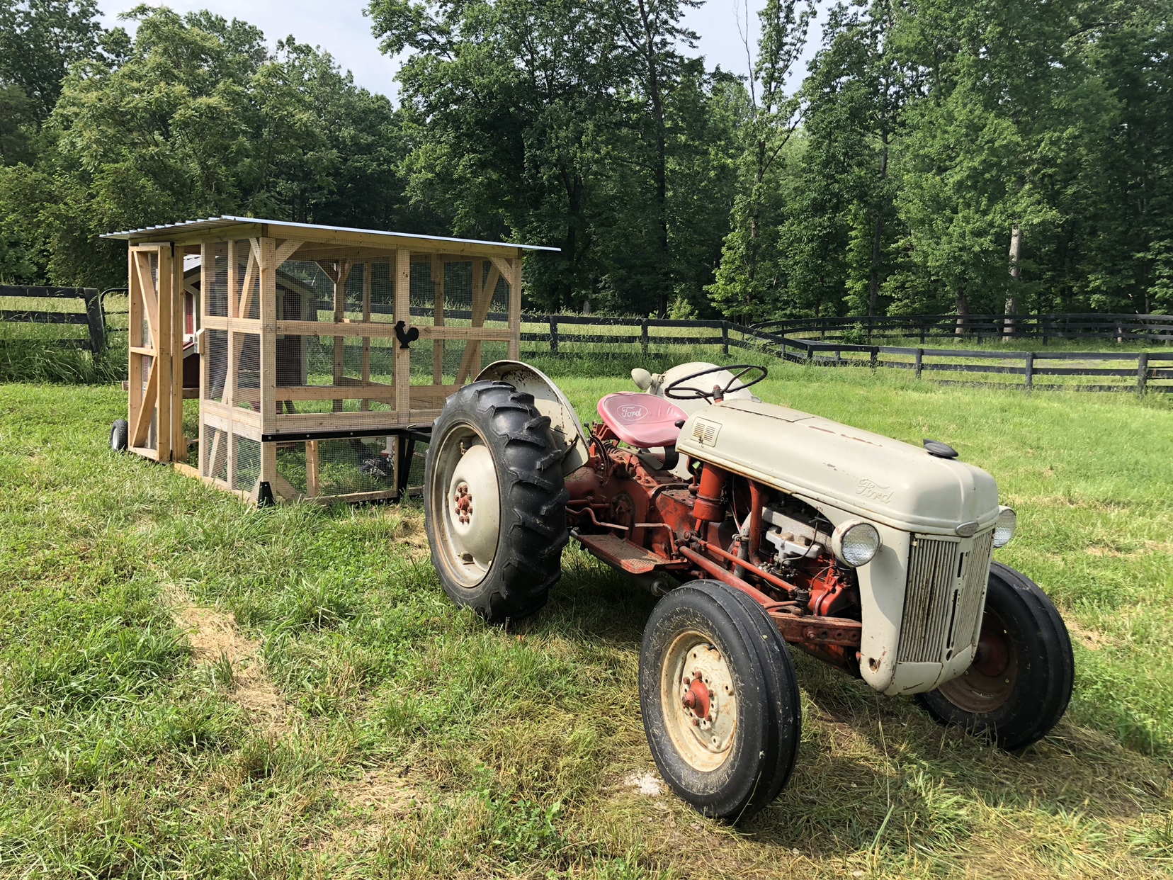

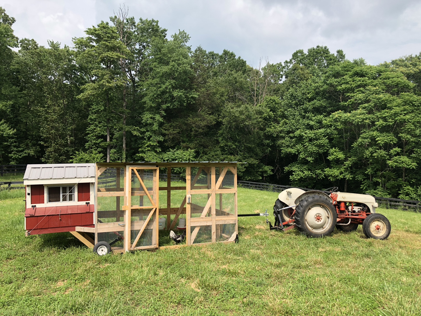

Chicken tractor v1.0 is below, this is chicken tractor v2.0.
