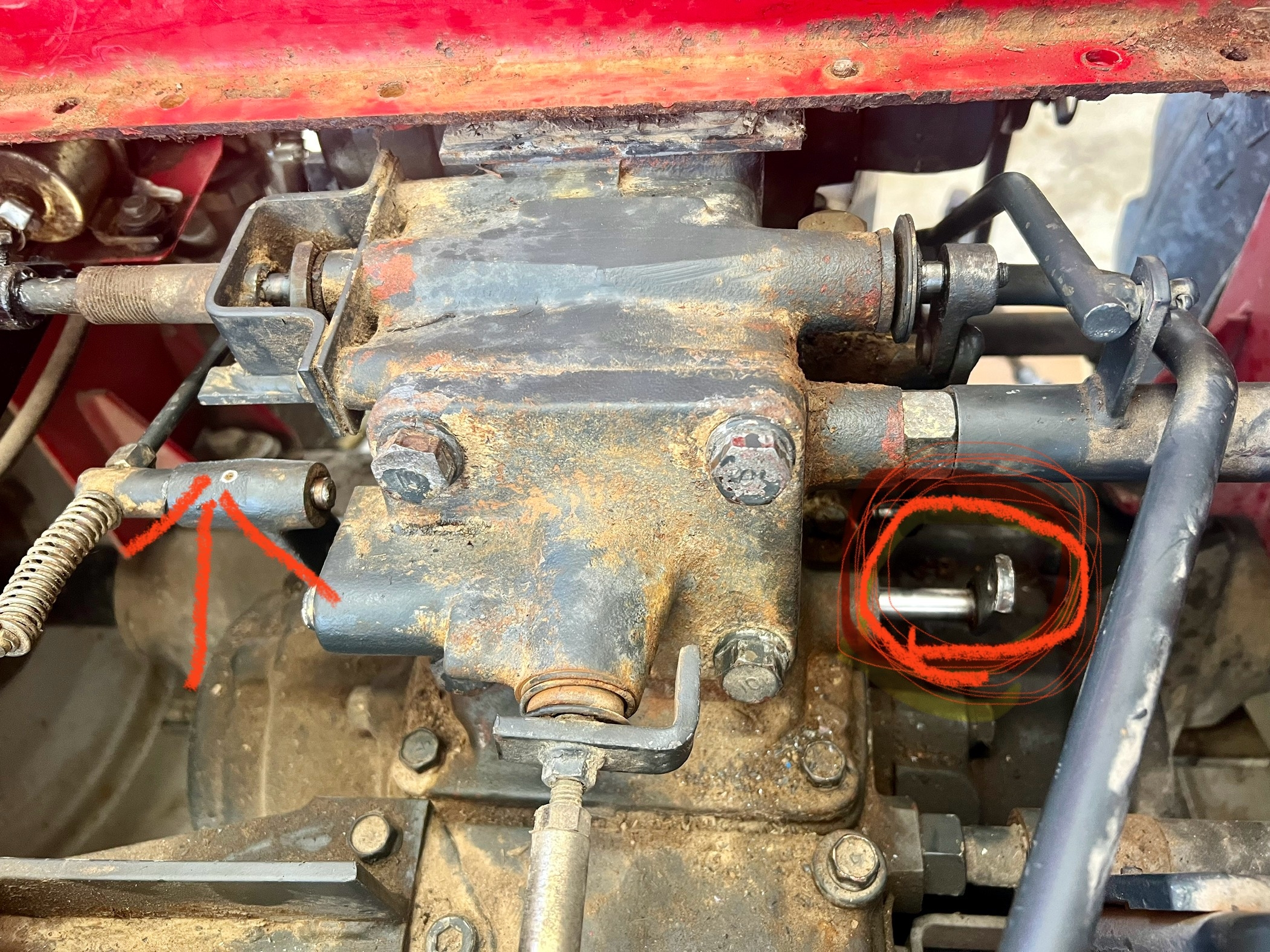

Mahindra 2615
I have a Mahindra 2615 and it continuously got harder and harder to lift the 3-pt hitch. I took it apart and greased all linkages. Now this part on driver left pulls out about 1.25 inches. When pushed back in it does not seem to engage. Moving the control lever on the right side has no resistance. You can manually lift the three-point hitch by grabbing the large control arm (arrow) that would be underneath the seat. Once you let go of it, the three-point hitch slowly drifts back down again. I have attached a picture here. Is
this Rod broken (in circle) or does it need to be properly aligned? Thanks for your help.

Good grief, another filthy tractor. Do any of you ever wash them? I like the corrosion as well....not. Mine are always clean and get washed regularly and I farm with mine.... Something is obviously broken off. You have a manual for it perhaps, that would help.

I do wash my tractor it’s just in between washes right now. The corrosion is from a cat. We had to decide to use my seat to go to the bathroom on.
