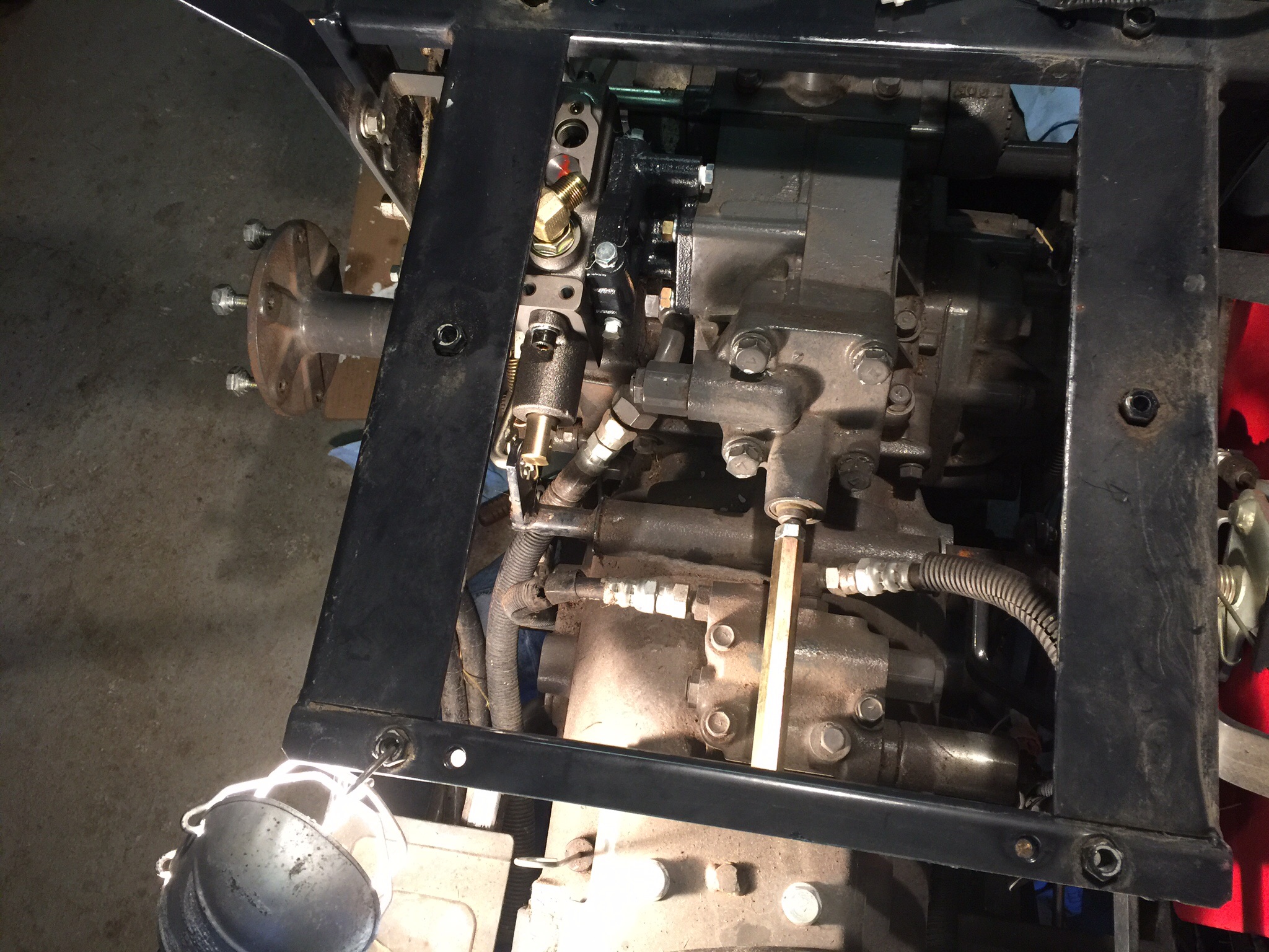

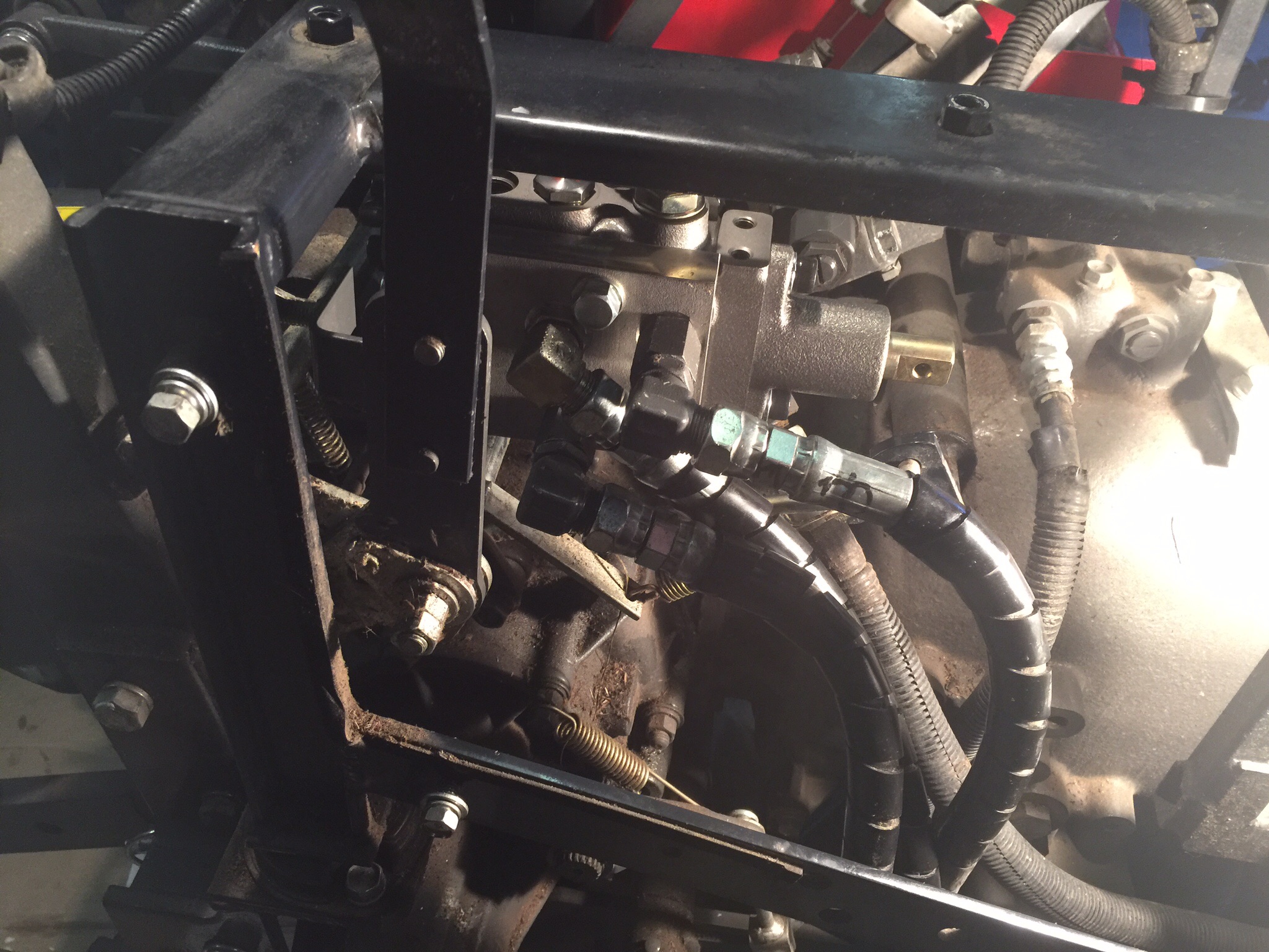

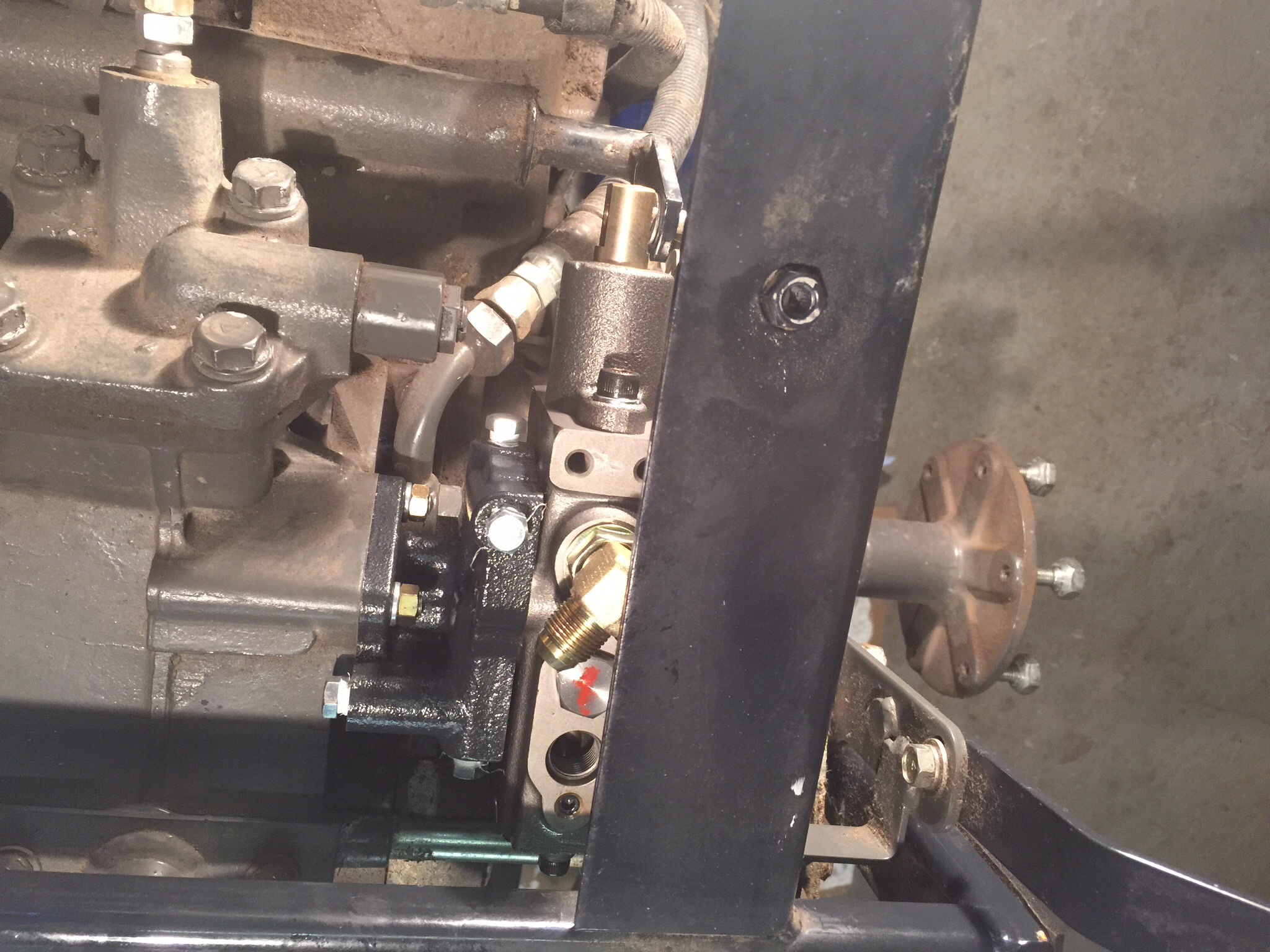

Ok, guys I am a little slow to react lol, I did do work myself, with useless instructions, remotes go into top of new valve then out back, loader kind of acts like it wants to work, but rollback or lift function doesn't work, went to dealer copied loader line hookup off new 1526 that had valve installed, all parts an lines seem to be installed same as mine, but no one at dealer had tried remotes to see if they work an no loader on it just 3 quick connect lines, I have a few pics I will post
   / Hydraulic issues
Here goes, removed loader lines manifold block from top right side of 3 pt hitch, discarded manifold, installed 3 studs in place of removed manifold block bolts, installed new manifold block on studs, installed new control valve + loader line plate ( separate piece) onto new manifold block with bolts thru loader line plate & control valve, removed 45 angle fitting from middle loader line, replaced with 90 ( other 2 were 90's already) installed 2- 90's in top of new valve, hooked up remote lines. Changed hydraulic filter & oil plus cleaned suction screen, bled hydraulic system by tractor manual. New valve seems to work, 3 ot hitch works without weight, no functions on loader work. That is where I left it an came to work for 3 weeks. Of course dealers want me to bring it in for 65 bucks an hr. I was trying to pickup some pointers from u guys to try when I get home. It's a new tractor practically 60 hrs purchased in May 2015
