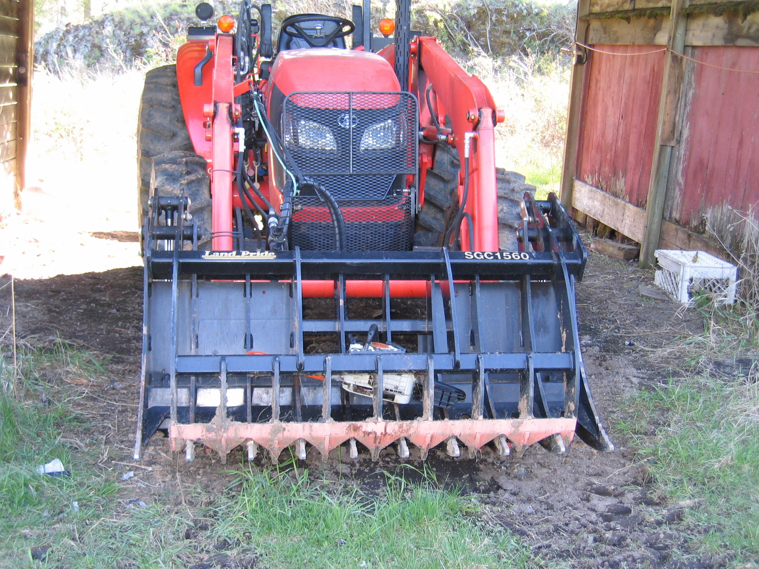

I use nylon spiral hose wrap and bungee chords. Bungee chords need replacing every two years or so. Nylon spiral hose wrap will last forever. I get the hose wrap at - House of Hose - Spokane, WA.
If you look closely you will see both the hose wrap and the bungee chords. Hose wrap sold by the foot. As I remember around $0.75 per foot.

I have long hoses on a grapple to fit 2 different size tractors. I coil the extra hose to take up slack and use the big zipties to fasten. Tarp strap provides enough stretch to keep hoses in a safe zone.
The couplers are attached firmly to the crossmember.
The spring coupler looks like it will work but may not hold up to hard use. Coupling may not be as easy with no resistance to shove couplings together enough to lock.
