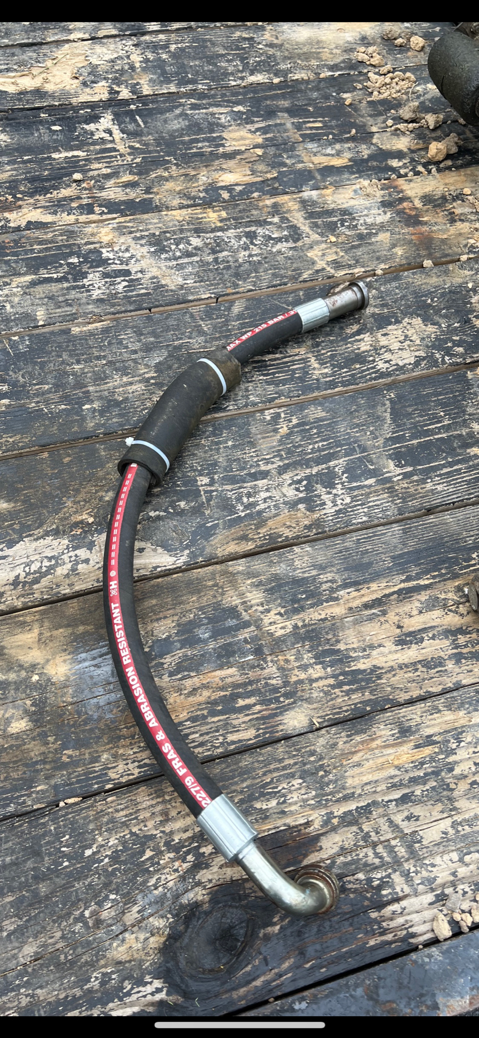

Contrary to popular belief most hydraulic hose fittings are reusable. Here’s a new hose with old fittings. I only had to buy new collars for $10 each vs $50-60 for an end. Although that’s really only a viable for larger hoses. Tractor FEL size ends are too cheap to bother.
