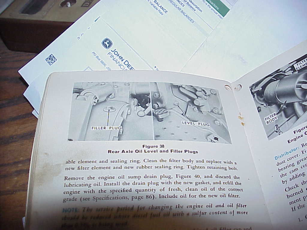

We recently purchased a Ford 5000 with a loader (1970s model?) and we are having some trouble figuring out where stuff is. My husband thinks he needs to add hydraulic fluid, but doesn't know where to add it. He also thinks he needs to add transmission fluid but doesn't know for sure where that goes either.
We have looked online for a photo, diagram, etc, but everything is so expensive or is not helpful at all. Can anyone help us with photos/descriptions so he will know where to put the fluids?
Thank you in advance.

Welcome to TBN
Maybe you should consider purchasing an operators manual for your tractor? Diff housing is hyd oil reservoir. I have a used 5000 OM I'd sell for $20 + postage. Maybe this photo will help

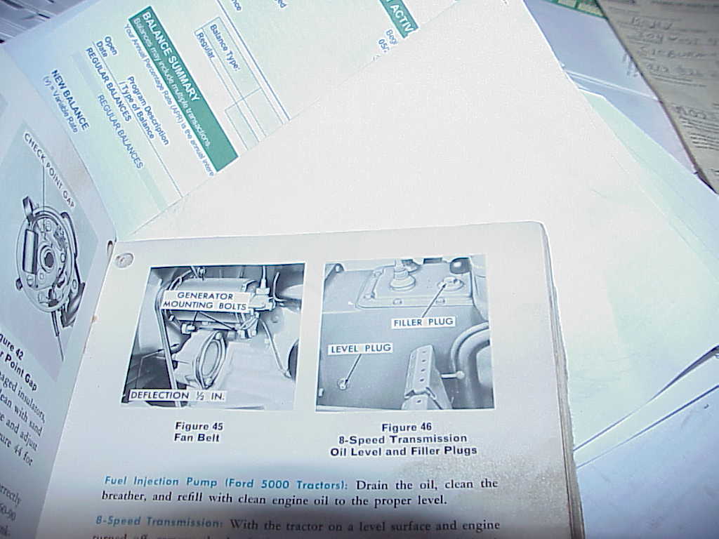

Trans oil check
