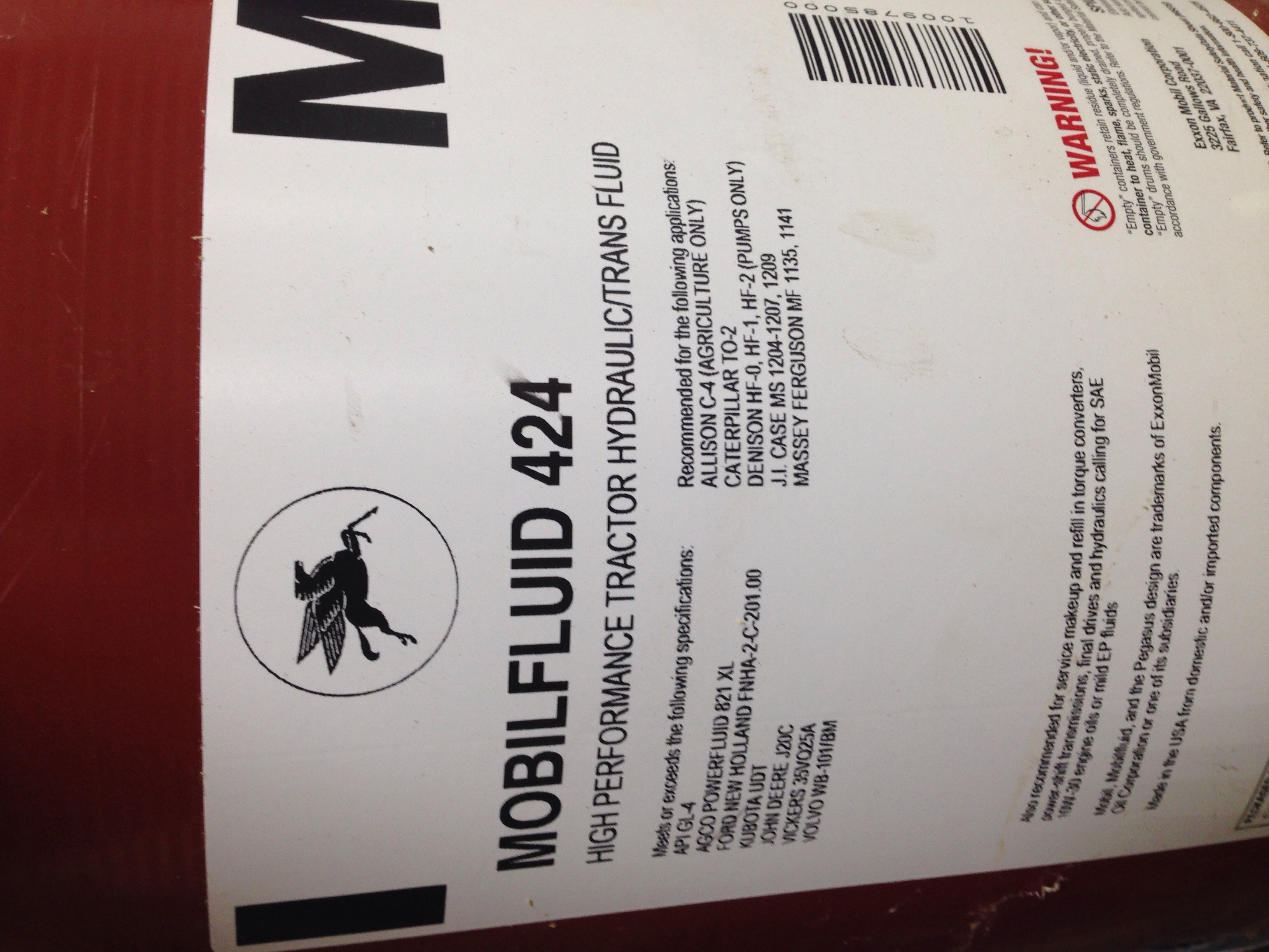

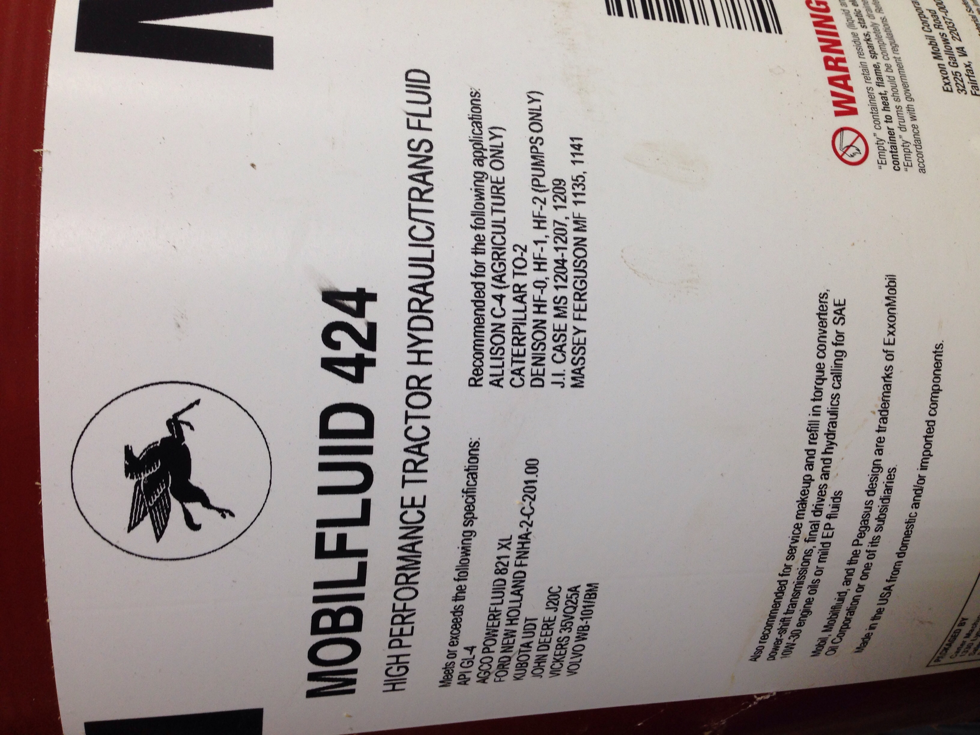

My manual says that I need to use AMBRA MULTI G134 hydraulic oil in my 2002 tc24D. Is there anything else that is compatible to it? That I could pick up at tractor supply or Napa. Just wondering because I don't live no where close to a new holland dealership.

Dunno, but it would be more expensive. Don't get the 303 marked TSC fluid as it's for much older tractors.
this works for about everyone, including me.

This is what I use in my backhoe.
