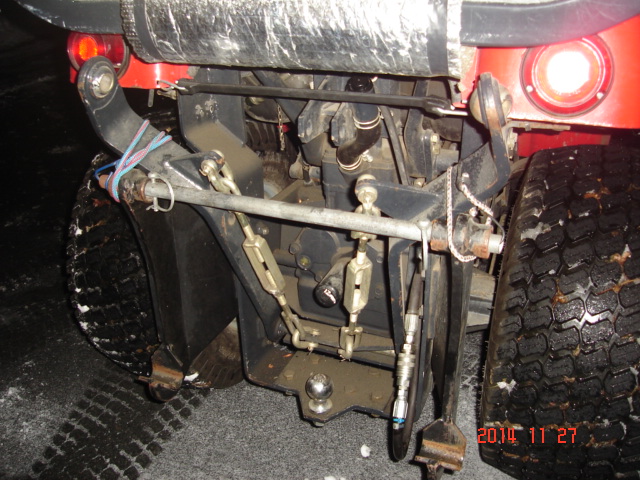

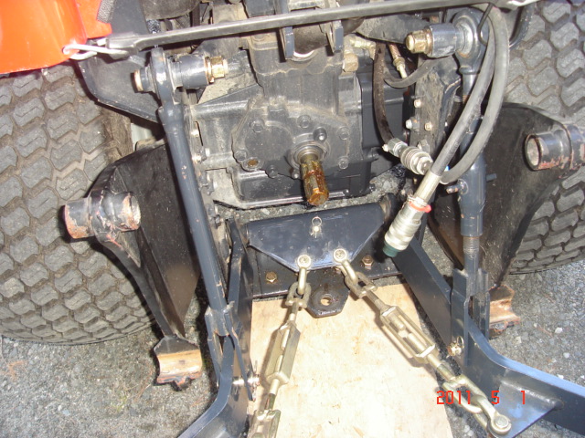

Phil, there's the window, just to the left of the rear PTO output shaft. Fill point is at top, at the end of the rubber extension tube. Yes, a screw-on cap.

I really didnt know if i was low, it was about 3 to 4 inches down. i know with old tractors, that it should be filled to the top, and that it leaks out of one the spools, i knew it was down, just didnt know much, thanks for the photos. yesterday i ordered a on line service manual for $ 29.00. it is pretty good, hopefully i will pull some good information from that.
