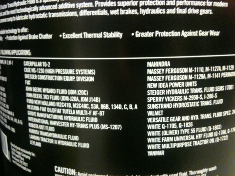

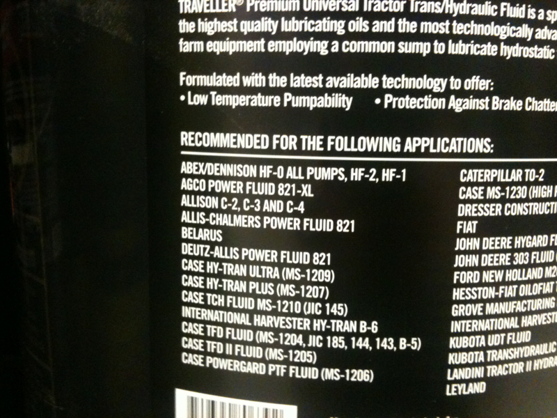

Will someone please take a picture of this label and post in this thread??? Please......:thumbsup:

I check my bucket for you though; does not list cub cadet, does list Yanmar, but does not have any nos. after it.
Walmart also sells tractor hydralic/transmission oil (probably the same manufacturer) I do not have their bucket here, but would likely have the mfg brand applications on th back label like TSC

TSC $40 / 5 gal

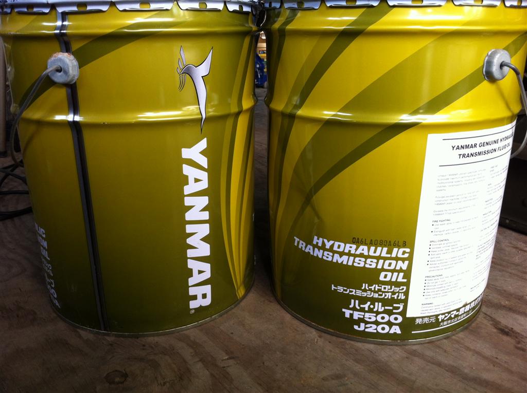

I recently came into possession of two buckets of Yanmar branded hydraulic/transmission fluid, it clearly indicates TF500 is the same as John Deere J20A, which is seen in the label pictures posted above. Just thought I'd post it to support what the others are saying about UTFs.
