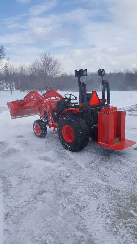

A digression..............How do you B2650 owners get along in the snow? What tire tread do you have and do you use chains? My B2620 with R4 tires needed chains to perform in snow.....but the BX2660 with turf tires did not. Now I have the B2650 with R4s but no snow to test it yet.

I live in the snow belt in NE Ohio, and my B2650 with turf tires plows snow great. No chains needed. I can push snow right over the top of the bucket if I want to. 20160112_121243 (450x800).jpg

My B2650HST has R4 tires. I can move snow with the bucket on paved driveway and it will slide around if I get too much snow in the bucket. I do have chains but don’t use them any more because I have the rear blower and there is no problem blowing snow.
