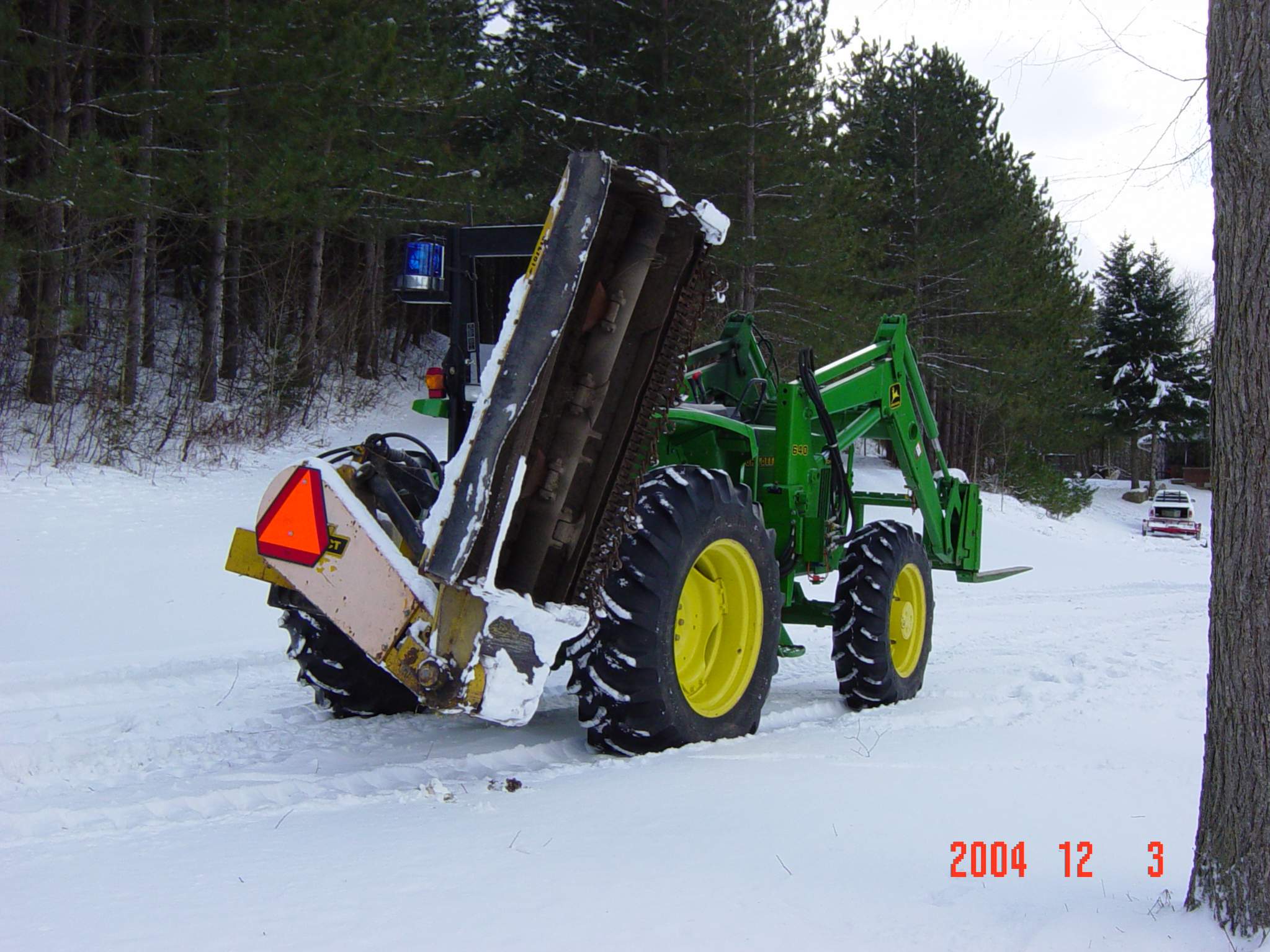

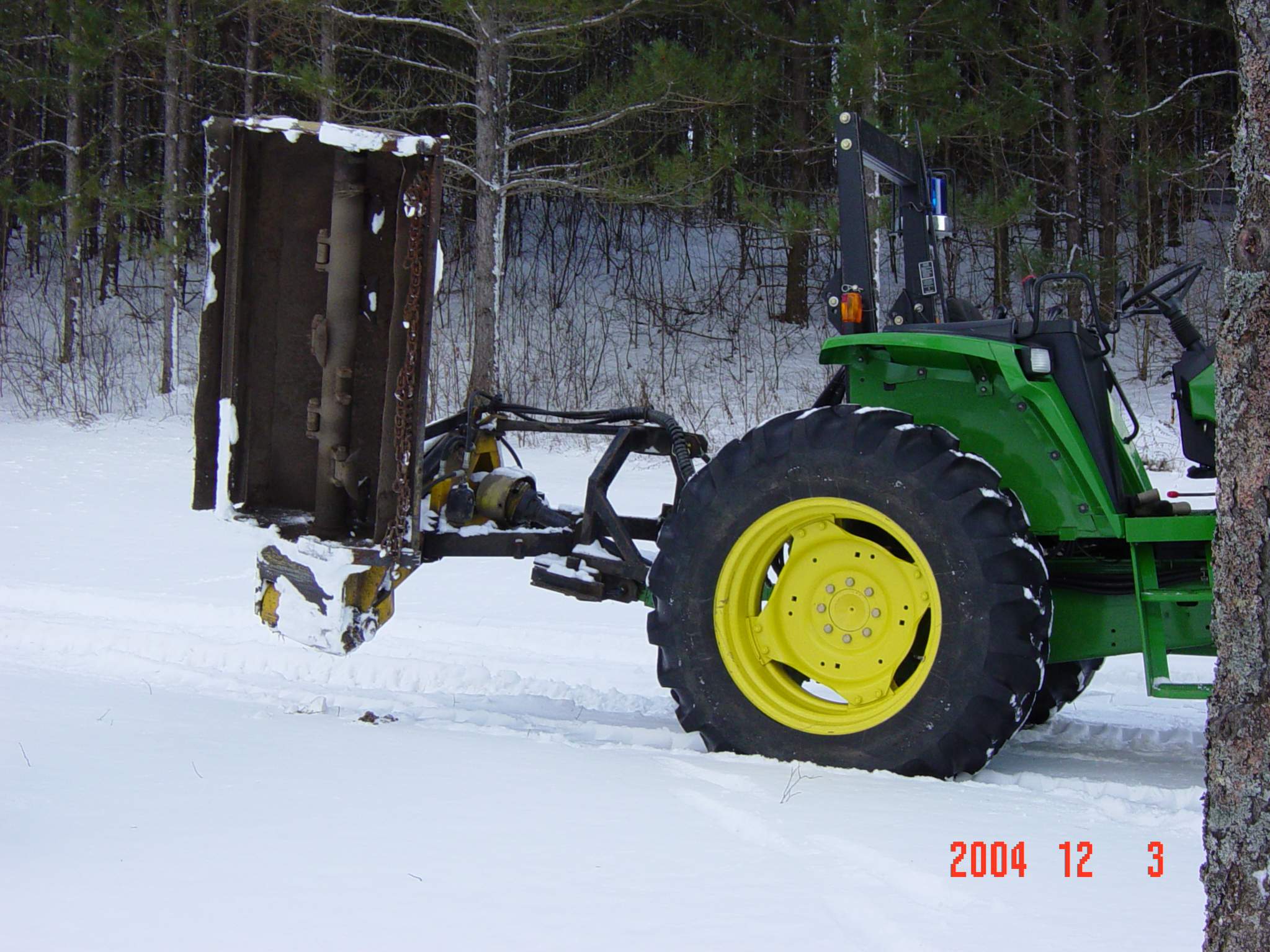

I have a 16' Alamo Flex Mower with shaft drive. Often thought, if hydraulic would be better. So I can only comment on the rotary mower. I can't use the machine up, only down, with the shafts in their proper position. I can't select only one deck. Plus I have to service all the U joints. On the other hand, shafts are more efficent and may run quieter and cooler.
Oh, I do have some 917 Flail mowers. Sometimes I forget all the stuff I have! Oh, and a Perfect offfset flail type mower, but it has ten pound cutting hammers. Maybe that is the machine I should be talking about. When it is at the extreme of it's sideway travel the joints do protest and I don't like that too much. Hydraulic would probably be better. DSC00485.jpg
Sorry, I put up the wrong picture and can't t seem to be able to remove itDSC00484.jpg
That's when I first bought the machine. It was missing the back roller which I ordered and also sandblasted/painted the machine.

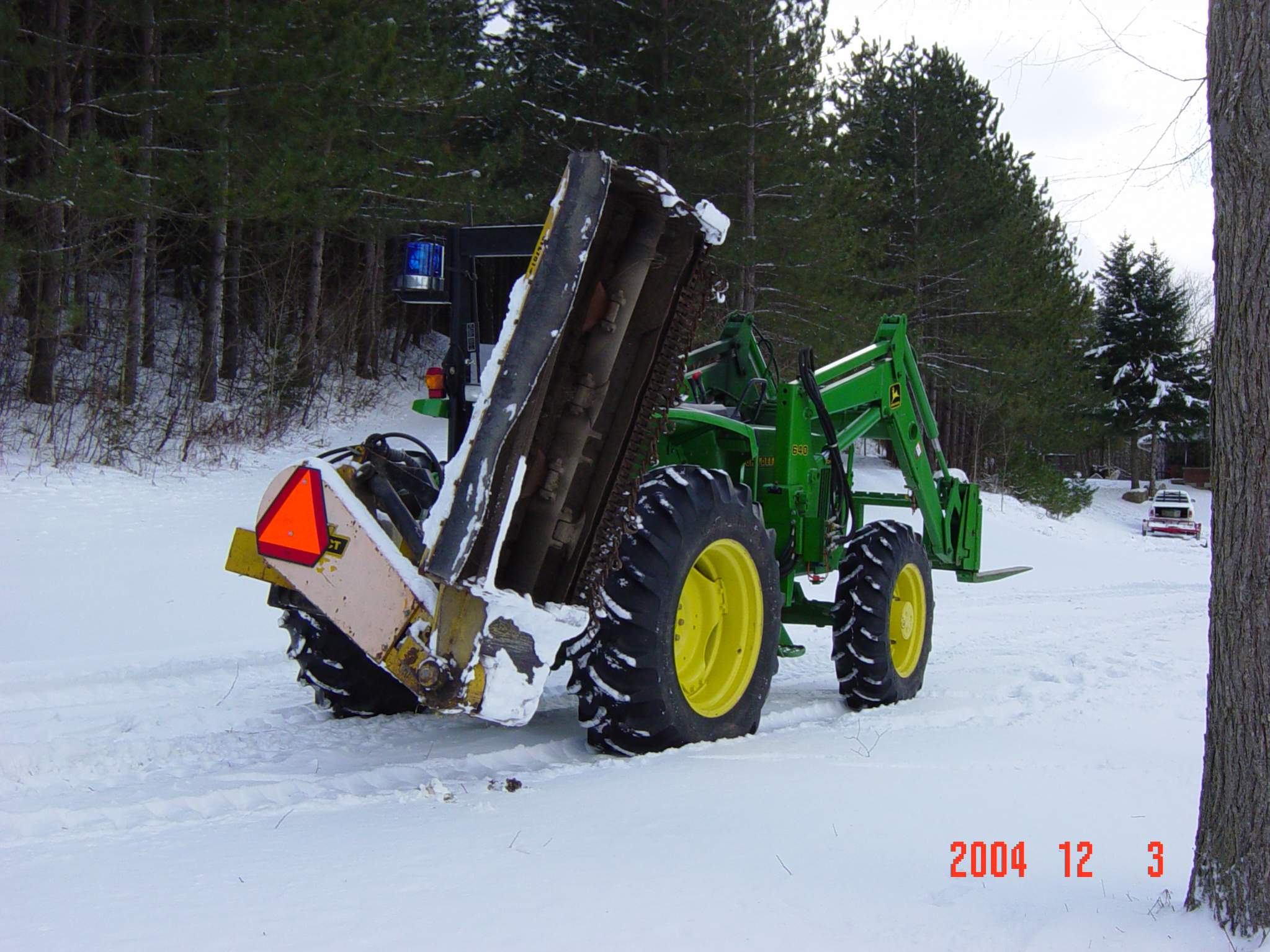

Oh, I do have some 917 Flail mowers. Sometimes I forget all the stuff I have! Oh, and a Perfect offfset flail type mower, but it has ten pound cutting hammers. Maybe that is the machine I should be talking about. When it is at the extreme of it's sideway travel the joints do protest and I don't like that too much. Hydraulic would probably be better.View attachment 356322
Sorry, I put up the wrong picture and can't t seem to be able to remove itView attachment 356323
