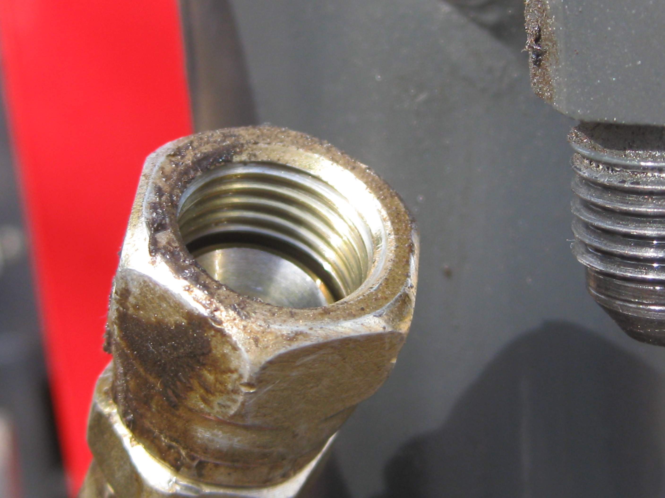

Ron, can you post some pictures of the fittings so we can help you identify them please? Most fittings are standardized so we really dont need the OEM of them, but we do need to know if they are NPT, ORB, ORFS, or JIC style so we can help find what you need.

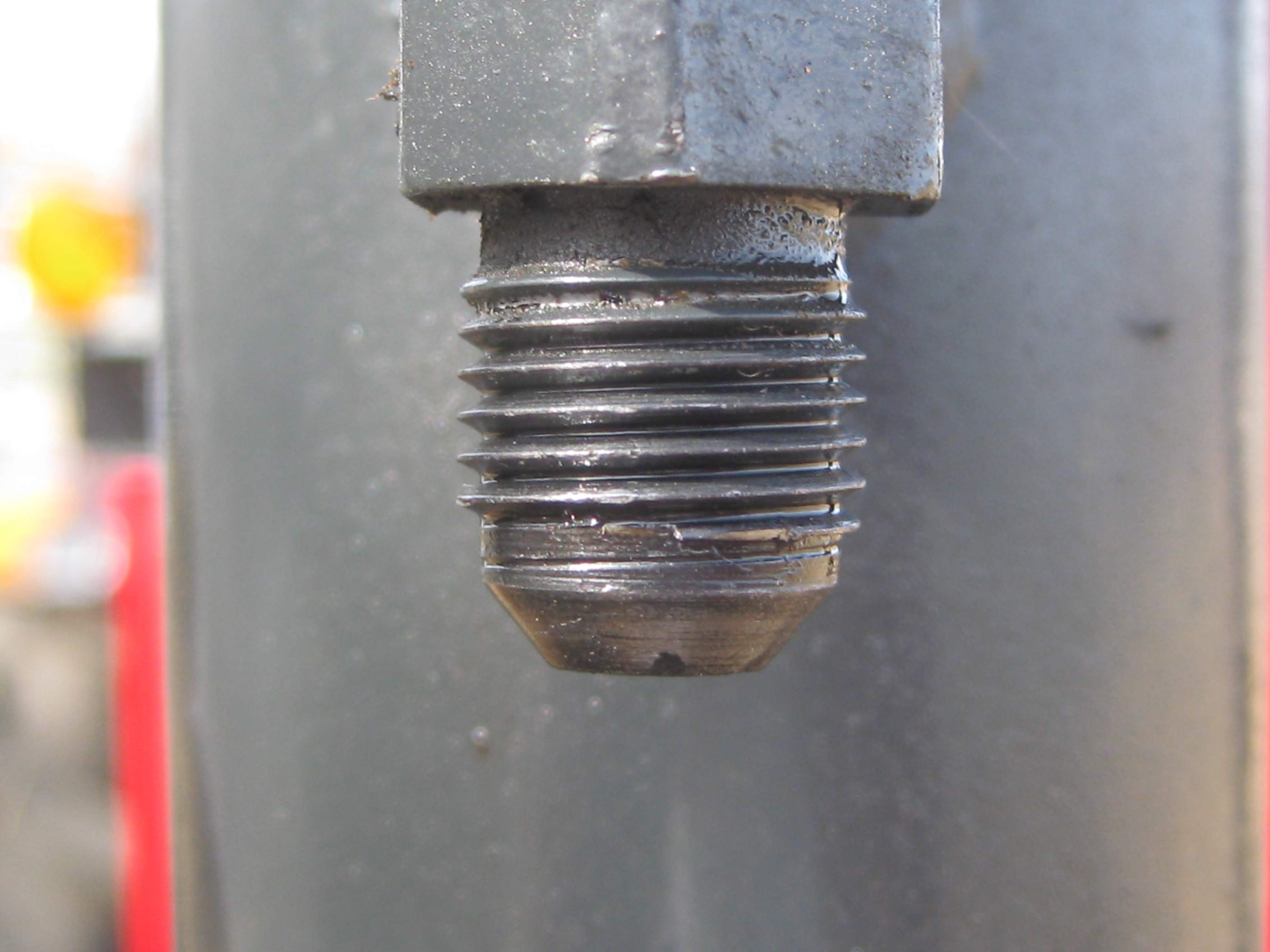

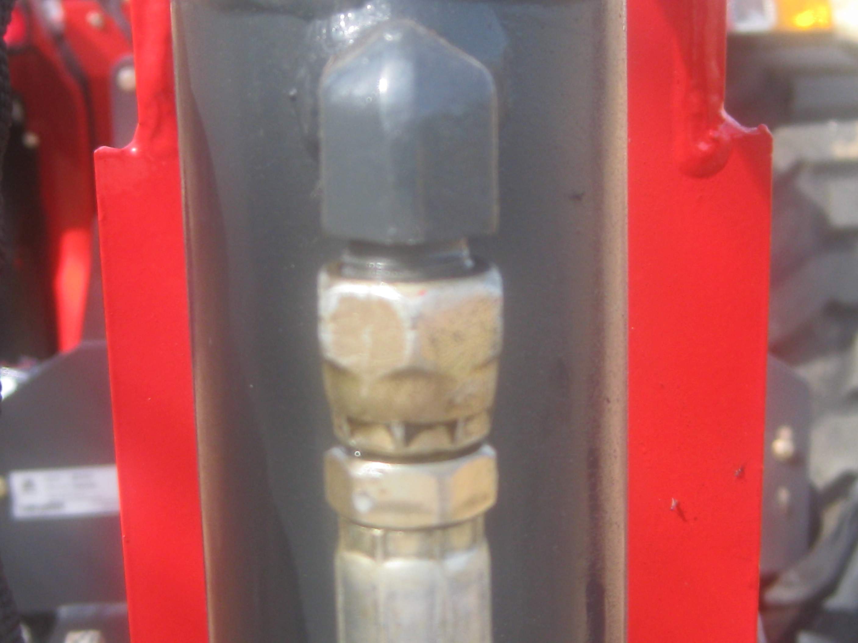

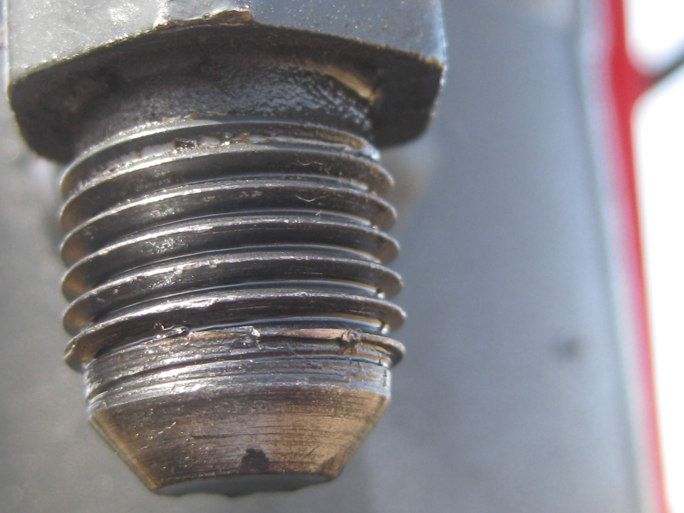

Here are 4 pictures. It looks like a JIC 37 degree (1/2-20) I'm still guessing LOL

The pictures are for the 1/4" hose.. I didn't see any 5/16" hose size ones.. need to check the hose for numbers

OK, So what do you think the thread size is. My hose on this is 1/4" for sure. the feed goes down past the fitting and "U" back up to fitting. Im thinking it might get a lot of movement at the fitting, so probably a straight fitting to lengthen the cable out a little wouldn't hurt in addition to the new end. I'm sure I saw some of those. I couldn't find my metric wrench for the female fitting so used my 3/4" which was a little loose maybe 18mm or 19mm?
I just looked at the BH and I think there may be some 5/16" hose also. I just bought the TLB but the hoses only have about 135 hours on them or less. they look brand new as the tractor has been stored inside. Its a 2011 bought in early 2012. I just want to get some reusable end fittings and coupler splice fittings to have on hand. Its OK when I have it in town but when its at my remote cabin its a pain to get anything part wise as its a 2 hr. drive for good part selection. 2 3/4 hr. drive to nearest Branson dealer! so don't want to make that trip to often.
