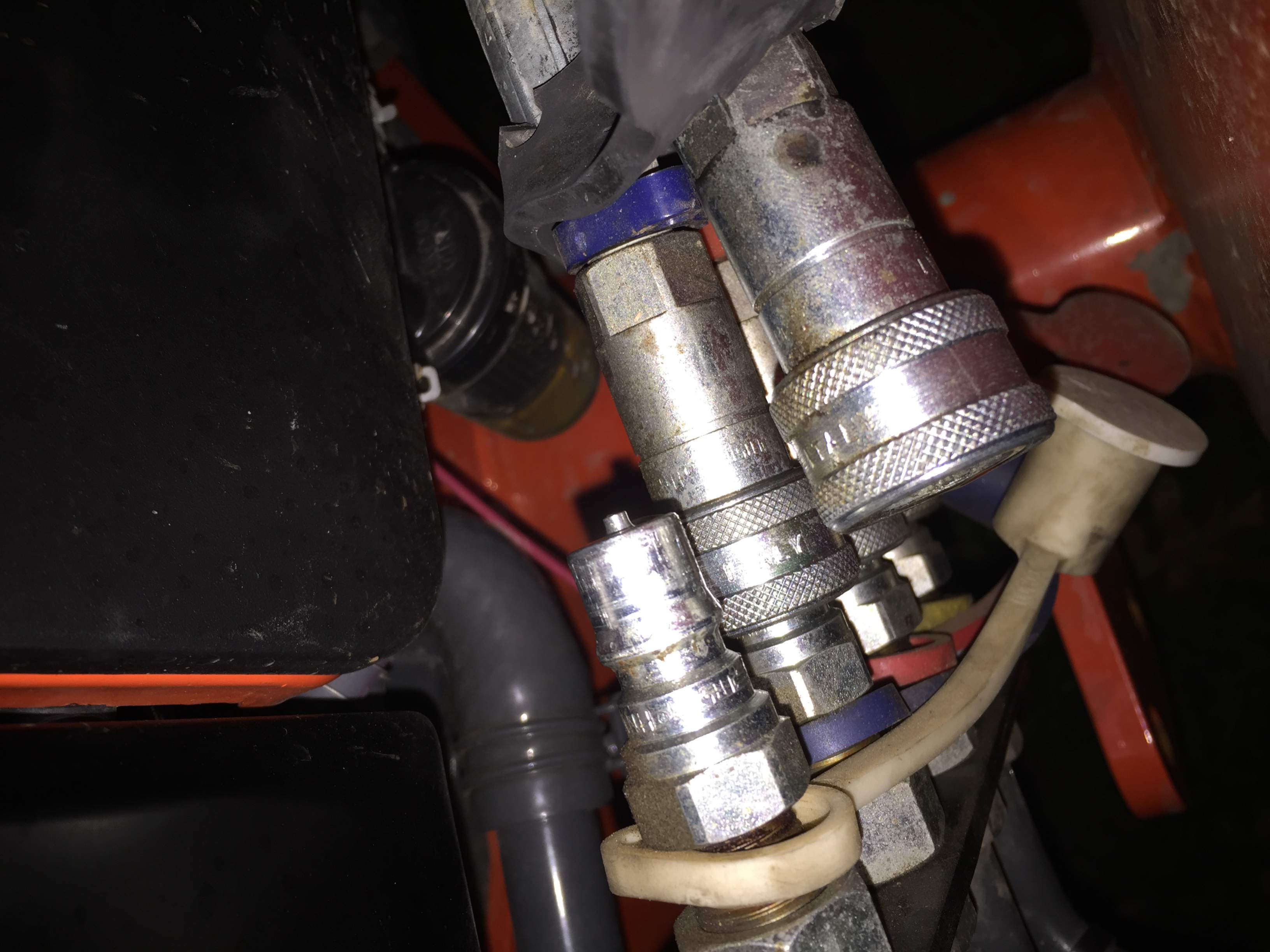

So I bought a skid steer style mount plow for my FEL, I also have the 3rd function valve so I can adjust the angle of the plow. But I have to come up with the hoses and fittings to plug into the 3rd function ports. What kind of female/male connectors do I need? I measured the current sizes of the hoses and fittings and seems it may be 1/2 NPT throughout?

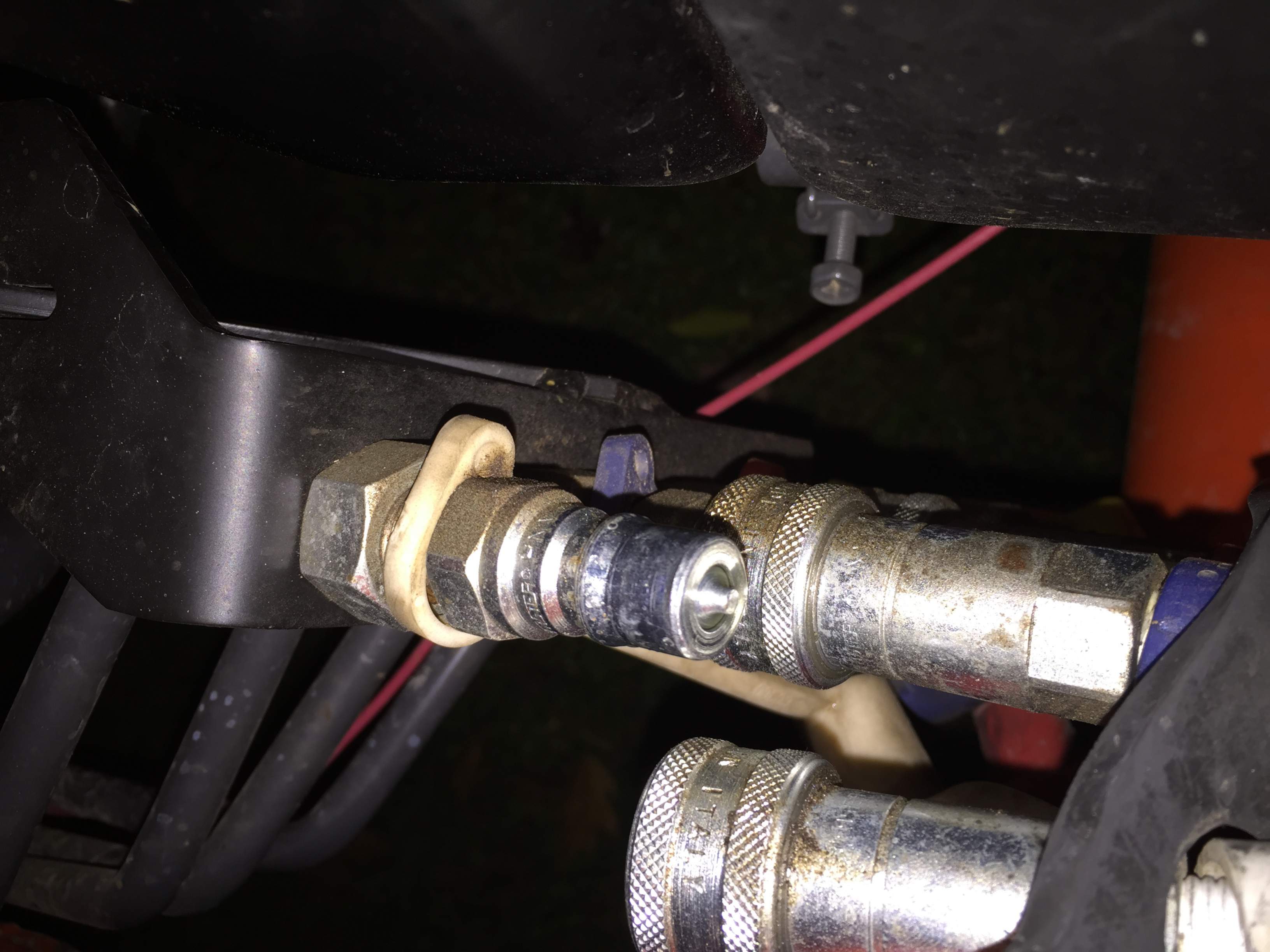

So here are some pictures I grabbed last night of the connectors my FEL is using. Wouldn't most all kubotas use the same connectors? And I realized, the 3rd function valve kit is a WR Long aftermarket, so does anyone know what connectors that kit uses?

Well just going by your pictures, I went on the WR long website and found a picture that looks very similar, no other valves on their "spare parts" page look like yours. Yours look like a push to connect fitting with the ramped ring on it. The standard 5675? I don't think are like that, you have to slide the coupler open to connect them. Anyway, here is the page.
Left hand column almost all the way down. "Hydraulic Quick Connects #6"
Spare Parts
That's about the best I can do, maybe call them as I don't know what type of coupler that is as there are quite a few different styles..
