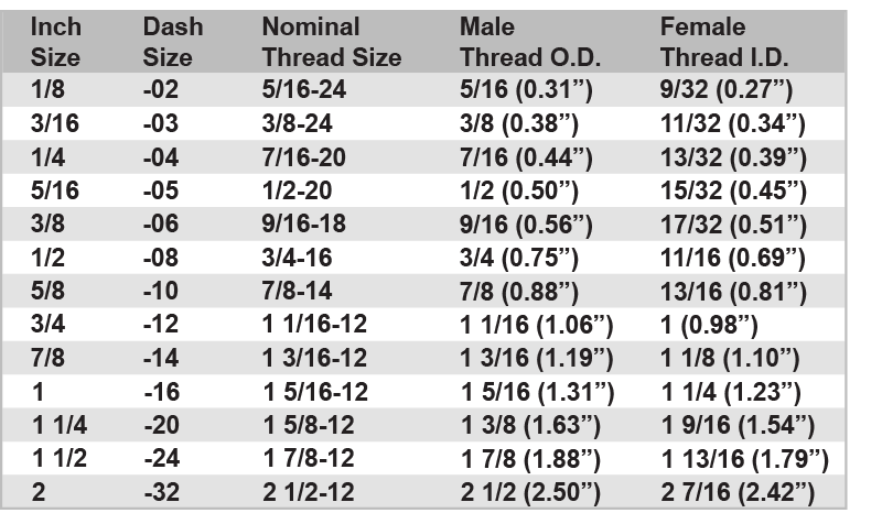

No help here on anything M-F specific, but most cylinders for other USA brands are ORB or NPT.
Here's a size table for ORB, you probably already know the numbers for NPT:
