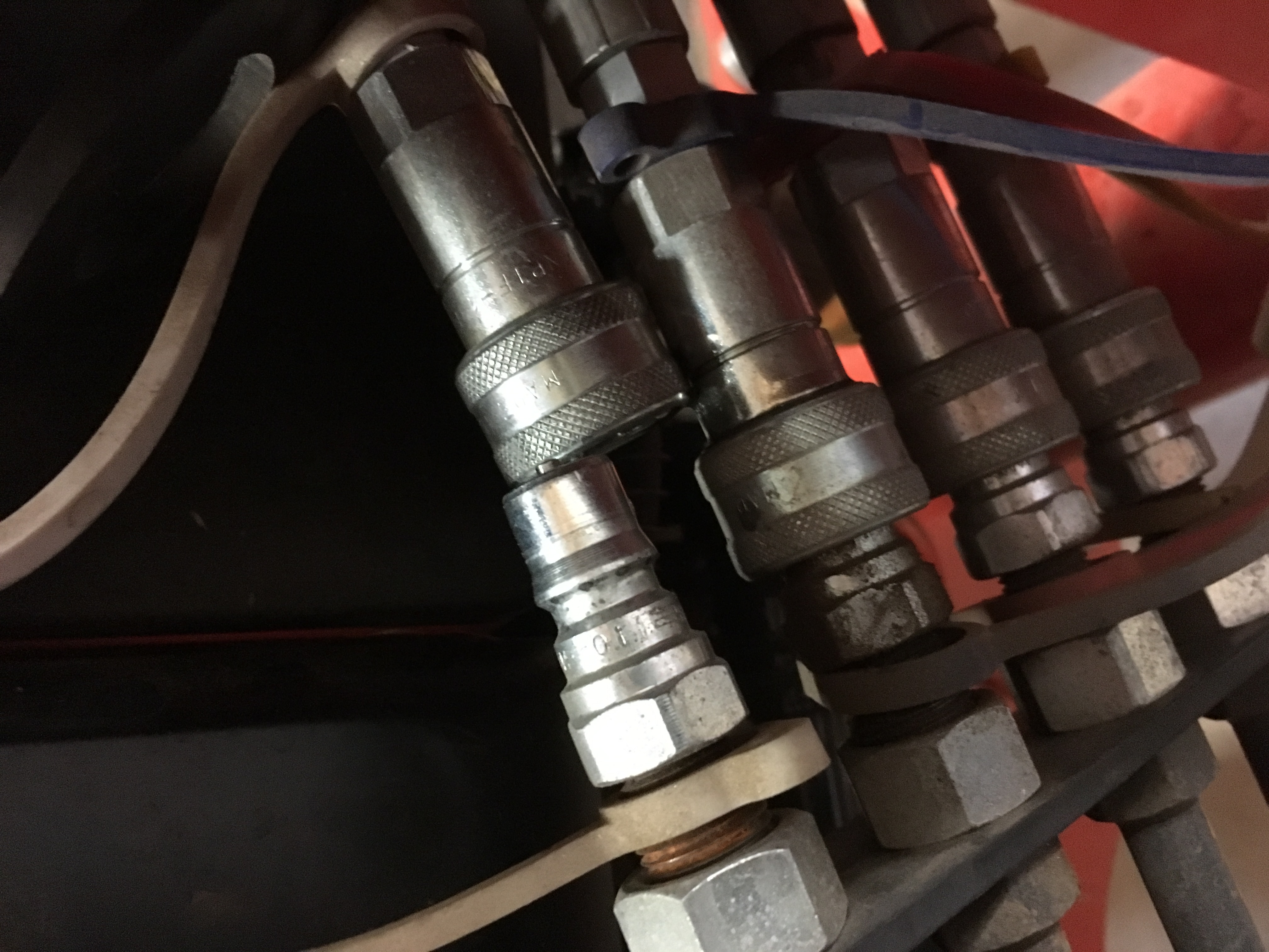

I recently purchased a pressure gauge from BXpanded to check my hydraulic pressure on my B3200. The manifold where the loader attaches is not in a really easy spot to see the gauge so I was going to get an 18" or so hydraulic line made up to allow me to move the gauge. I know nothing about the nomenclature for hydraulic fittings. Are all Kubota hydraulic connectors the same size for the FELs? If not, does anyone know the size and what I should ask for (is there a "type" name for the connectors?) to make sure the proper connectors are on the hose ends?

If you can remove the male fitting from the gauge (which you probably can) have the new hose built with the proper male/female ends and put it back together. It is best to take both the gauge and male connector with you when having the hose made up and they will put the correct ends on the hose.

My BX connectors are all stamped Parker 60. Per many post though it seem K uses various brands from tie to time. I put the gauge in a tee and a short hose each side with a M & F connector. Pop it in anyplace a power (P) line has Qs. I put it in the BH feed. Parker connectors are everywhere and not expensive.

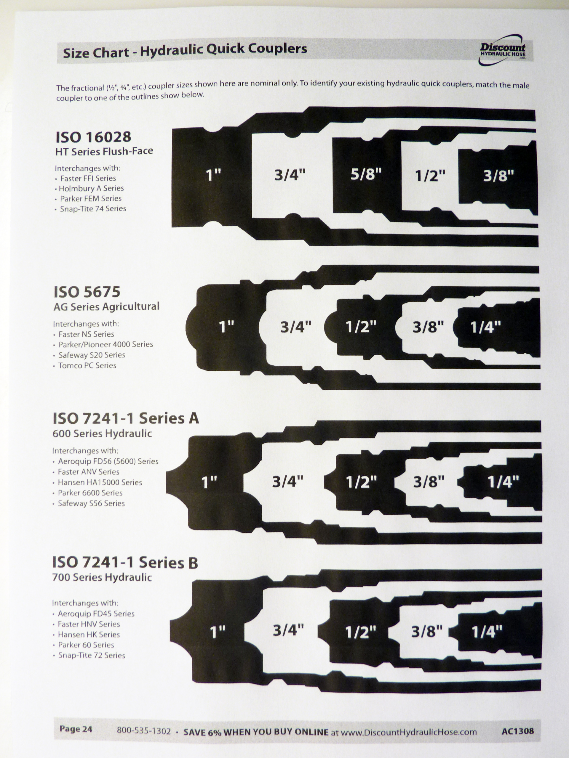

Try matching the profile of your quick disconnect connector with this handy connector type / size chart:
https://www.discounthydraulichose.com/v/vspfiles/downloadables/qd_sizechart.pdf

Thank you, I just printed that out last night and took a close look a minute ago. It looks like I've got Parker 60 1/4" connectors. I took a photo for posterity.....IMG_5122.JPG
Correction - I took one connection apart and managed to figure out the printing on it. They are Faster HNV series connectors.
