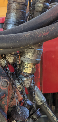

During the transmission repair, I noticed a fair amount of hydraulic fluid leakage coming from the joystick area, thinking that the O-ring hose fitting connections need to be replaced to fix leaks. Anyone replaced orings?; what size was used on YM 180D's? Details below.
Front End loader and Hyd Control
FEL – YFL 675 – 212-200-00675 - made in Canada
Joy Stick – Kontak – Made in UK
What O-oring size? and fitting size; and type for that matter. 1st pic from top; bottom pic from side view

@BC Dave Do you have any higher resolution photos? There should be a detailed part number on the coupler, between the knurled rings. It may take some brake cleaner and a rag to see the numbers.
I confess that I tend to just replace the whole coupler assembly, as seals can be hard to find sometimes.
All the best, Peter
   / Hydraulic fitting oring replacement size #3
It's an o-ring and a backing ring, which is often in good shape.
Pull the o-ring out and measure or take it to a parts store and get a bunch of them.
Get the NBR ones as those can handle oil. You can get the more expensive Viton ones but those are meant for high temps which is not the case here, so not at all necessary.

Thanks for the responses; Fittings should be repairable, O-rings I'm assuming should be an easy fix but getting the right size is the challenge, sorry thats the best pics I could find at the moment; ill have to take a close look and photograph them next time im in the Cariboo; I understand backing ring and O-ring design; and assuming backing ring would be flat; thus the comment about cutting an o ring flat with a razor? Where does the craze glue go and does it hold up to hydraulic pressure and oil? What's a double spool valve? and all this talk about Heidelberg, Russia, Royal Zenith ... etc ;)
   / Hydraulic fitting oring replacement size #7
Where you put a clean straight cut add a drop "1" of Superglue to the Flat cut area and hold it for a minute and dry. Never know you even done it with a clean cut to the size you need. Works every time! True.
   / Hydraulic fitting oring replacement size #8
A pack of 100 o-rings that size is like $4 or $5 on McMaster carr. Personally, I wouldn't bother to cut and glue o-rings this size. Bigger, much bigger, sure.
The OP just needs to pull one out, either measure it and order online or just go to parts store.
