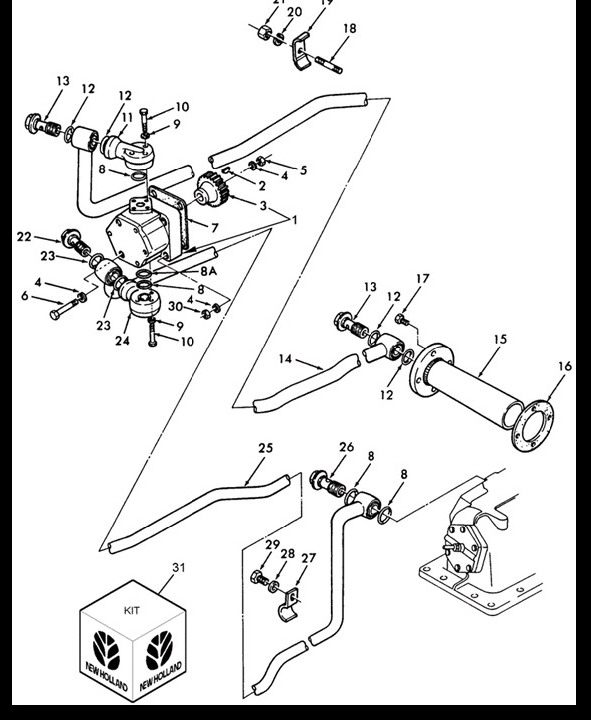

There is no spin-on filter, but you do have a filter screen (item 15) as shown in the illustration below.

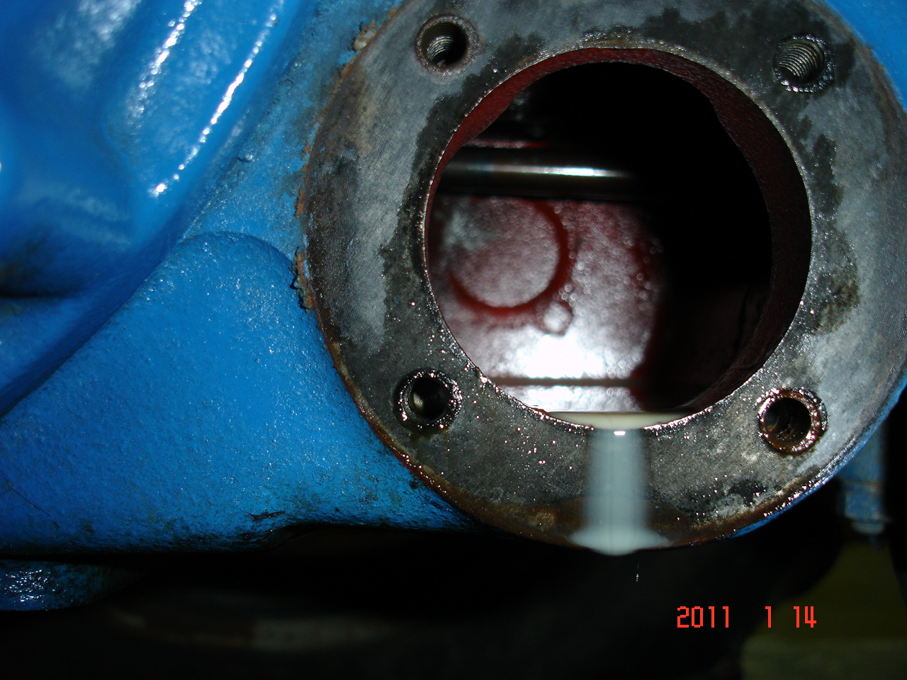

I bet ya that the screen is still there. When you take the banjo bolt off then the intake pipe comes off. The screen is attached to the round hub. You"ll need to remove 4 bolts on the filter base hub to withdraw the whole thing. Take a look at the picture below. did you take the 4 bolts off? I took the whole pipe off from the pump to the inlet. there is some play in the to free up the filter out of it's hole.
JC,
another pic of the filter, do notice the hub on the filter on the right side.you'll need to take 4 bolts that attaches the hub to the diffy housing.

JC, I took the 4 bolts off because I already had the suction line disconnected. I'm going to see if I can see inside the case to see if it's in there but my first attempt I didn't see anything in the bottom.

Piper, when you took the 4 bolts off, then did you pry the hub off. The filter media is part of the hub. It would be quite crazy for the previous owner to remove the filter/hub, and cut off the filter media and put all back together. I can't see all of that media corroded in place and not have a major hiccup for the hyd pump. I an event he actually took off the filter media then I would for sure make sure to put a new screen/hub in there before you recommission your 1700.
did you pull the hub off of the diffy?
JC,
   / Hydraulic Filter
#9
I did pull the hub off the diffy and when I removed the 4 bolts the hub fell into the bucket of oil.
I'm going to get a boroscope today and look around in the bottom of the case but from what I can see right now with a flashlight there is no screen laying in the bottom.
The oil was real milky which tells me that there was water in the hydraulic fluid. The bucket wasn't working very well when I tore the engine apart and started this project.

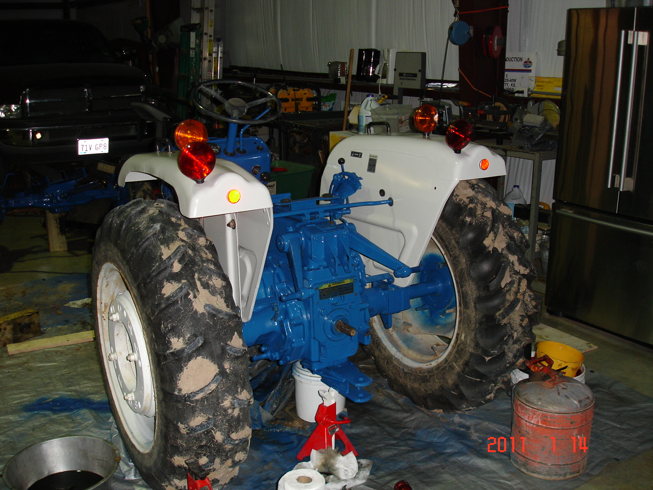

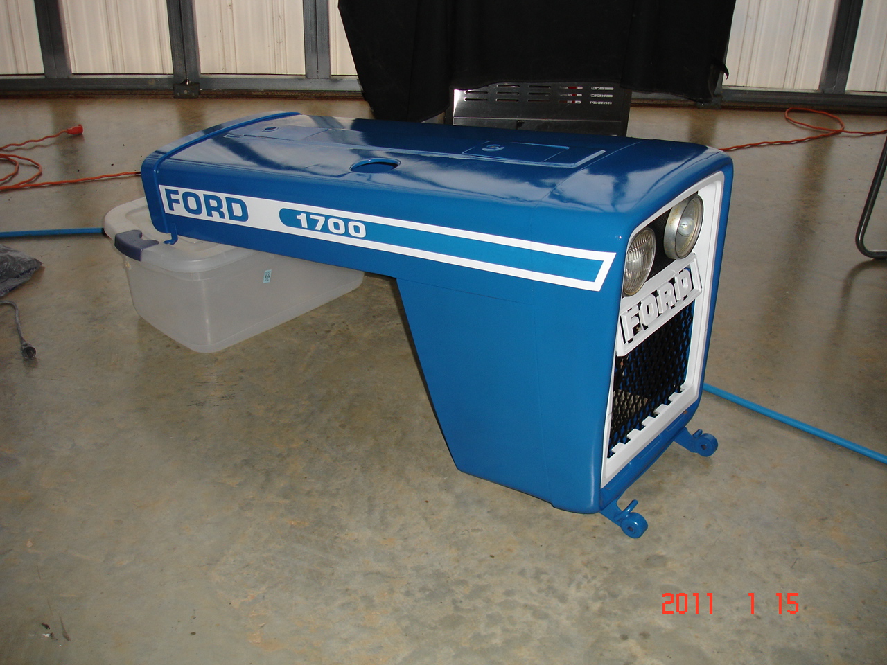

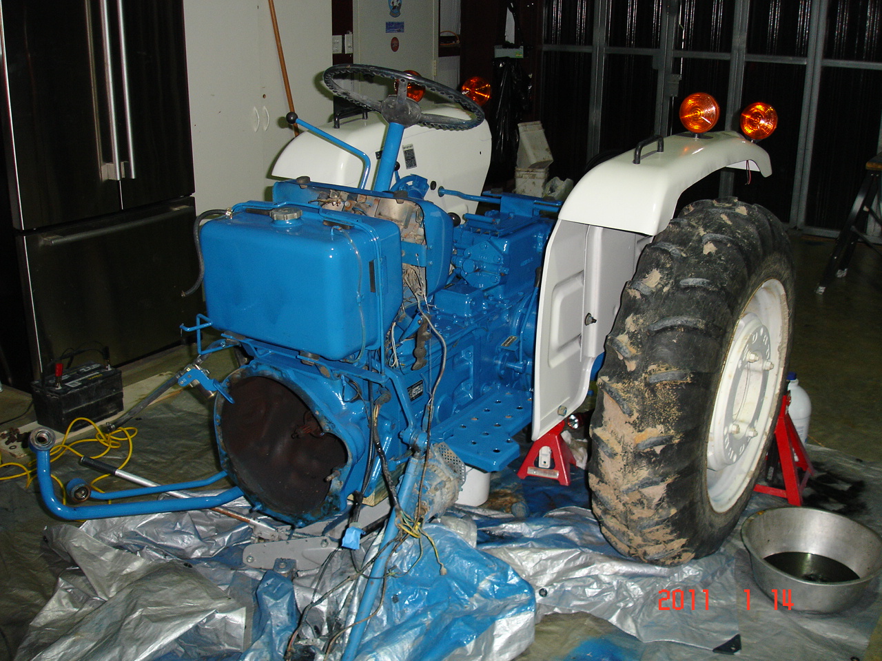

I'm taking tons of pictures and should have a pretty good library of pics when I'm done.
I've attached a few pictures of the painting and body work progress. Pretty much finished with that and can't wait till it's outside running again.
I had a pretty bad score in one of the cylinders and had a machine shop bore and line that cylinder. The rest looked really good but not sure how the scoring occured and I'm assuming that it was a long time ago, before I bought the tractor.
I also put a picture of the transmission case with the hub off. You can see where the filter was in place at some time.
