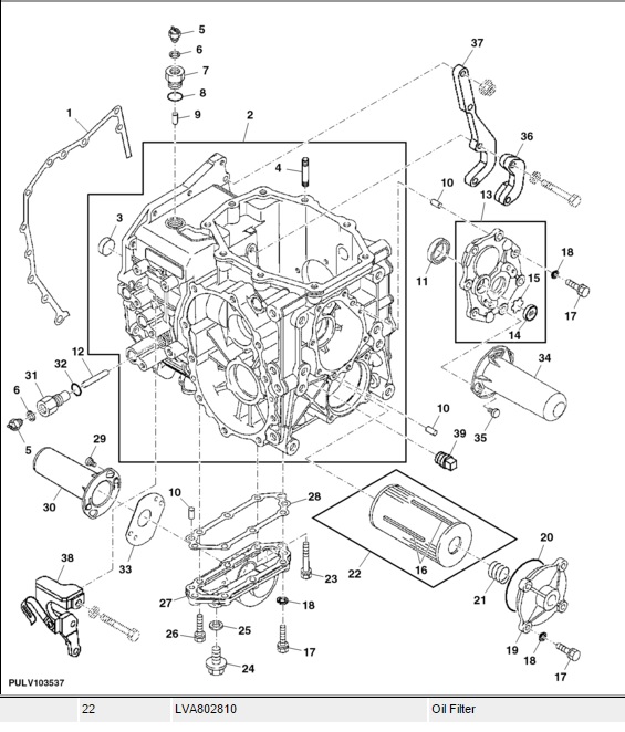

looks like the terminology could be better, but it appears to me that the "filter" in the transmission is a screen that you would clean/inspect not replace unless damaged for some reason. But otherwise they appear to have the same hour intervals.
   / Hydraulic filter replacement (JD 2025R)
No, if you look at the first link (pdf file) there are illustrations of each and part numbers and they are both spin-on type filters. There is also a screen on the transmission filter, but both are "proper" filters.

Welcome PID. I just did 50 hour service on my 2025R and yes same fluid filtered in two different places. The filter in the trans is a screen type and you can clean and reinstall the other is a spin on filter. I bought the kit that has all the filters in it so all mine got changed. Just be careful when you fill the trans. The book says 3.5 gal but mine didn't take that much. I over filled it and had to suck some back out. I really wish the 2025R had a dipstick for the trans instead of that **** sight glass! Also good luck when you grease the shaft between engine and trans. It took some time I had to do some research to figure out how to get to it! You have to take the dash and an access cover off of the right side to get in there (none of that info is in the manual). Now that I know how it will probably only take half as much time. Good luck!

PlayinDirt
To help better understand the transmission filter, as it is a cartridge (not a spin-on), showing the jdparts.com schematic item #22 and how it is capped off and removed from the rear. Hope this helps...
