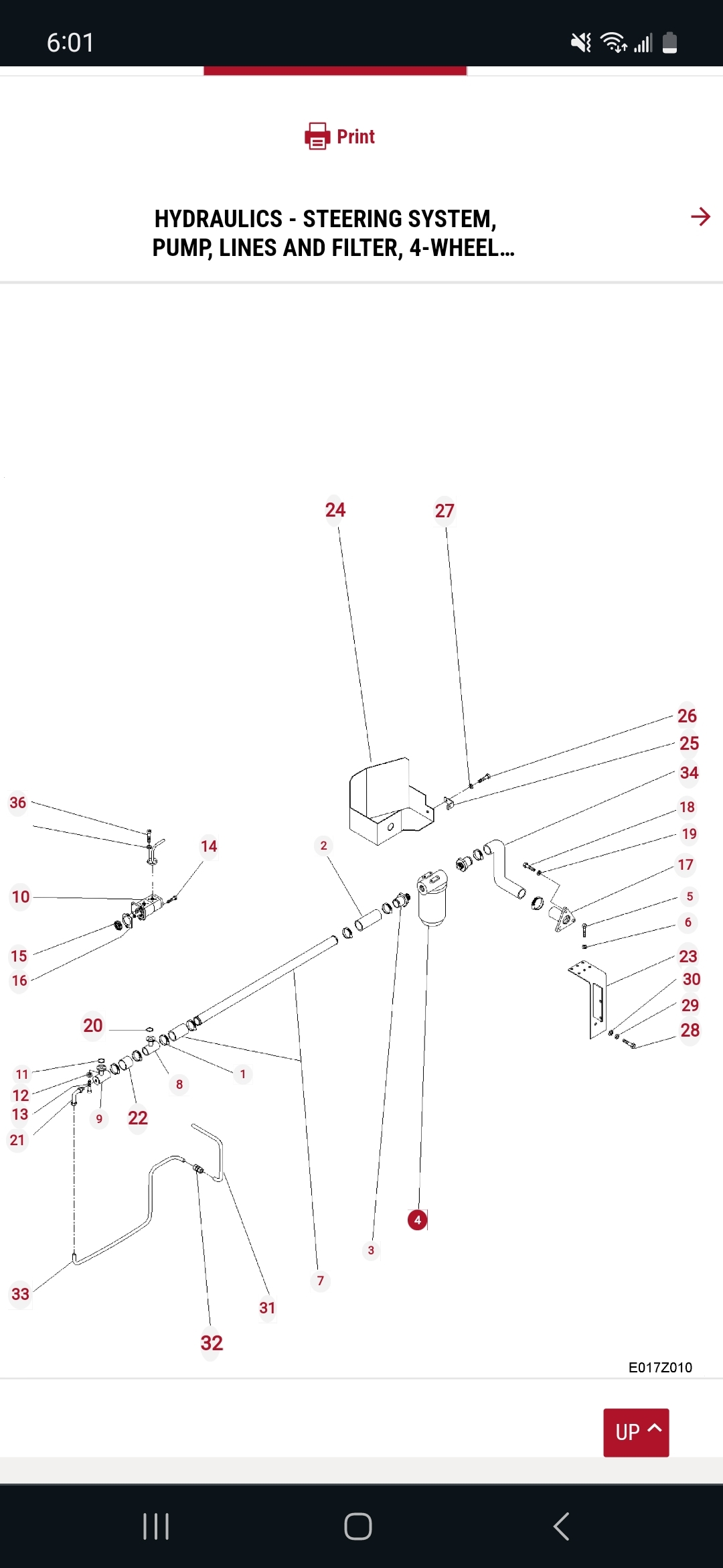

Dec 10, 2023 / Hydraulic filter location and part number #2 T TractorTech Elite Member Joined Jan 26, 2012 Messages 2,793 Location California Tractor Ford 7710, Ford 550, Ford 1910, Ford 4430, KD Forklift, Ford LGT17H, New Holland L255 Skidsteer The hydraulic filter should be located on the right side of the engine. Filter number is 034391T1. Baldwin version is: Baldwin® Hydraulic Filter fits Massey Ferguson 271 471 481 491 492 034391T1 fits Fram P3760 fits Fleetguard HF6136 fits Baldwin BT388 Baldwin® Hydraulic Filter for Massey Ferguson Backhoe Loader(s) 650, 660, Tractor(s) 271, 271XE, 281X, 281XE, 471, 481, 491, 492. Replaces Baldwin Mfg Number(s) BT388, Replaces Donaldson Mfg Number(s) P550252, Replaces Fleetguard Mfg Number(s) HF6136. www.tractorpartsasap.com Attachments Screenshot_20231210_180112_Chrome.jpg 307.3 KB · Views: 154
