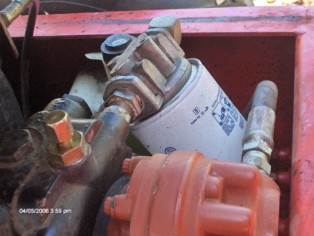

Here is a picture of my filter, but I don't know if it is original.

Yes the OEM filter housing had a port for a gage
Did you purchase your PT new from PT, and as far as you know, Pt installed that filter housing?
I guess you could install a tee and a port for a vacuum gage. I can't remember the in of mercury that cavitation starts, And that isn't the problem, It is the effect of the collapsing or bursting of the bubbles that will cause erosion, even on some of the hardest metals. That makes me curious about those aluminum body on some hyd pumps.

Did you have to drill your filter assembly out to install this? Mine doesn't have a gauge port.
Thanks for sharing this.
All the best,
Peter
No drilling required. There was a threaded plug in the port and installation only required removing the plug and screwing the gage into the port.
