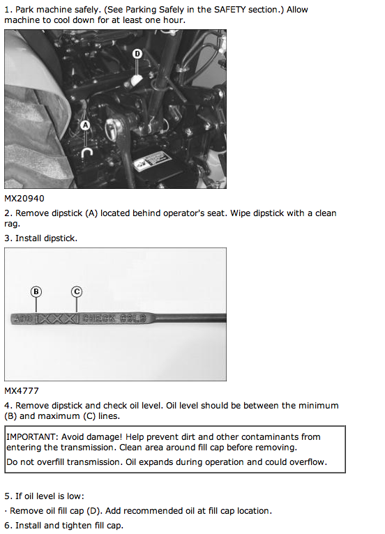

Hello,
I have a JD 3320 with the back hoe attachment. I blew a hose yesterday, I am going to get the new hose made now. Not sure where to check and or fill hydraulic fluid.
Need to know:
WHere to check
Is there a stick or is it fill to spill like oil in a generator
Can I use any hydraulic fluid or do I need something special??
Thanks in advance!!!!!
   / Hydraulic fill JD 3320?? HELP :) #2
Bigdoggie said:
Need to know:
WHere to check
Read your owners manual....Great pics & documentation.
You can use whatever you want, but JD (and I agree) suggests HyGard Lo-Viscosity.
   / Hydraulic fill JD 3320?? HELP :) #3
In case you don't have an owners manual..........
Thanks, Owners manual MIA.....big floods out here in RI so we are in a bit of a shamble, thanks for the info.
