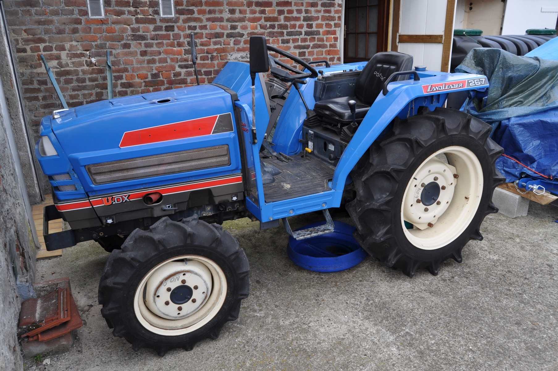

I am down hydraulic with my iseki ta267 version japan
I search the catalog parts in Japanese version because the hydraulic hoses are special
I have the controls with buttons and lights as the picture
i also have a tu155 and tu225
thank you for your help Michel
ps I am french, excuse me for my english mistakes
I can not attach photos

I am looking for the hydraulic supply ducts of the pump to the sub-box under specific case ta267 version japan with lateral controls to box
I do not have any descent of back arms
attached photo
thank you in advance
   / hydraulic failure Iseki TA 267
I have no more descent 3 points
I am looking for hydraulic shemas of ta267f japan because it is different from the europe version with mechanical controls
mine has the control box in lateral

Hi Miko, did you recently purchase the tractor? If so have you tried adjusting the settings? It may be that the current settings have the 3 point arms locked in the upright position.
I have a TA357 that came with the same electric over hydraulic control setup. I was having similar issues with mine and ultimately decided to remove the control box and replace it with a simple toggle switch. It works good except it doesn't buffer or slow down the arms when they descend-not a big issue in most cases but if I'm lifting something heavy the arms drop more quickly than I would like.

I have the same box on my TA247. I wish I knew what all it does. I know it sets draft, How far up and how far down the 3 pt goes as well as how fast. Unfortunatly it locks up a LOT and wont go back down and the sometimes suddenly it just goes down. I tried the relief valve under the seat but it doesn't help.
